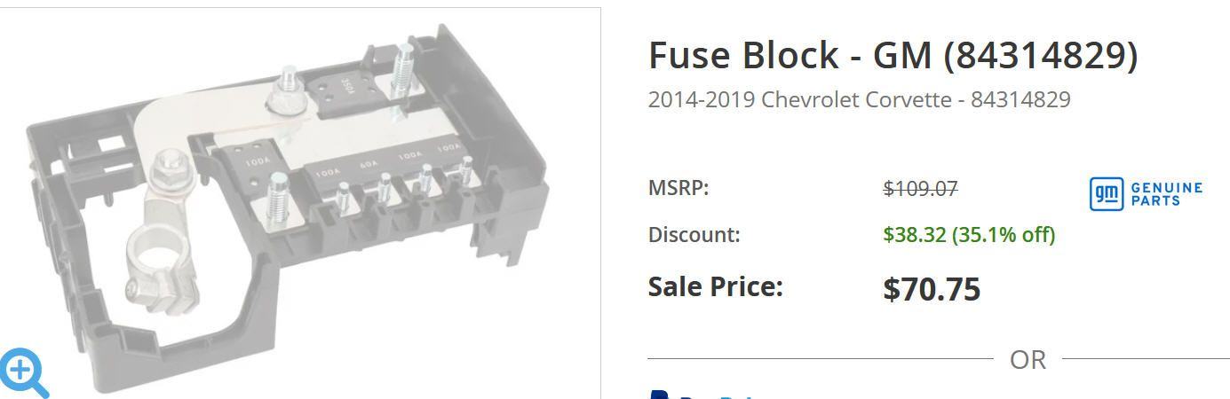

Since you don't trust the bus / fuse block on top of the battery - why not replace it just to ease your mind?
