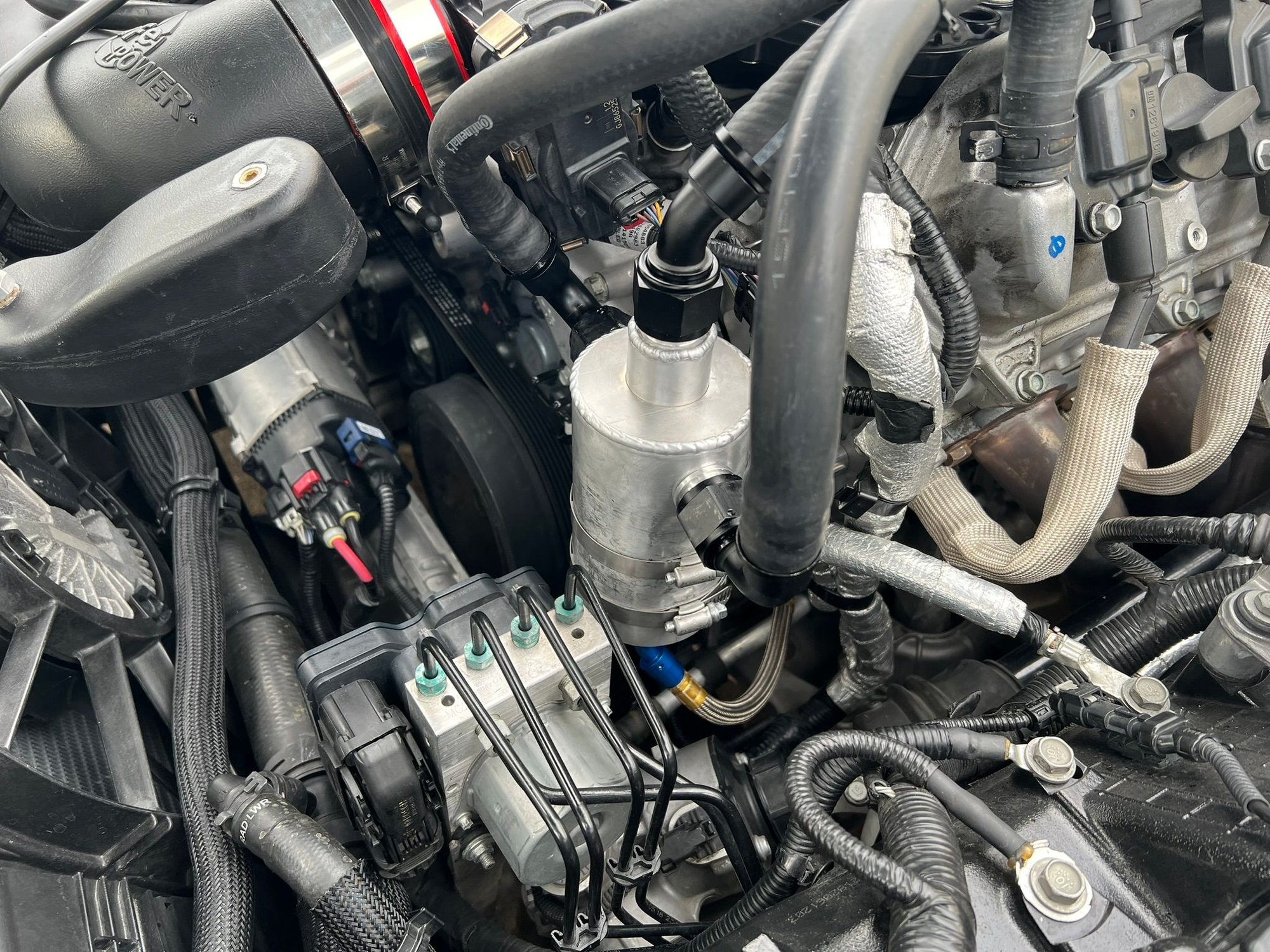

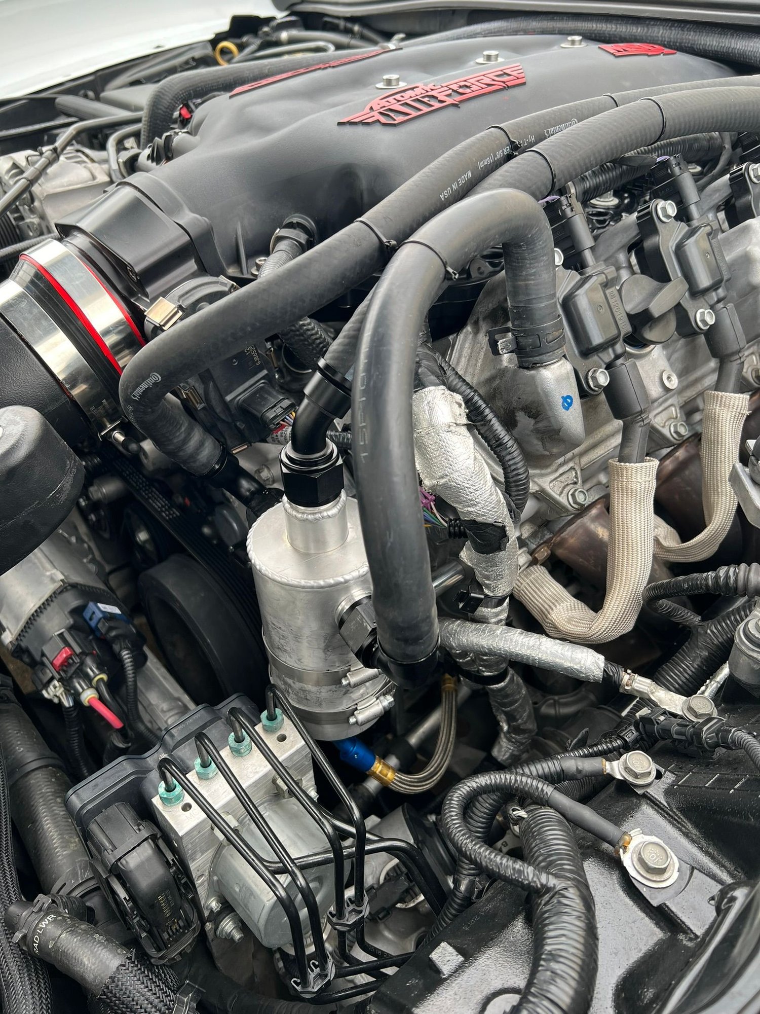

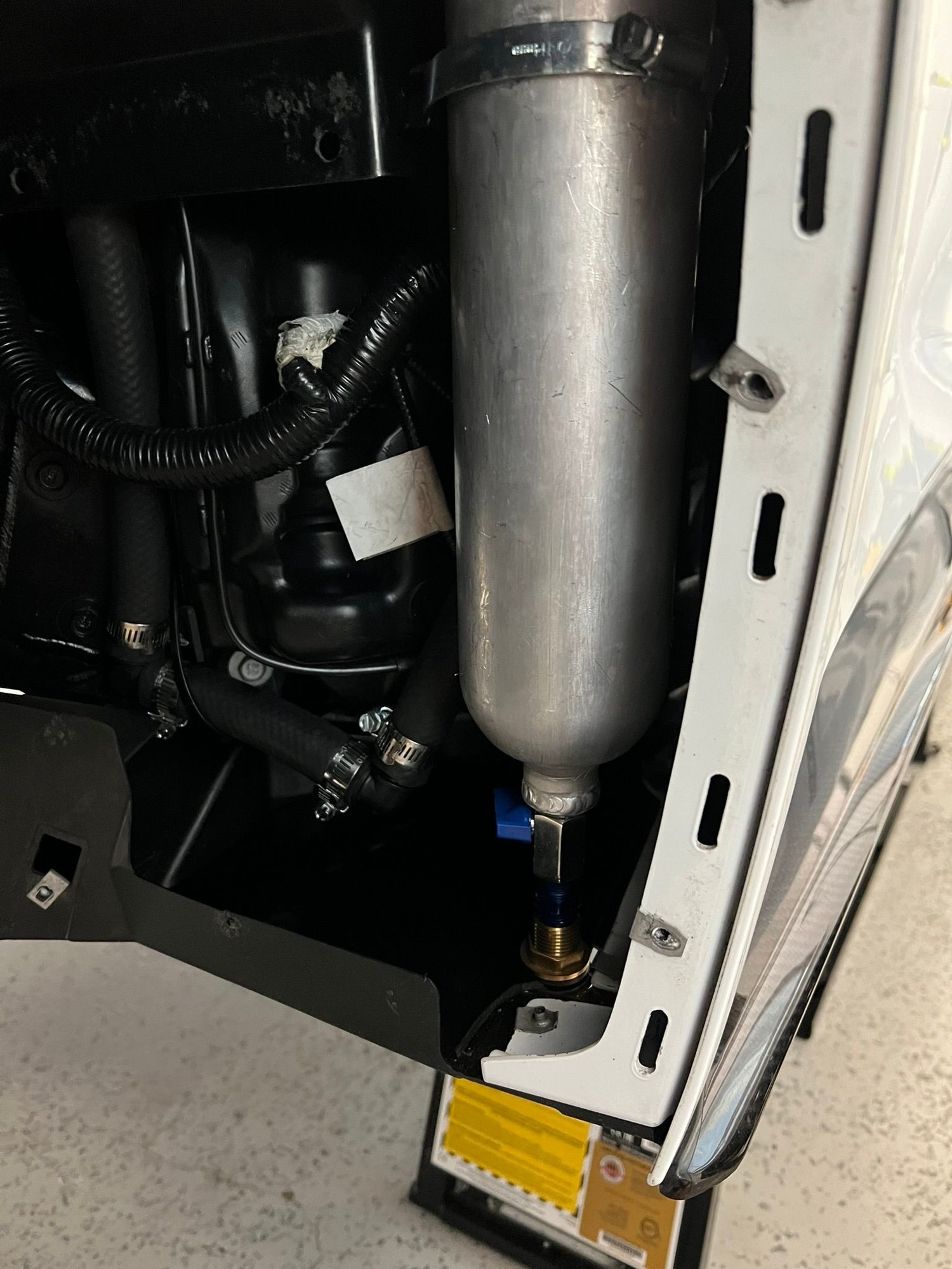

The catch can system has a primary can with a drain line and then a line to a secondary can to capture anything that doesn't drain to the engine. After a 20-25 minute track session, I'm draining 500+ml from the secondary can. That means there's a whole lot more draining back into the engine. Waaaaaaaaay too much. Pretty sure this is a piston ring issue. I just want to verify it before I yank the engine.
In the pic below you can see the primary can and the stainless steel braided drain-back line below it running to the engine
The secondary catch can is behind the driver's side front tire and it has a vent line that runs to the rear bumper just in case it needs to spit anything out
