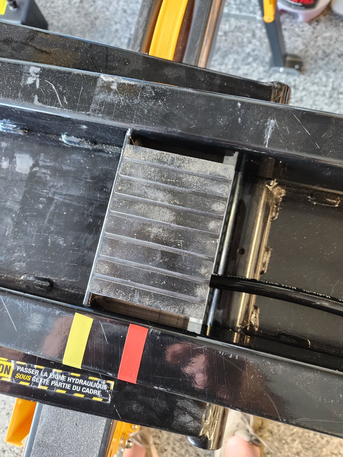

I’m trying to choose between a Quickjack 7000TL vs a 7000TLX. The TLX will work with all my other vehicles, except the Vette. The minimum spread on the lift points of a TLX is 43” and the puck spacing on a C7 is 39”. Has anyone figured out how to “work around” that? My only other option would be to buy a TL to use on the Vette, then have to spend more to get the extensions for my other vehicles.

I added a piece of 1/4" × 3" flat bar to each of mine. I put one rubber block on the flat bar and have enough adjustment in the others normal location.

I thought about that but wonder about having enough support. Mind sending along a pic sometime?

I don't weld, so I used 3/8" bolts; drilled and tapped the Quickjack rails. Just enough clearance for the hydraulic hose.
