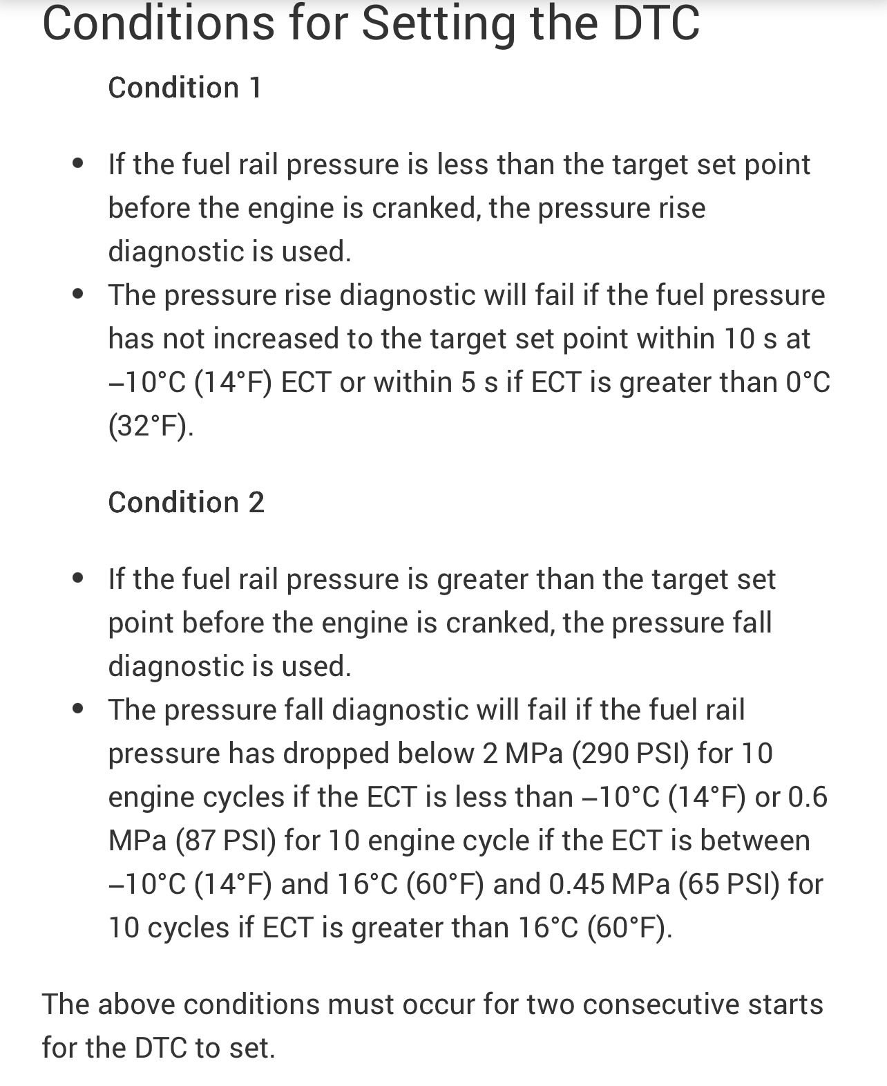

Below is the code setting criteria for the P00C6…P229 is not the correct DTC as it is 4 digits.

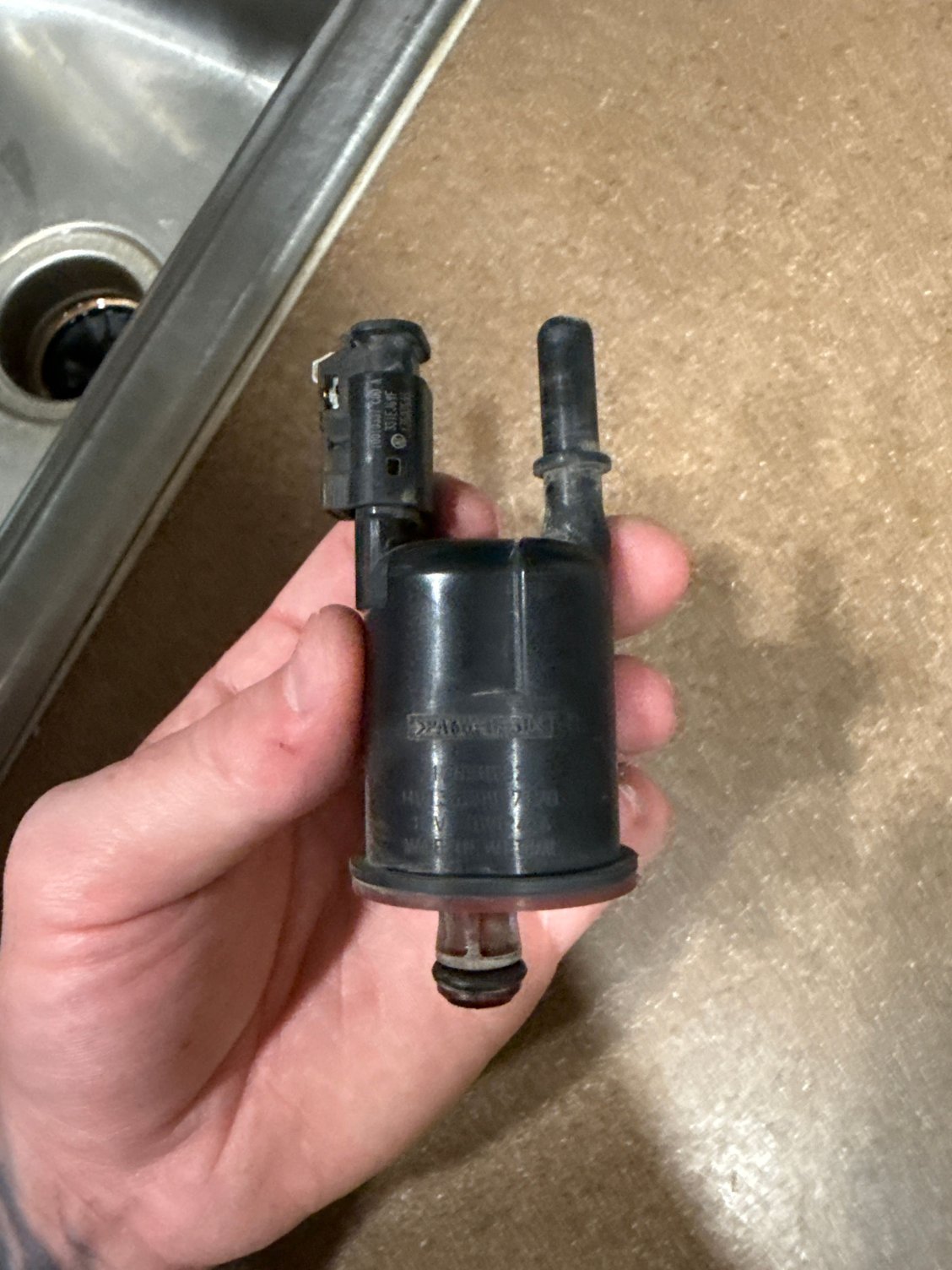

Was it this one that you replaced ? See attached.
Old Jun 30, 2025 | 06:21 AM
Miker6's Avatar
Miker6
Joined: Jan 2008
Posts: 129
From: Utica NY
No, map sensor was on drivers side of intake near the fuel line connection.

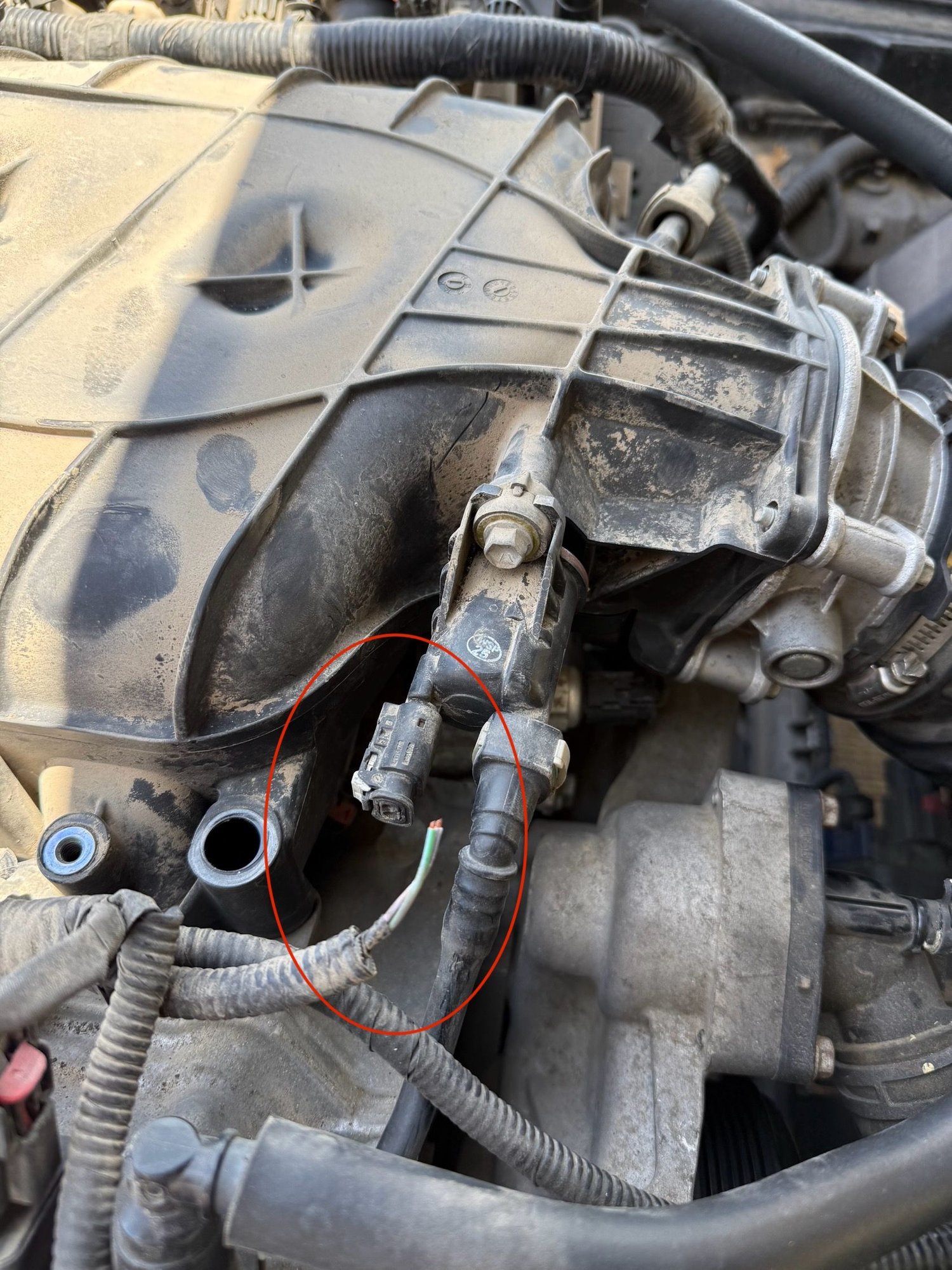

Dang, wash that engine and repair that broken wire!
Just kidding, I know you already did.
Mannn ! Idk what the previous owner did to manage to get dirt EVERYWHERE. And I mean, everywhere !! But yes its done 😁
