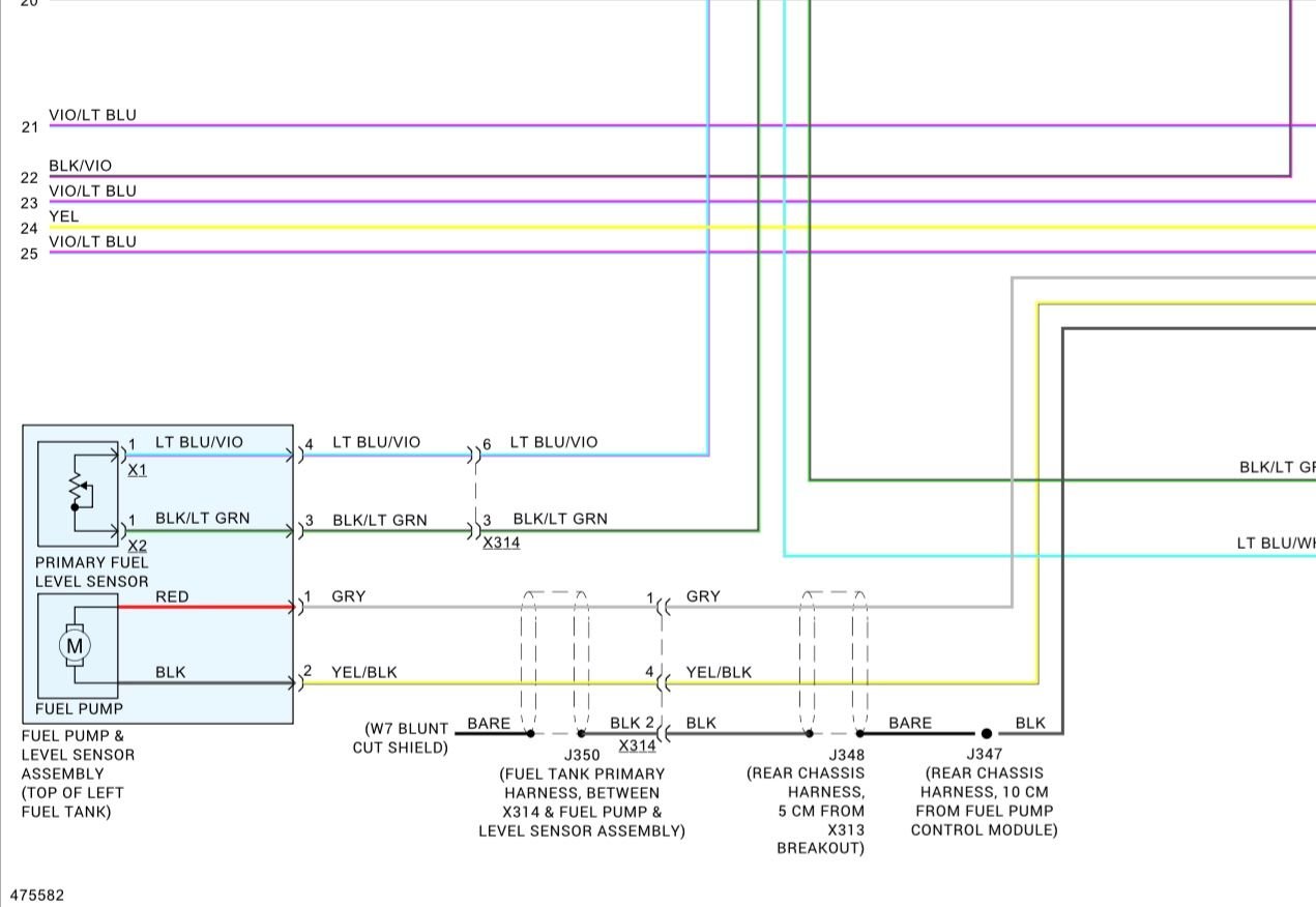

If you have spark it rules out a crank sensor so I’d be looking at the fuel pump circuit…with heat comes resistance so you should be checking the circuit using voltage drop if you know how to do that.

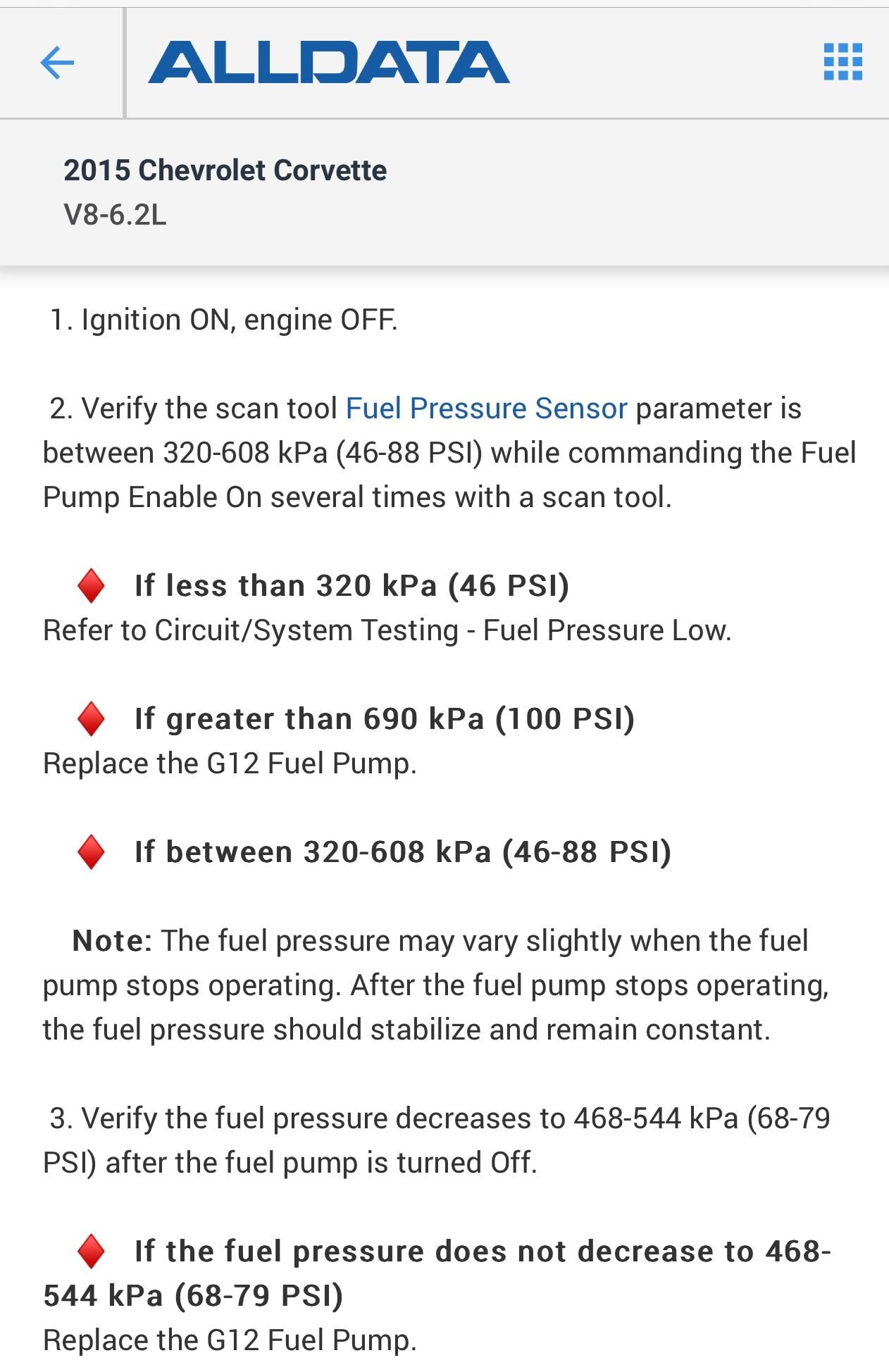

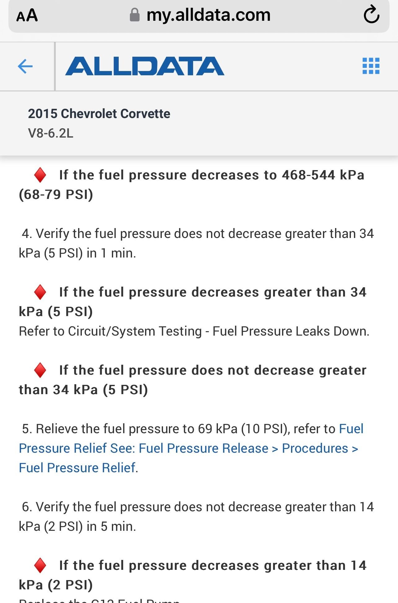

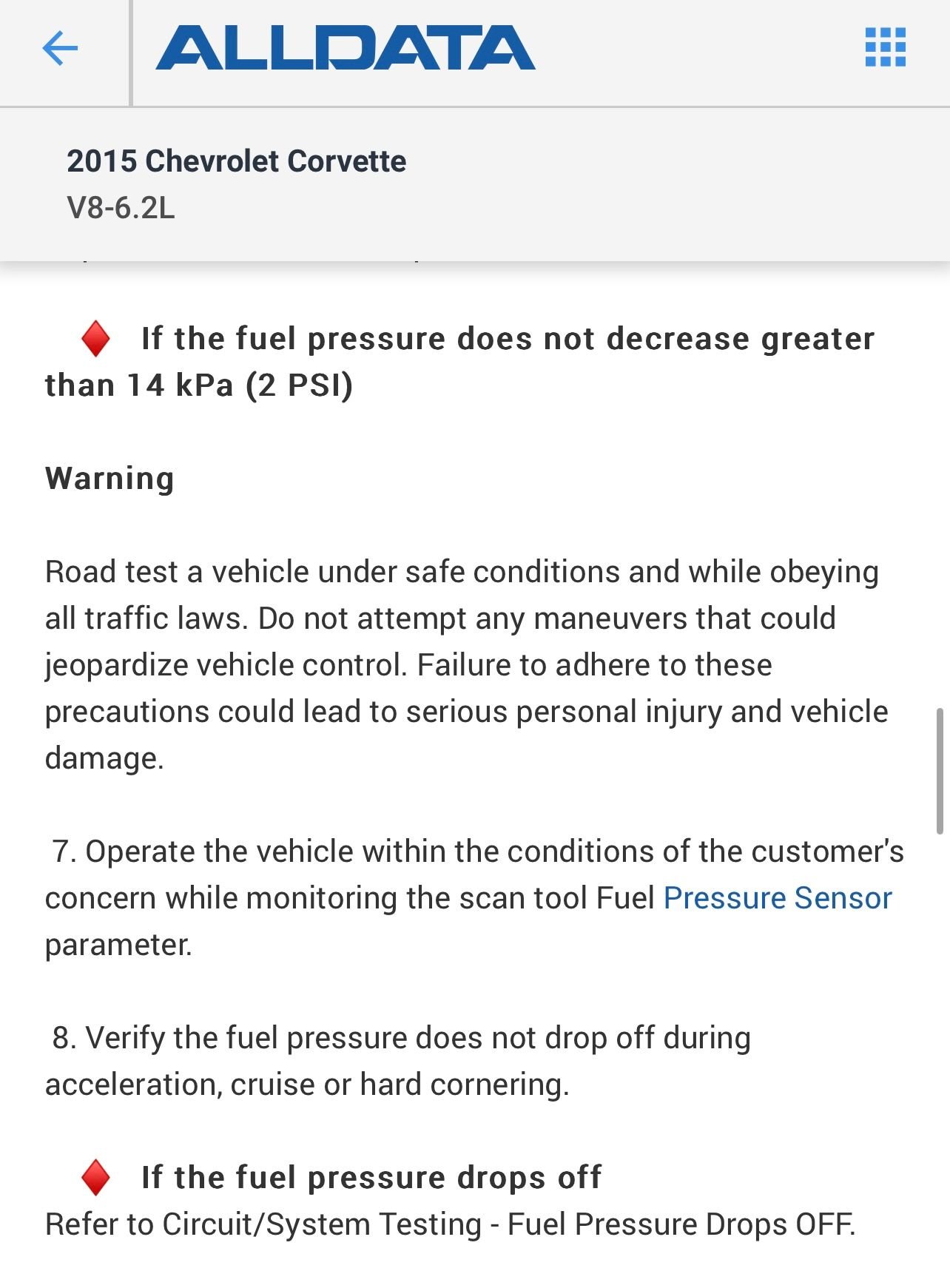

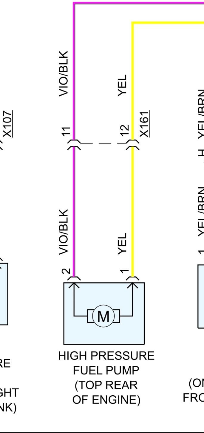

From Service Info !!…with Ignition ON Engine OFF..I don’t know if HP Tuners has bidirectional capability to turn on the fuel pump.

C5 Diag's Avatar
C5 Diag
Moderator, Tech Contributor
Posts: 15,595
Likes: 4,055
From: Cape Coral, Florida

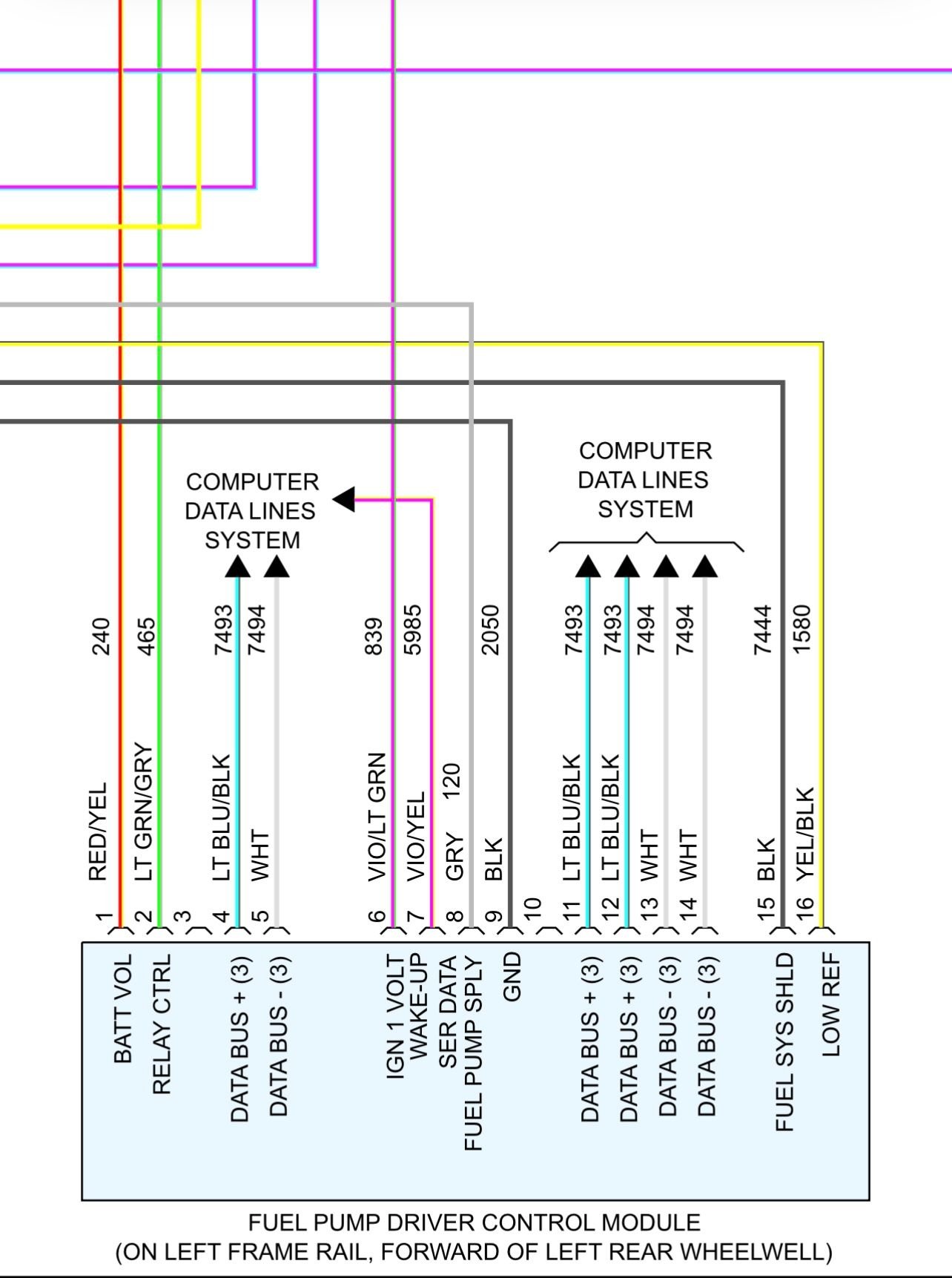

Old Jul 14, 2024 | 10:28 AM
C5 Diag's Avatar
C5 Diag
Posts: 15,595
Likes: 4,055
To accurately diagnose this a lab scope is needed to check the PWM signal from the module…I use one on many diagnostics but unfortunately dealerships and almost all general repair shops DON’T so they will only guess if you take the car to one of those !!…it can be a bad module, a bad low pressure fuel pump, or a bad high pressure fuel pump..the wiring will also have to be checked for excessive voltage drop due to possible bad connections…now it can be a bad crank sensor if it’s not starting..just look at the Tach while it’s cranking..,no tach movement is most likely a crank sensor…crank sensor fires the spark and injectors.

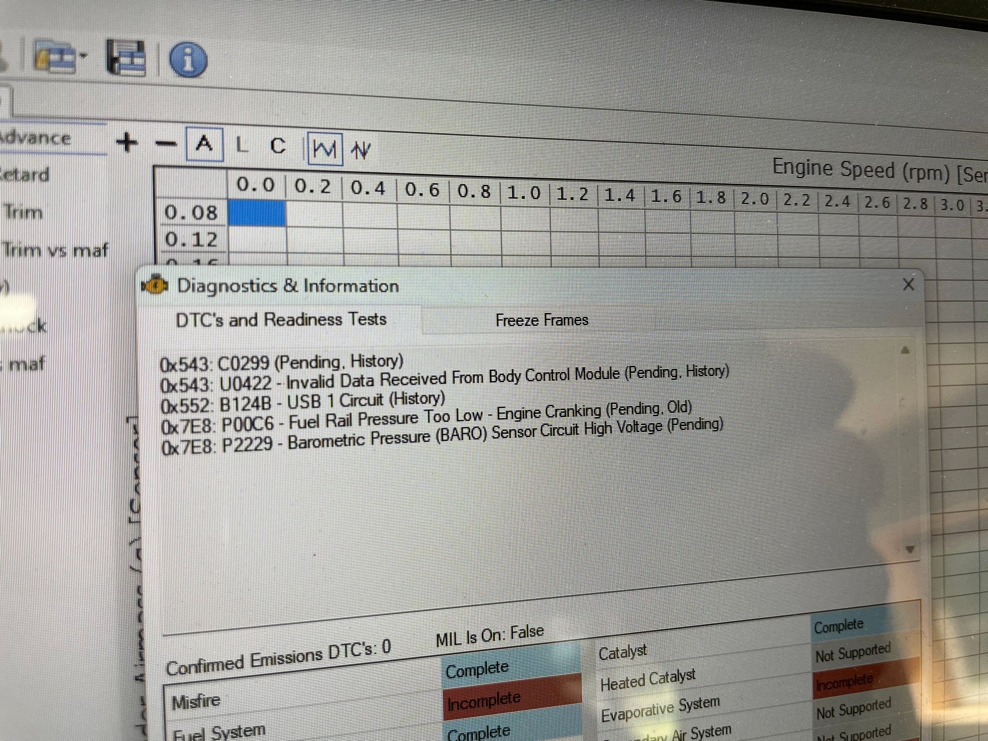

Codes from today

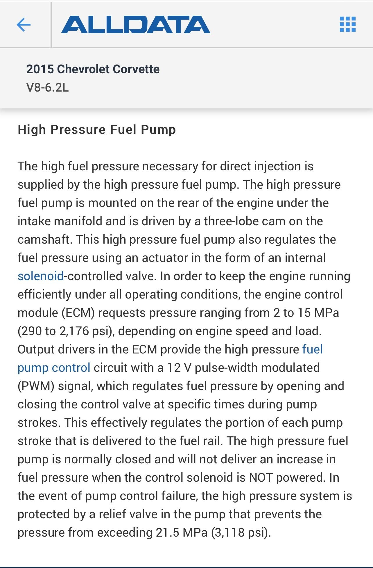

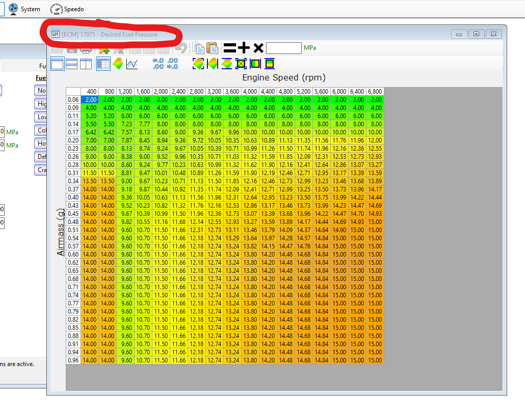

After re-reading your posts. 200psi on the high side is quite low.
At 400rpm....so basically cranking rpm....the PCM is commanding 290psi at 0.6g of air. For a stock LT1, the below table is what the commanded fuel pressure looks like. The fuel pressure values are in MPa, so multiply by ~145 to get to "psi"
Also....there's a fuel pump check valve in the line that's on the driver's side and goes under the intake to the HPFP. Could be the check valve is bad and sticking or clogging when it heats up since the feed is from the low side *to* the high side. Many people run without the check valve if you do a forum search. I think it's there to prevent fuel line hammer but that's just my speculation. Anyway....might be worth pulling the intake and the line to take a peek.

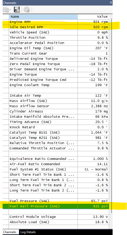

Lastly.....I found one of my logs from last year where I was looking at fuel pressure (among other things). While not at startup, you can see at hot idle where it is as a point of comparison if you log a similar condition...
