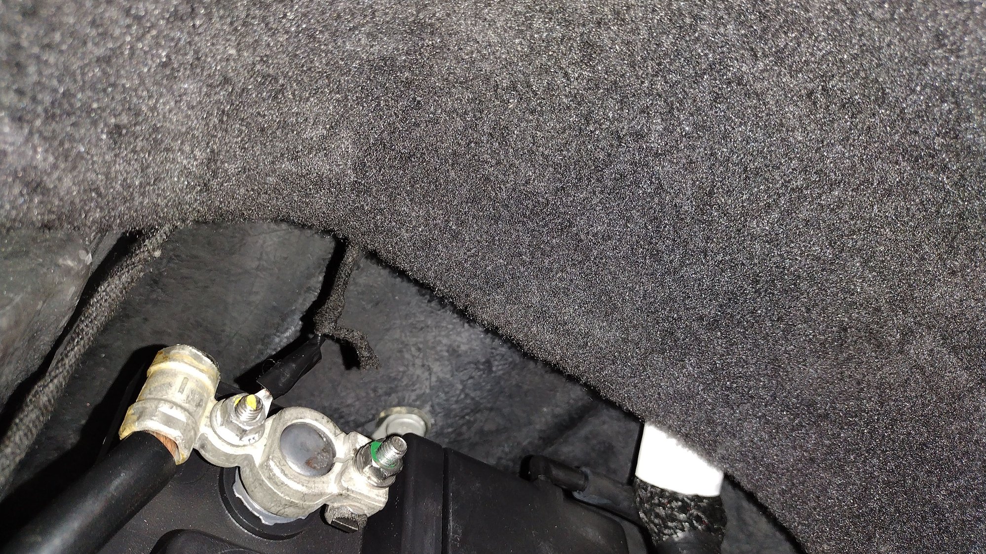

Am I the only dummy that broke the little wire on the negative lead to the battery? I know it looks ugly, but I got it recrimped without adding a wire. I noticed that the original was not soldered so I didn't do that. The tape was just in case. It is actually crimped pretty good after the third attempt. Can a new wire be sourced? Is it a pain to change? Any reasonable alternatives? Asking just in case. I should have removed from the terminal prior like last time. It was out of the way but I slipped installing the new battery.

Lots of us have managed to break the too short sensing wire. It is important for proper battery charging.
There's nothing special about the wire. Just splice in a section of black wire about 14 or 16 gauge. Solder for the best electrical connection, then use heat shrink insulation or tape over the joints.

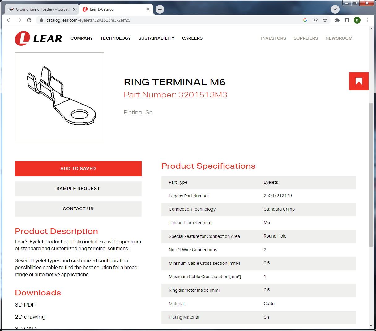

the real question is:
has anyone found a correct connector crimp lug of the correct decisions, ie: wire size, bolt hole opening etc.
Not some germeric part that kinda fits.
if so, where?
Old Jul 23, 2024 | 01:54 PM
laserdude2215's Avatar
laserdude2215
Joined: Nov 2016
Posts: 1,192
Likes: 438
From: San Dimas CA
As you command, so shall it be!

Never thought about it like that. Good point.
Old Jul 29, 2024 | 09:14 AM
Tinkertech's Avatar
Tinkertech
Joined: Feb 2018
Posts: 2,199
Likes: 1,057
From: North Texas
Thanks!
