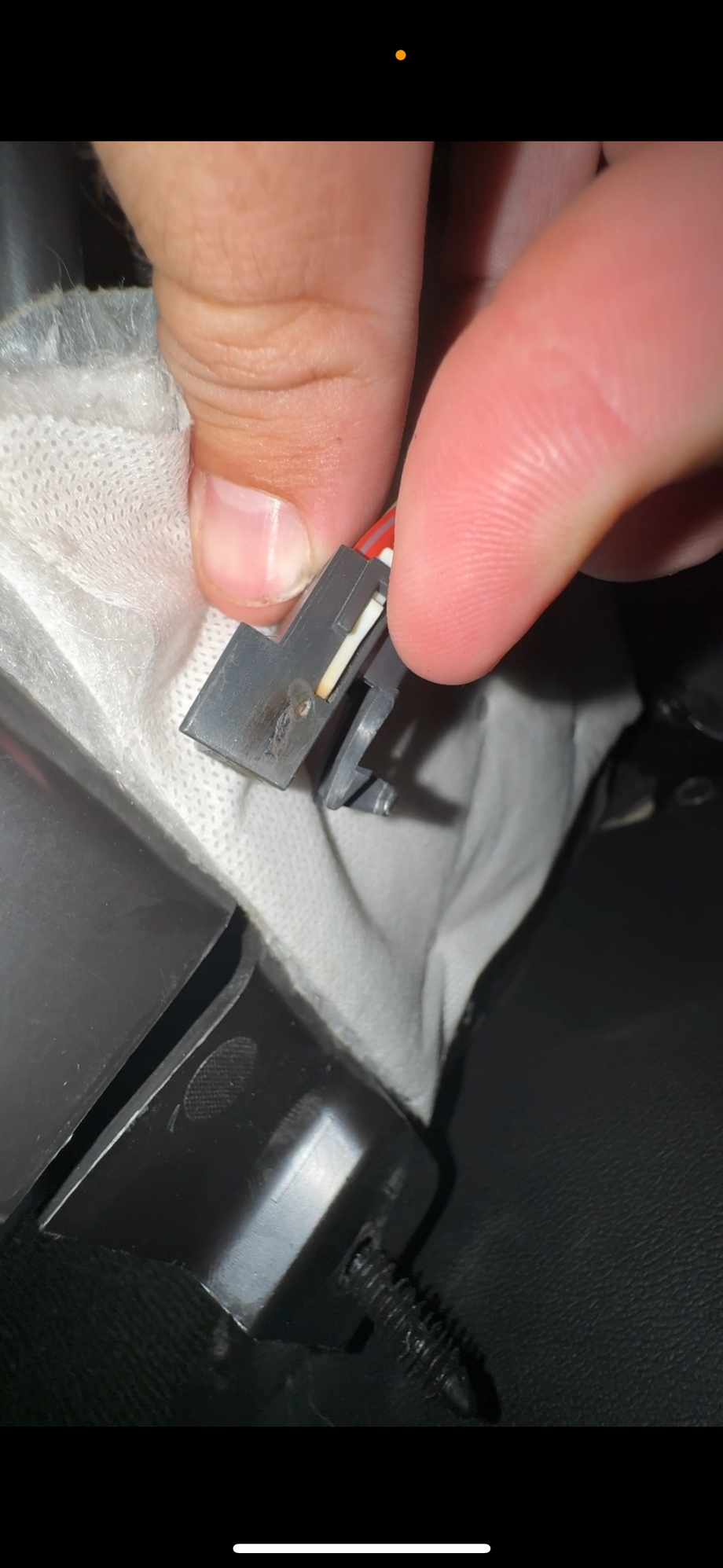

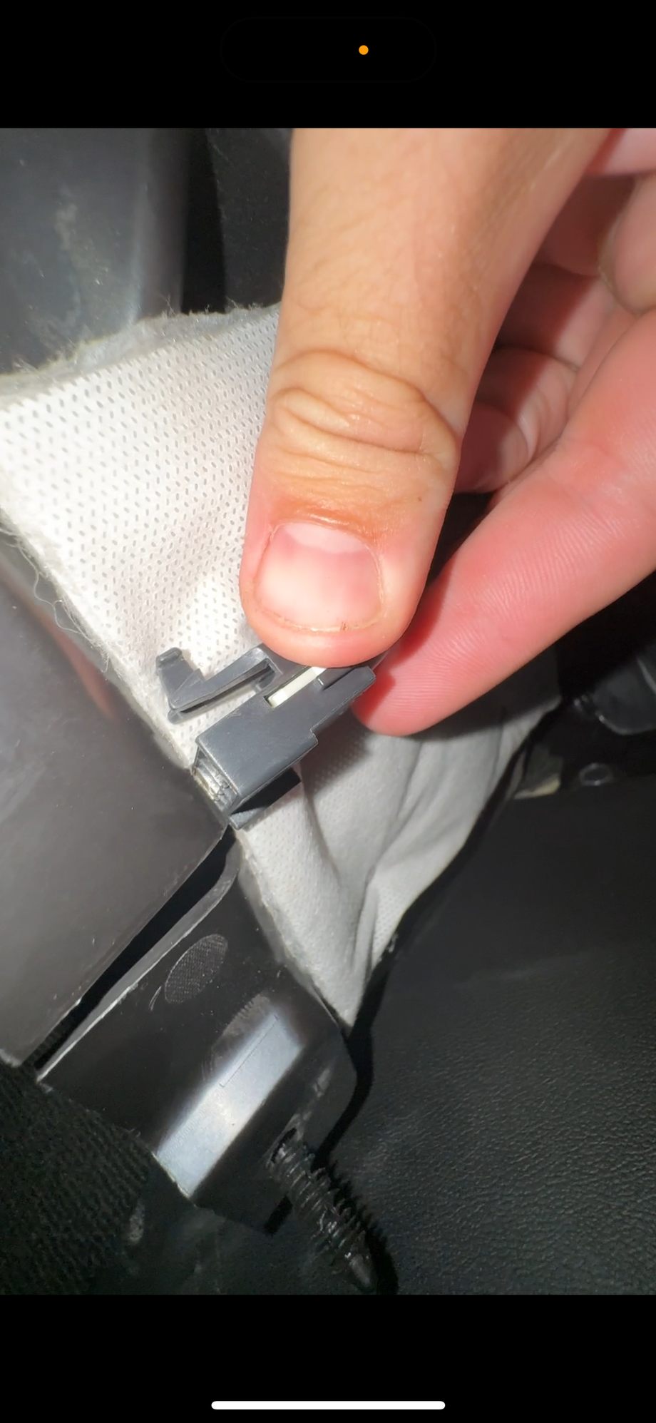

So I read forums and everything. Unplugged the blower motor. Replaced the blower motor. Whenever I play with the cable or tap/hit the plastic cover with my foot or object it turns on. I can’t tell if it’s short. Could the plug in be messed up? How should I fix it? If anyone had another solution besides unplugging and replacing please let me know.

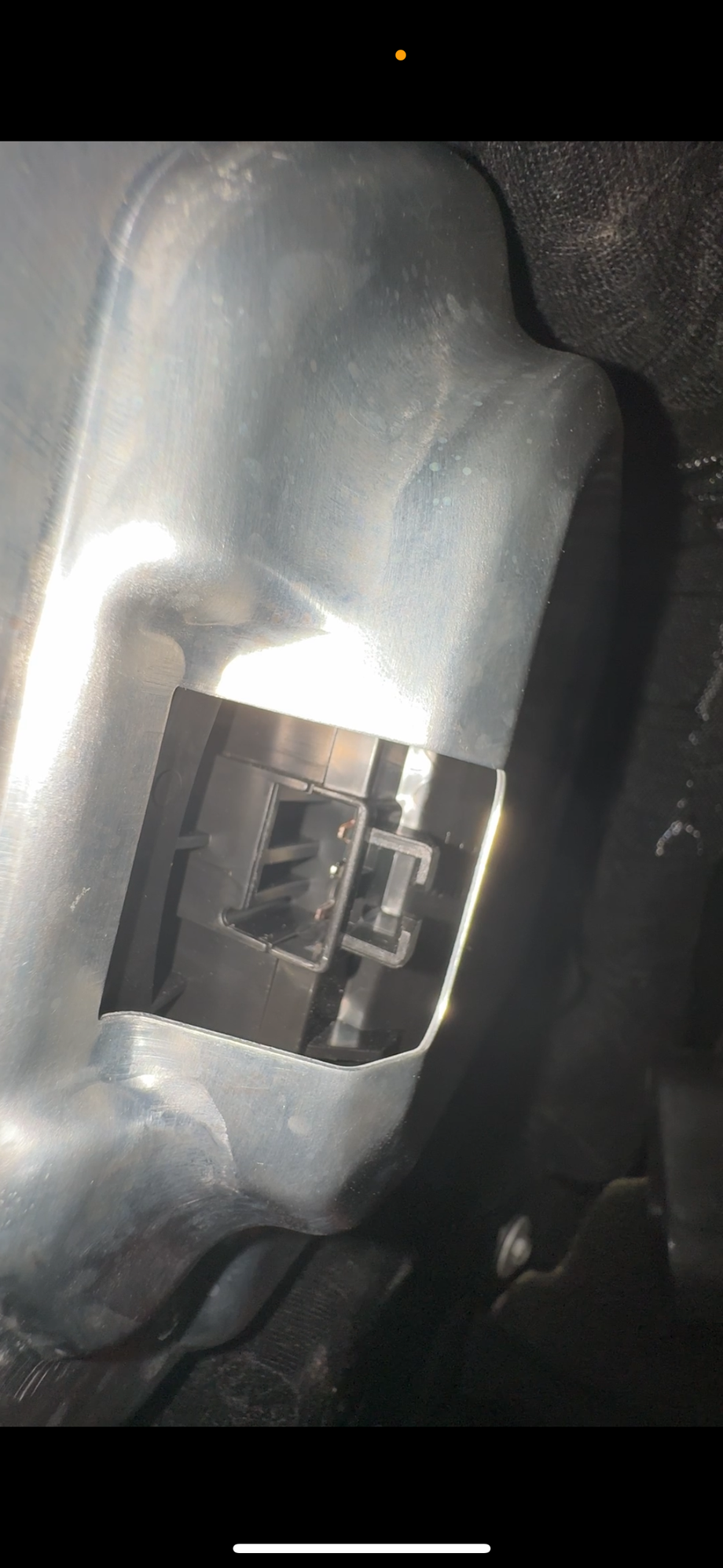

You need to inspect the plug itself. It may be burnt or damaged, repair as necessary.

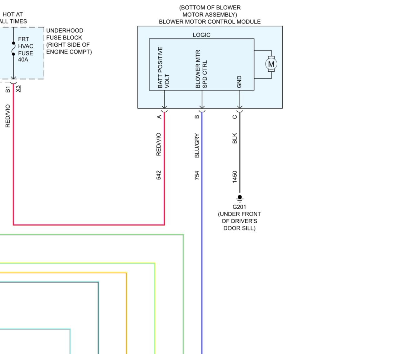

Is the replacement blower motor module OEM or aftermarket ??...there are just 3 wires...power, ground, and a speed control (PWM) wire...if wiring looks good it may be a bad "NEW" module....moving this to Tech.

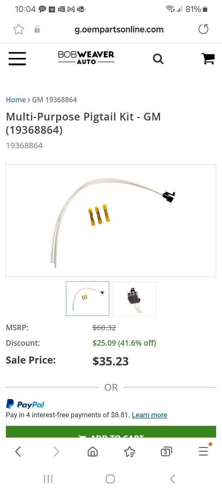

Tsb for replacing the connector. GM sells a pigtail with new crimp connectors
PM me and I will take a picture of the bag with a part number and send it to you

The part number is GM 19368864

My apologies for no answer I’m doing some military work. I have photos of the connector and the fan itself. We’ve decided to do the pig tail! It comes in this week. I’ll post progress and what to do. The connector definitely had play so that’s why we decided to go through this route. Can is cammed and lowered so we think the vibration could’ve caused some damage or just fell into the same problem as everyone else.
