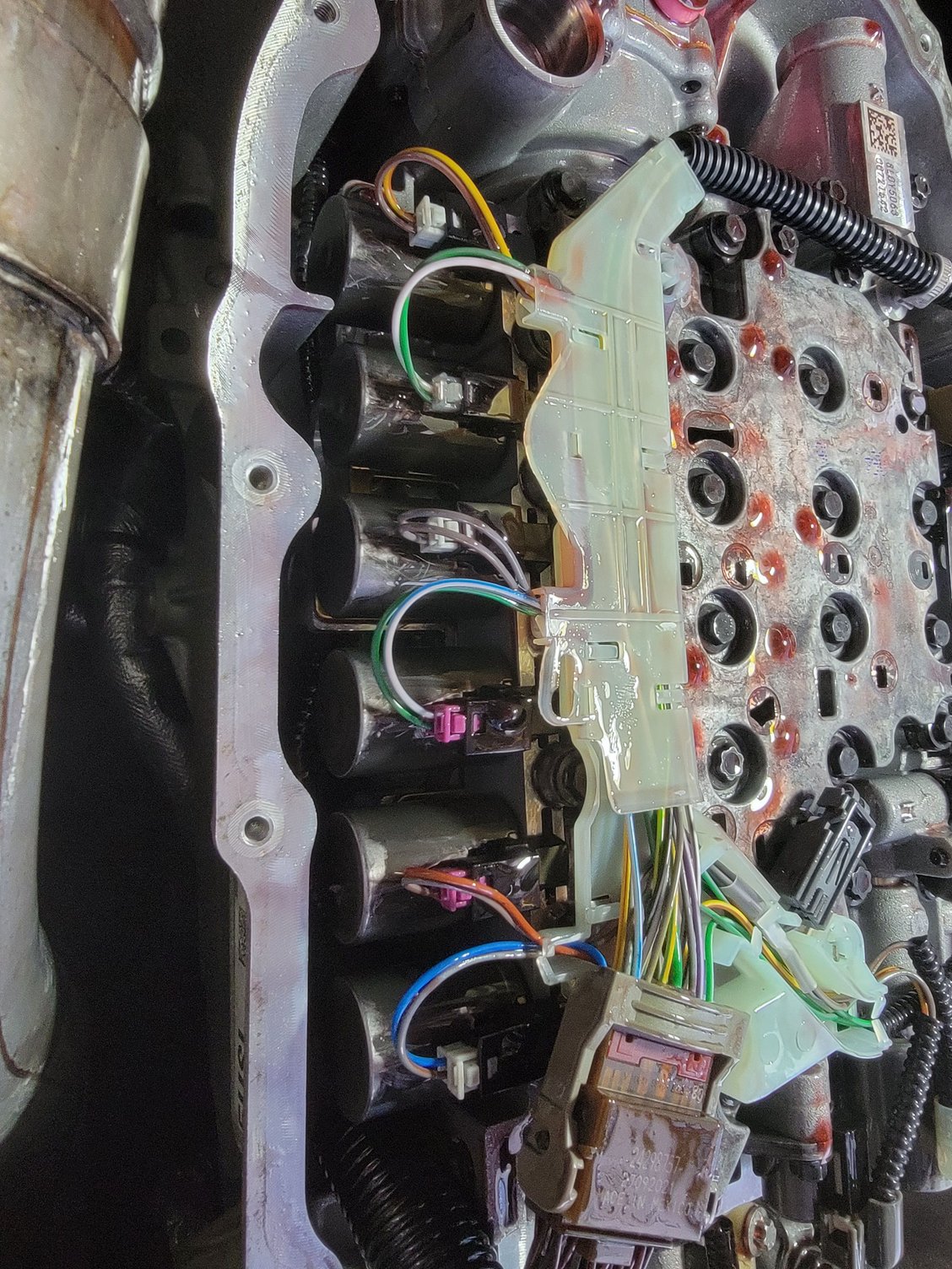

I am the guy , PM me with the part numbers you are questioning . The TSB called for two harnesses to be replaced the upper and the lower but the short circuit is in the lower .....

Sep 14, 2024 | 08:13 AM
Quote: Awesome, good to know. I wonder why it was telling me I needed the additional part. Was it difficult? I've had some people say you need to loosen the transmission bolts and jack it up and others say they were able to reach all the bolts to drop the transmission pan. And did it fix your issue?
1- Not hard to do if you are mechanically inclined and have the normal assortment of hand tools
2- the short in the wiring is in the valve body harness , no need to replace the upper harness ( u have to drop the valve body to replace that one )
3- I did not jack the transmission, you can get the last four bolts out without jacking
4- Yes it fixes the issue
5- look closely at my picture above that shows the color codes of each connector and what selonoid they plug into , especially the green / white pairs the reason is when you open your trans up , you will see that the old harness wires turned Brown ....
Dave
