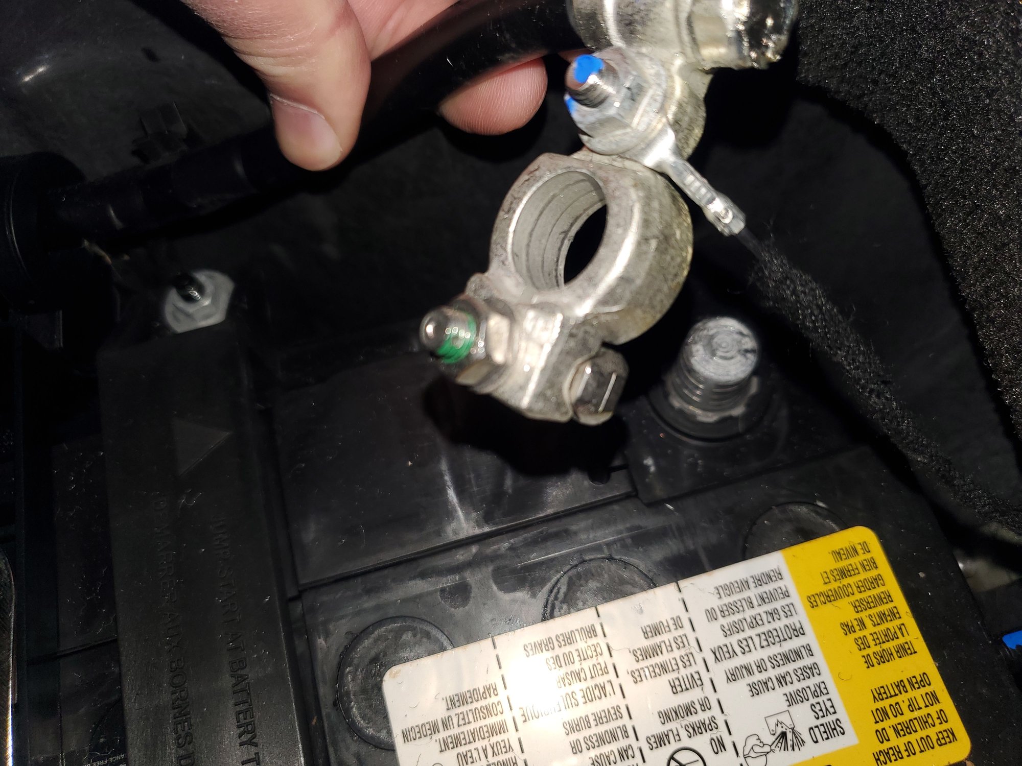

Dash shows the charging voltage. It can be as high as 15 V after an engine start and should ramp down to around 12.7 volts after driving for a while.
Double check that the small black wire is still attached to the negative battery cable. It is often broken when changing a battery. The wire is important for proper charging.
New batteries can fail. I have seen bad batteries on the shelf - I ask for a quick test before accepting any new car battery.
Most stores like Autozone can check your charging system for free. I would pull back the carpet myself...
Ron

Thanks Ron. The black wire is good. If the dash shows charging voltage, then my problem is definitely the alternator. I've never seen it go below 12.7V. And with it dipping down to 9V I'm thinking either its not charging or the regulator is bad.
as long as I've had the car it's usually around 13 or 14V when driving. Tonight on the way home I had all electronics off and when I hit the brakes, the voltage went wonkers up and down. My guess, the extra draw created a drain the the bad alternator could not keep up with. Hopefully I'm still covered on my GM extended warranty.
