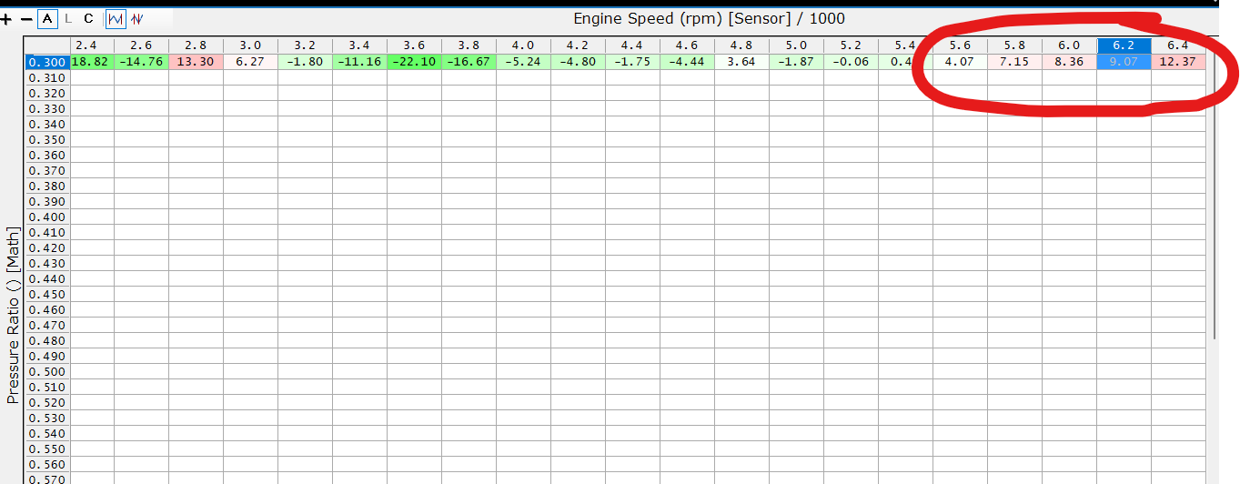

Can any wise person check my LOG to see if everything is correct or if there is something wrong with the exhaust and I need adjustments?

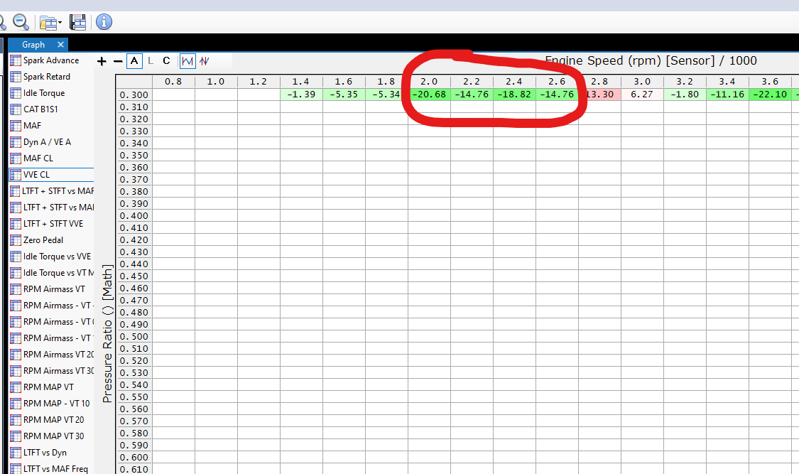

Looks like you need some VVE work and some MAF work just to get started. Likely fuel enrichment for WOT needs work as well.
Are you sure the tune is otherwise stock? Normally things lean out slightly after your mods but yours is all over the map and generally waaaaaay rich although you do have a couple crazy lean areas as well.

VVE, MAF, and VTT are all stock. Looks like someone messed with the E85 tables. CAGS is tuned out in your original file, and a few other things.
While I do agree that the factory runs a little rich.....your log is showing corrections of more than 20% in some areas. Makes me think you have an upstream exhaust leak that's fooling the o2 sensors.
Having said that, many of the experts on the HP Tuner forum say that even if you've turned off all the aft o2 sensor related "stuff"....there are still various checks and test running in the background that you can't see. When the PCM doesn't get the expected response, weird stuff can happen.

The only way you're getting "a lot more power" is to get it on a dyno so you have a controlled environment and can tune wide open throttle. Your EQ ratio....ie power enrichment (PE) stuff....is all stock. As such, there's certainly power to be gained there.
Base spark table is stock except for one small corner of the table. Someone screwed around with the min spark tables as well as some of the other spark multipliers. The changes are so seemingly ad hoc in some cases I'm not sure what they were trying to do. Given all the changes in the E85 table, it makes me think a prior owner was running E85 and then removed it prior to the sale.
The mods to the car are minor enough that you could just have it tuned for WOT. I'd guess you'll pick up 30-40hp with a reasonable tune. Unlike the old days, the factory stuff is pretty good and the software is so integrated in these cars that often times "less is more" when it comes to changing it. Like most mass produced things, you can usually make the data look better but that doesn't necessarily translate into anything you feel or notice.
Tuning Gen 1/2/3 stuff is equivalent to Grade School. Gen IV was High School with some college classes. Gen V is college level with some Masters courses. Now there's Global B in the C8 and other current cars which is PhD level.
As for how I know it's rich....I'm looking at the part throttle data. I'm using filters to get rid of data in spurious fueling cells, cold temps, etc
At the other end of the spectrum, you're showing lean in the upper RPMs. Usually the PCM adds fuel at WOT for positive fuel trims but I'd have to look more closely to see what's going on before you enter PE mode.
I say all this with one HUGE caveat. Your logs are very short. One is 35 seconds and one is 58 seconds in length. Really need longer logs to truly assess part throttle but again....there are so few mods that just having someone tune WOT is probably fine and you'd pick up noticeable improvement.
