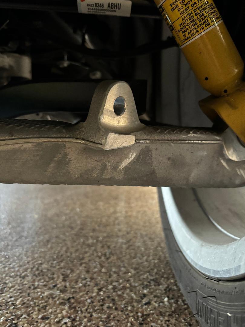

2019 c7 stringray saw this while picking up a drop tool possible never installed at the factory or bracket for a grand sport ?? rear of the car

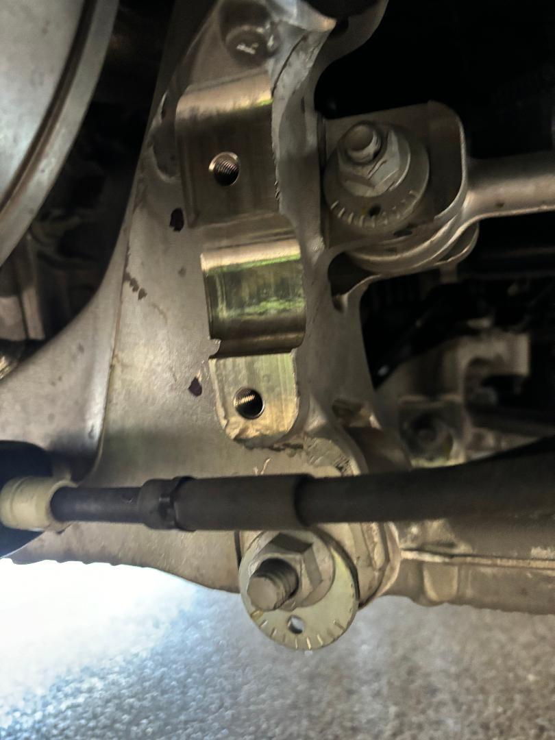

You are missing your front anti sway bar

You are not missing anything if car is a base C7 as they do not come equipped with a rear sway bar.
Considering the pic is of the rear, I doubt it
Old Sep 30, 2024 | 02:16 PM
96GS#007's Avatar
96GS#007
Joined: Apr 2000
Posts: 15,344
Likes: 4,009
From: Texas
This

thank you neighbor pulled up with his grand sport he had it on base model didnt come with it

No rear-bar makes it much simpler to check/top-off (commonly needed)/change differential fluid.

Drain and refill your rear diff fluid, then install a Z51 rear sway bar from the FE3 suspension, replace your Stingray shocks with the beefier Z51 shocks, and upgrade your front sway bar to the Z51 part.
One of the best mods I ever did, the car stays so flat in turns and still rides comfortably.
