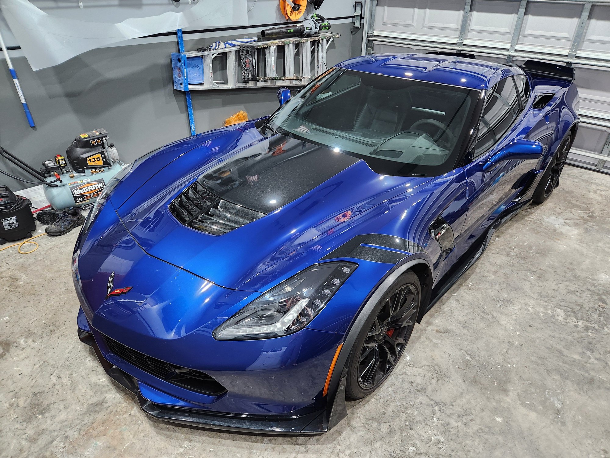

I've installed a number of decals, including the hash marks you are speaking of. Everytime, I follow the below procedure
- wash the vehicle
- clay bar the area
- spray the area with rubbing alcohol and wipe with microfiber
- let dry completely
- ensure the vehicle and decal is at the same temperature (probably should be at least above 60 degrees)
- mix a separate spray bottle with water and a few drops of baby soap
- shake soap solution and spray the area down
- spray the back of the stripe as you peel the adhesive paper away
- apply decal and position and reposition as needed
- squeegee it out (inside to outside)
- let dry and re-squeegee if bubbles are obvious
Good luck
