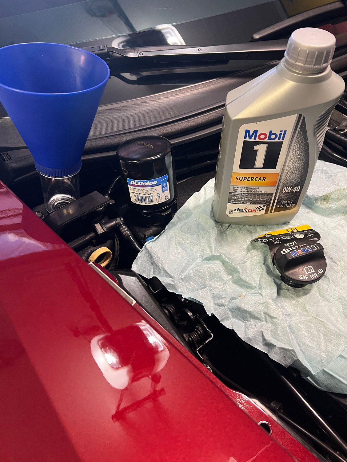

Default Mobil 1 0W-40 Supercar oil - good price
Great funnel same threads as oil cap.
Funnel details
Funnel details
Did my Z06 Oil Change today, oil life at 19% with 2629 miles since last oil & filter. 9.7 qts. Mobil 1 Supercar 0W-40 at $7.84 a qt. Rockauto Parts. 10 qts. Oil cost $78.40, UPF64R Oil Filter $7.86 plus $11.91 shipping. FL Tax $6.03. Total parts $104.20 Labor Cost.....me is free! Love that funnel designed for GM cars, threads into oil fill port with its threads that match the oil cap which keeps funnel fixed and firm, no tipping. I use the 64R as it has more filtering capacity and its structure is more robust, The bypass pressure difference never comes into play as I change the oil at close to 20% Oil life remaing.

@mjdart.
I hate to break the news to you,,,,, but you are using the wrong filter. The UPF64R is 35 psi bypass, the C7 requires a PF64 22 psi bypass. The C7 has a variable pressure pump.
