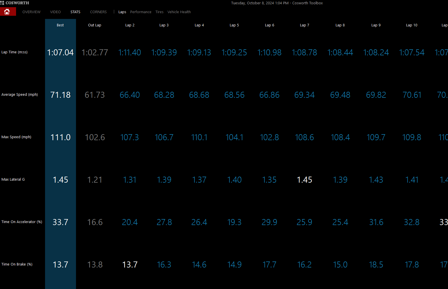

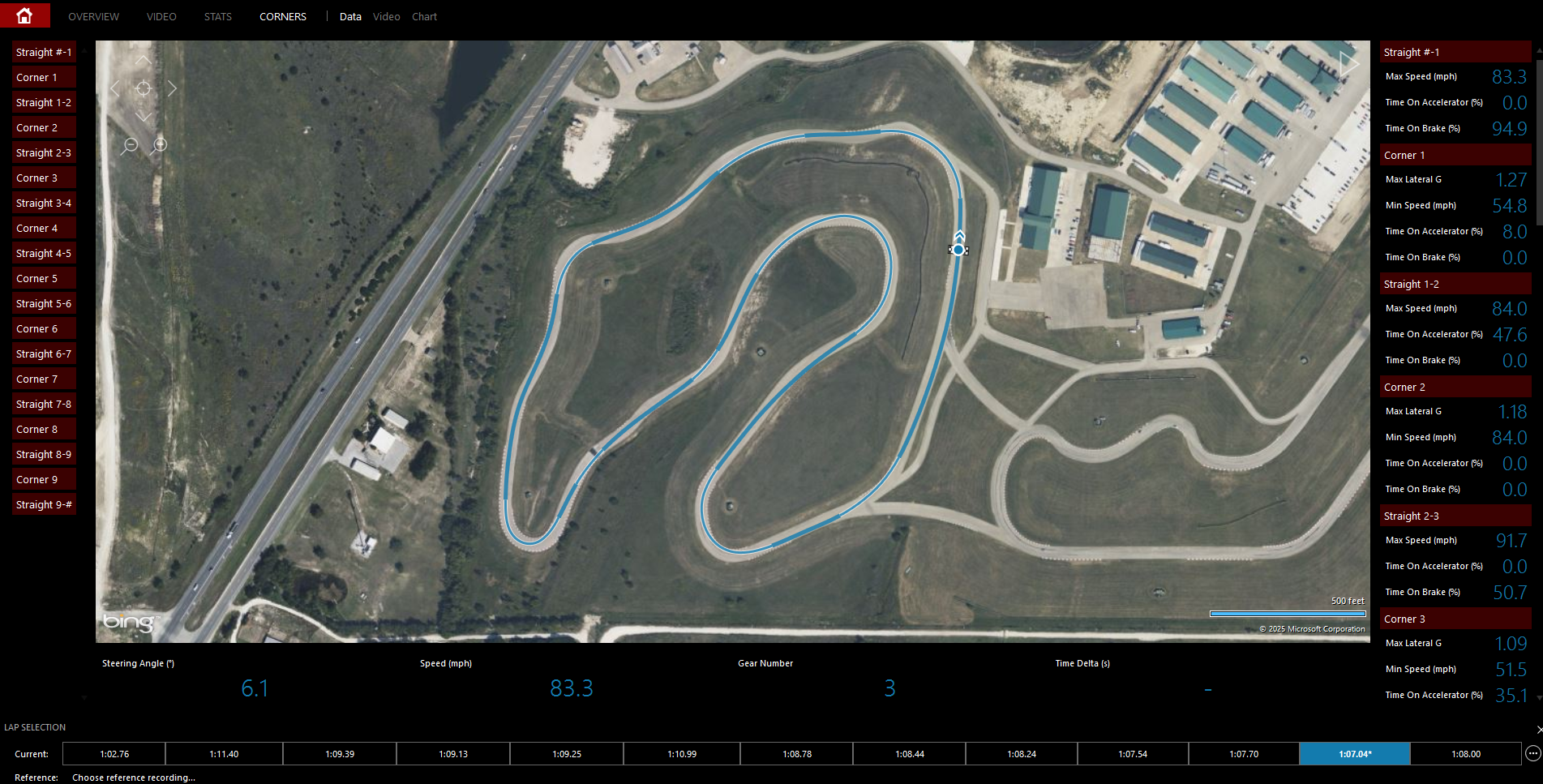

The link to the simplistic version of Toolbox is provided above. I grabbed a random PDR file of mine. Here's what you see....
Some other info....
some more....
Pi Toolbox has many, many, many times more information than the above and you can create math channels to look at info that may not be directly recorded. It also has graphing, etc. It's not what I would consider user friendly/intuitive but it is a pretty powerful tool.

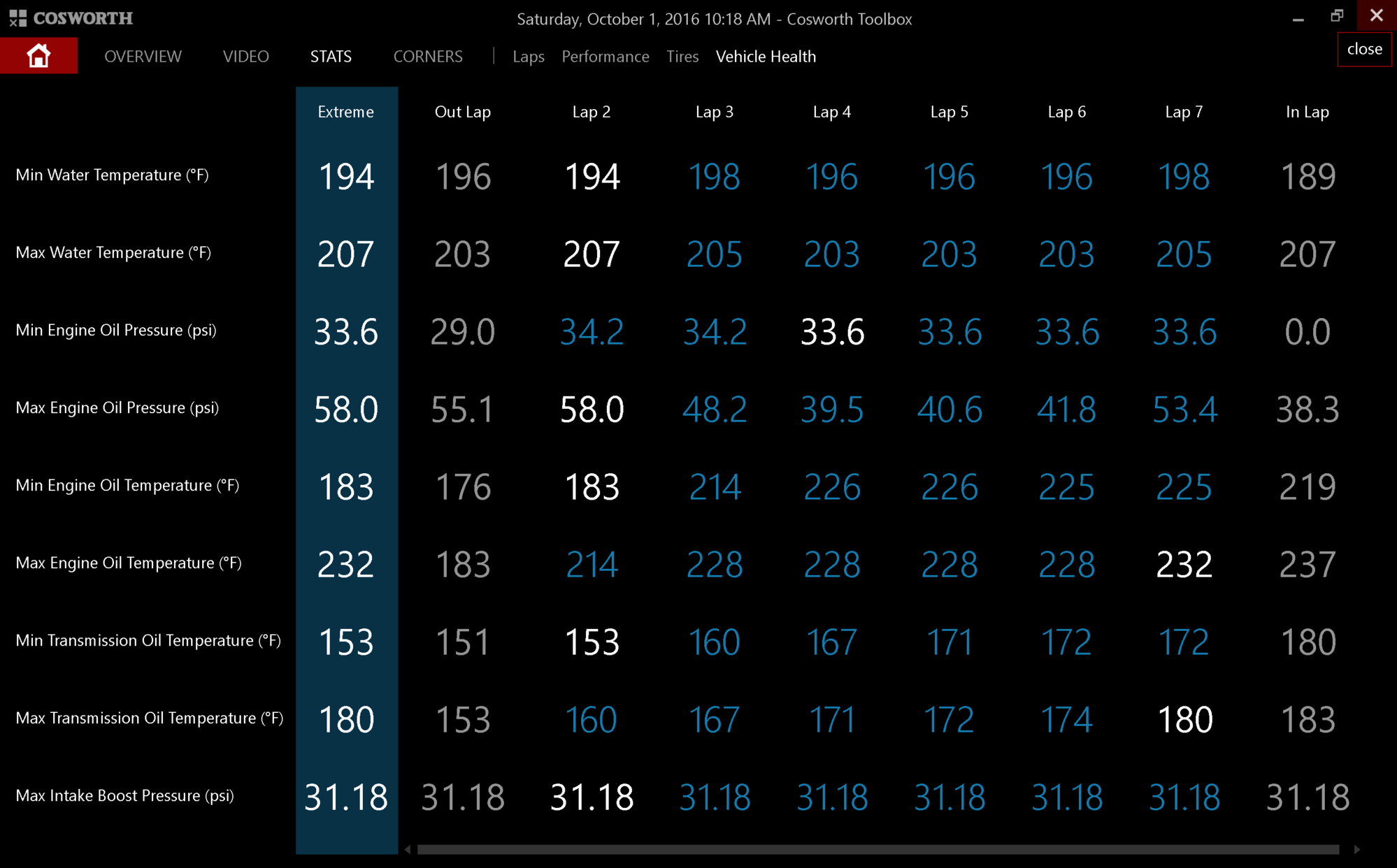

240* oil temp is nothing. I think I'd want to know more about the other temps before throwing $10k at the car. I'd also look at oil pressure, particularly if you were getting an "Upshift Now" light.
I agree, 240 degree oil temp is nothing to worry about and more than likely the coolant temp is lower yet. My 2015Z M7 with the GMPP Secondary Radiator runs about 220 coolant and 260 oil temps, when running hard. Since you are running an aftermarket SC and Katech more than likely did a tune, I suspect your coolant temp is fine unless there is a maintenance problem with the cooling system.

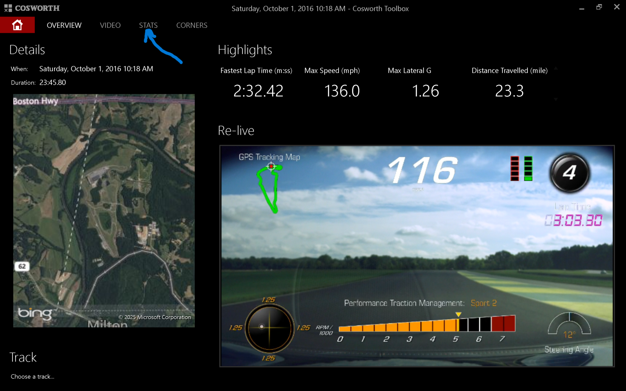

To get the Cosworth ToolBox software to run on your PC go to this link and click the download icon at the top to download the software: https://download.cosworth.com/downlo...r/GM/Index.htm It is free to all Corvette owners that have the PDR installed. You can copy the files on your SD card to a PC so it is easier to load the data into the tool. Files that have been edited or run through video processing software will lose all data except the video. When you have the toolbox loaded on your PC start the software and use the select a file icon to load the file with the data you want to look at.
Once the software is loaded you will see this:

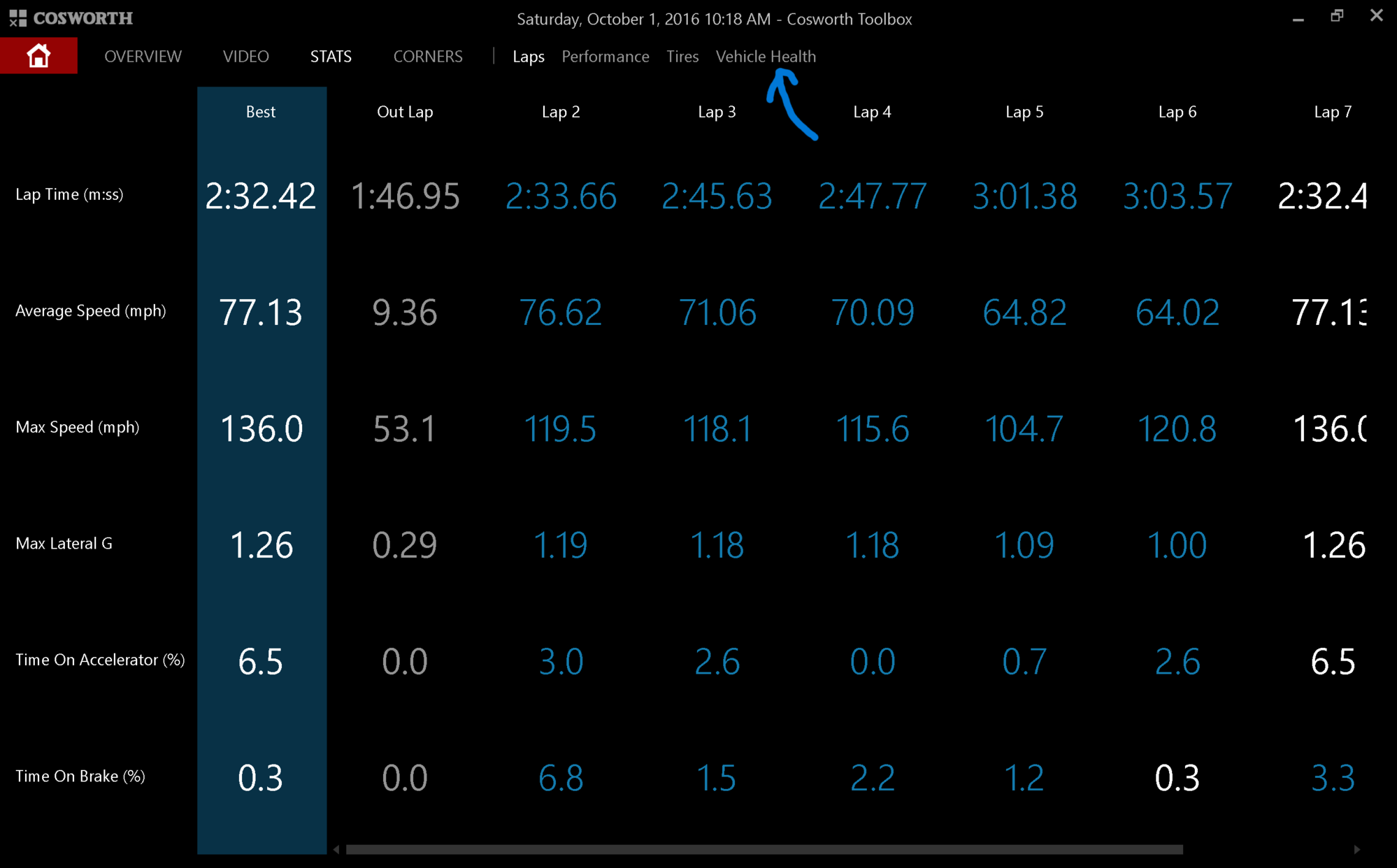

Click on the Stats Icon and you will see this info:
Click on Vehicle Health and you will see your critical temperatures shown for each lap:
