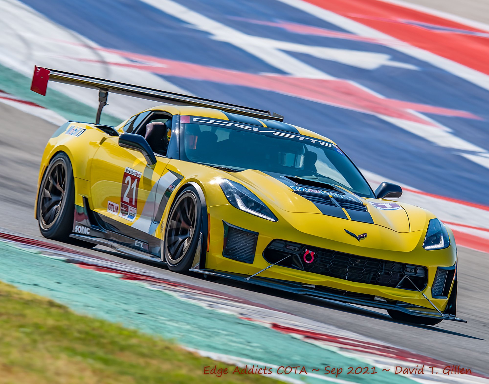

Our cooling kit will absolutely solve his issues. We have numerous Magnuson 2650R customers tracking with no issues.

@Dane@LGmotorsports nice looking car. Can share data to provide context? Before/after coolers installed. Oil & water temps and duration of time on track. Thanks
