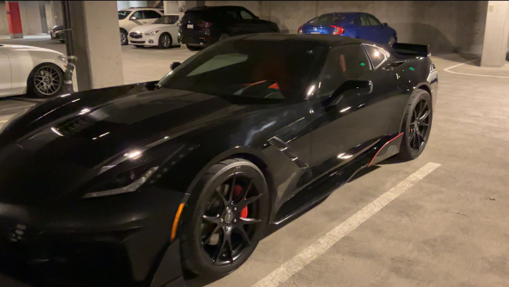

Yo,
Im addicted and obsessed with my vette. i have a C7 Stingray Z51 making 750hp with 600 to the crank. My build is P-1sc-1 procharger, an LT4 high pressure fuel pump with dsx induction and dsx flex fuel. Awe exhaust, a borla x pipe, and a custom dyno.
Im targeting the mid ARH headers as my next performance purchase based on my budget. I want to add at least 50-75 more HP, and make my exhaust note more menacing. i dont have the cash for a longtube setup, and it makes sense to buy new headers before doing any porting.
So my question is how many hours labor to do this instal, do I need to change any of the pulleys on my procharger or modify it at all based on the header install? With a good tune what is reasonable for the hp increase? And just for a comparison Im out in the slicon valley, in California, whats a fair dyno price for a job like this. Does $3650 cover the heads ($1700) after tax, the labor to install, the tune, and any additional parts I might need. Yes i know i can ask my shop, of course I already have, but Im curious about the feedback and wisdom of the corvette community
much respect
Scott
ZR1 bumper, vicrez side skirt wing, vicrez rear diffuser, tps spoiler, forgestar rims, toyo R88R proxies
