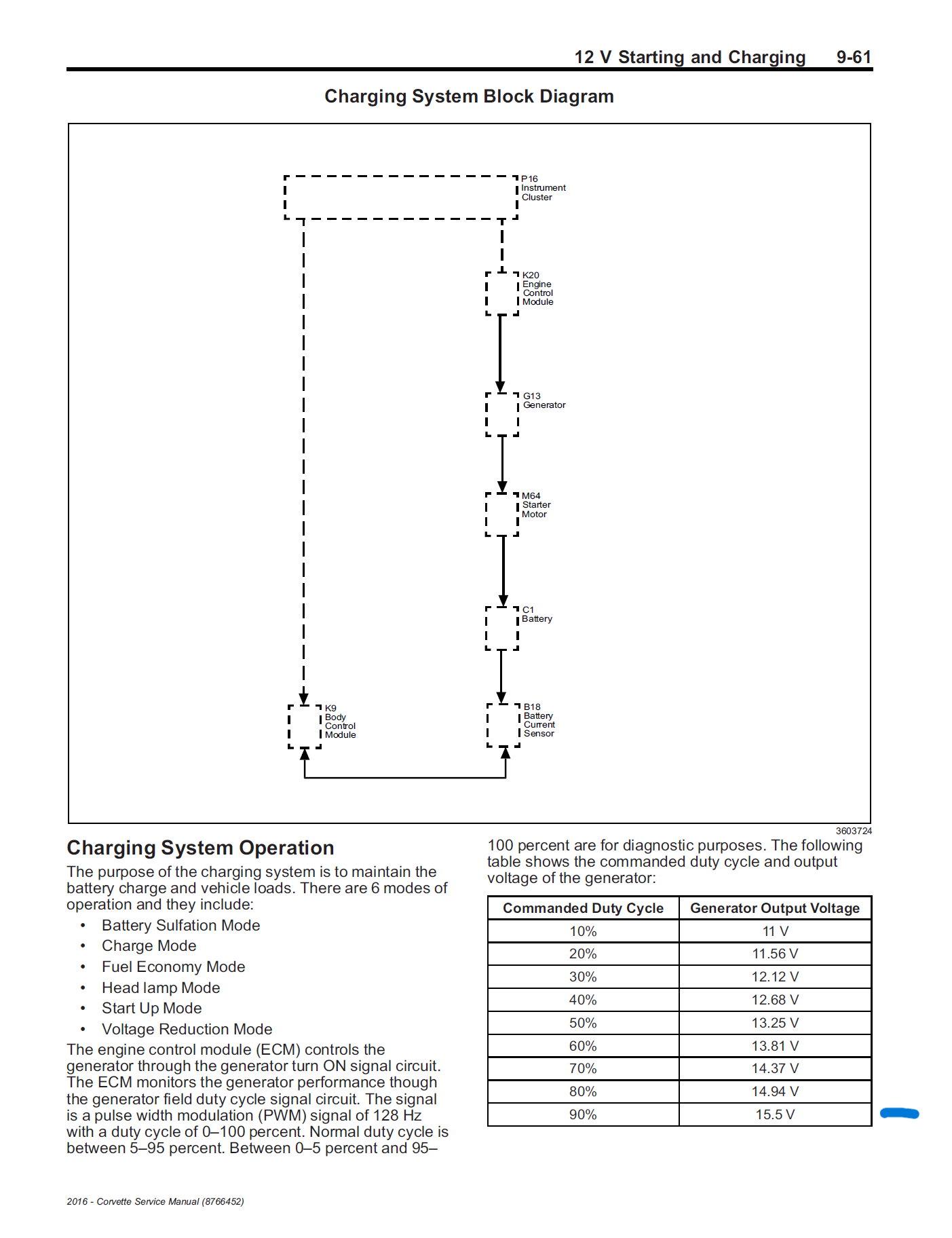

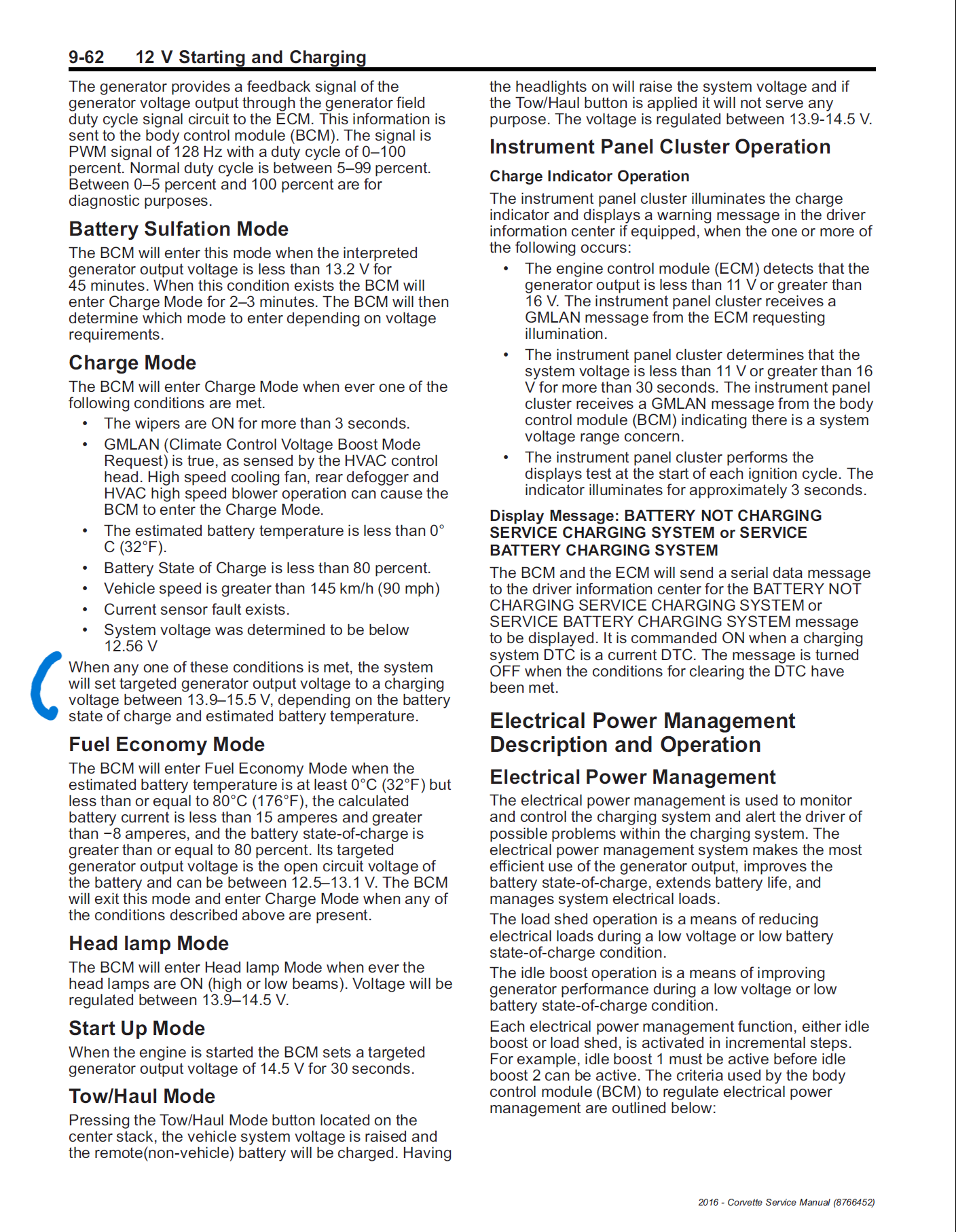

By the way, the C7 Charging system isn't compatible with AGM batteries. It applies a voltage at least a half volt higher than what an AGM battery is designed for.
Bill

It may slightly undercharge the battery from a SOC standpoint but the charging system is designed to provide a higher voltage than desired for AGM batteries. It isn't based on a simple voltage regulator as seen in older cars. It is designed to maintain a SOC on a wet-cell battery. Here are the relative pages from the FSM:
This is the info on how AGM batteries should be charged:
The typical charging voltage for an AGM battery is between 14.4 and 14.8 volts when fully charged, with variations depending on the battery's specific characteristics and temperature; this voltage is usually reached during the "absorption" stage of charging, while the "float" stage maintains a slightly lower voltage to prevent overcharging, around 13.6-13.8 volts.
Key points about AGM battery charging voltage:
  • Important considerations:
    Using a charger designed specifically for AGM batteries is recommended to avoid damaging the battery by applying excessive voltage. !!!!!!!!!
  • Charging stages:
    AGM batteries go through three charging stages: bulk (high current, rapid charging), absorption (near full charge, voltage maintained), and float (maintenance charge at a lower voltage).
  • Temperature compensation:
    The ideal charging voltage can adjust based on battery temperature, requiring a charger with temperature compensation features.
Bill
