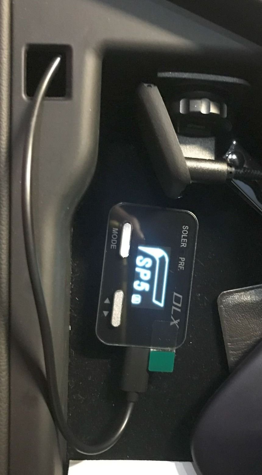

Thanks all. Where is a good spot to put the TB controller so it's convenient to use? On the dash? On the center console? Share pics if you can on your placement.

If you have the Bluetooth version, you do not need to keep it handy, just access the APP on your phone.
When I installed mine I ran the lead for the controller display under the carpet and up to the trim panel on the side of the tunnel, pulled the trim panel and laid the cable in behind the carpet, fished the connector up thru the latch hole in the center console and put the display in the center console cubby. You can un plug it, leave it in the cubby and the cable is there in case you need to use the display.
