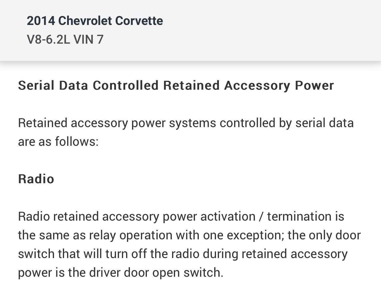

when i turn off the vehicle (2014), the windows still function, however, the Radio turns off immediately. No 10 minute grace period. How can one item work and not the other? Not a huge problem, as i know about accessory mode, but would appreciate thoughts or suggestions.

From Service Info it looks like the radio will turn off when the drivers door is opened.

yes, that is correct,
however,
in my case,
i am still sitting in vehicle,
waiting for my wife,
door has NOT been opened.
thx
