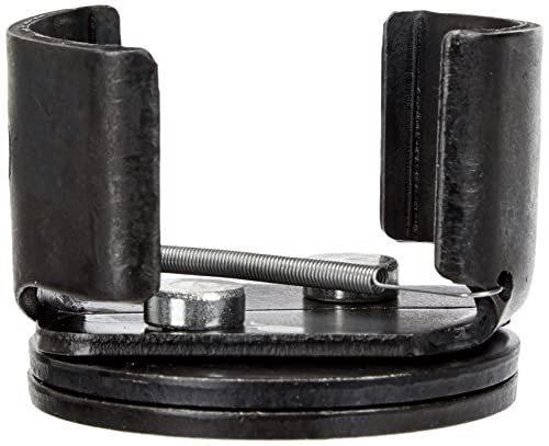

Or you can just use this type of "grabber" wrench only to remove and then hand tighten. I have had a tough filter that a previous owner tightened and this got it off. The socket type are cool but they can damage the filter if it's really on there, and they can strip and get stuck. I never use a wrench to tighten a filter. About 3/4 of a turn once it contacts the mating surface and it's good to go.
https://www.amazon.com/Lisle-63600-O...002SR4Q8&psc=1
That is what I have used for four years. It works well. Amazon has a great price. I got mine at NAPA for 3-4 times Amazon’s price.
