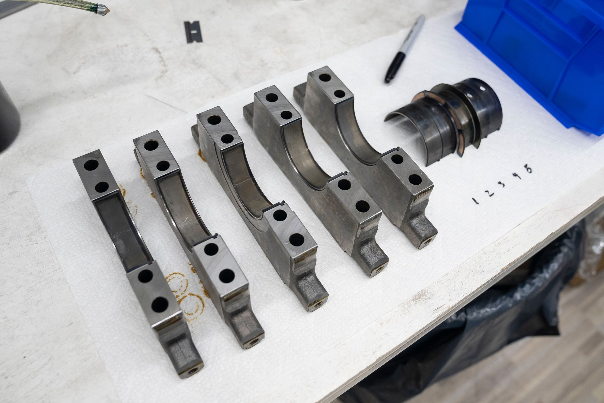

So I have a couple questions regarding the main and thrust bearings in a C7 LT1.
1. How many main crankshaft bearings and thrust bearings are in a C7 LT1 engine?
2. If Im putting in a new forged steel crankshaft as part of a rebuild, do i need standard or undersized main bearings?

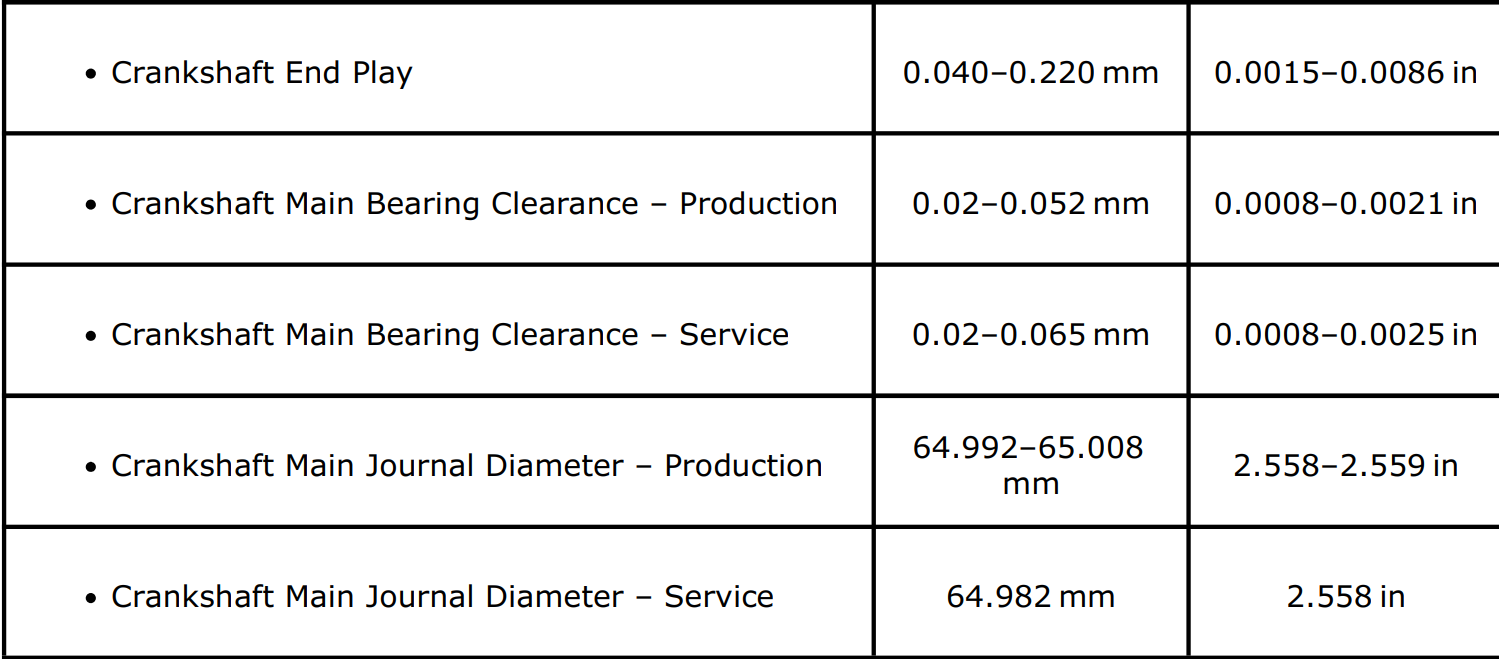

Specs for the new crank:Stroke:3.622"Main Journal Diameter:2.559"Rod Journal Diameter:2.100"
As for the main bearings, I'm seeing my options as standard, 0.010 undersized, 0.020 undersized, and 0.03 undersized...so im trying to figure out which ones I need for this particular crank

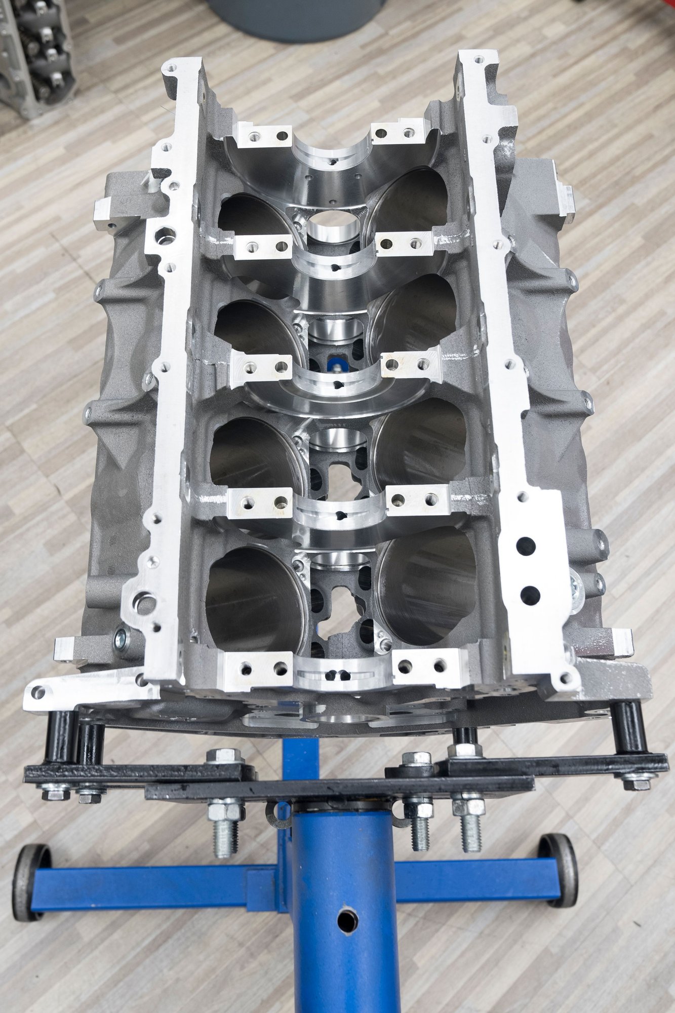

To do this correct, your machinist/engine builder will need to measure the journals on the crank, then measure the connecting rod big ends and the engine block with the main caps installed and then determine what work needs to be done, and what size bearings that you need. Ideally, if the crank is new, and machined to factory specifications, standard size bearings should work, but there are tolerances and if you are planning on higher power, it is best to do it right.

Those are the specs. There is always a tolerance around the specs. You buy the crank, measure the mains, and then determine the bearings you need to hit the clearance you want. You're going to need to do the same for the rod bearings.
What the engine is being built for also plays into the specs you want. Stock? Boosted? Normally Aspirated but a bunch more hp?
You don't say what bearings you're using, but I've never seen a brand not offer standard size bearings, besides under and over. If you're using a bearing that is coated, the coating can affect what the clearance should be.
