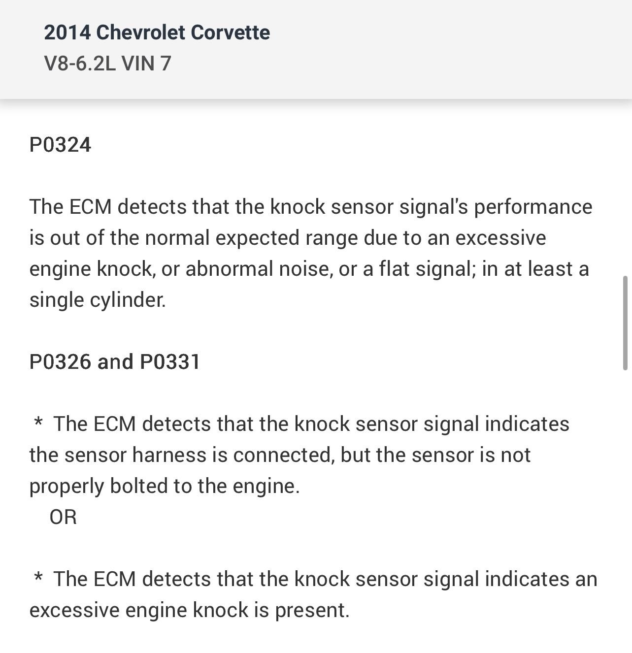

When you post a DTC it is either a P,B,C, or U followed by a 4 digit number…since you heard a rattle you actually had a knock so it can be low octane fuel, low quality fuel or a lean mixture…below is what sets those 3 DTC’s…these are Type B DTC’s which means the fault must be present during 2 consecutive drive cycles or “Two Trip”.
