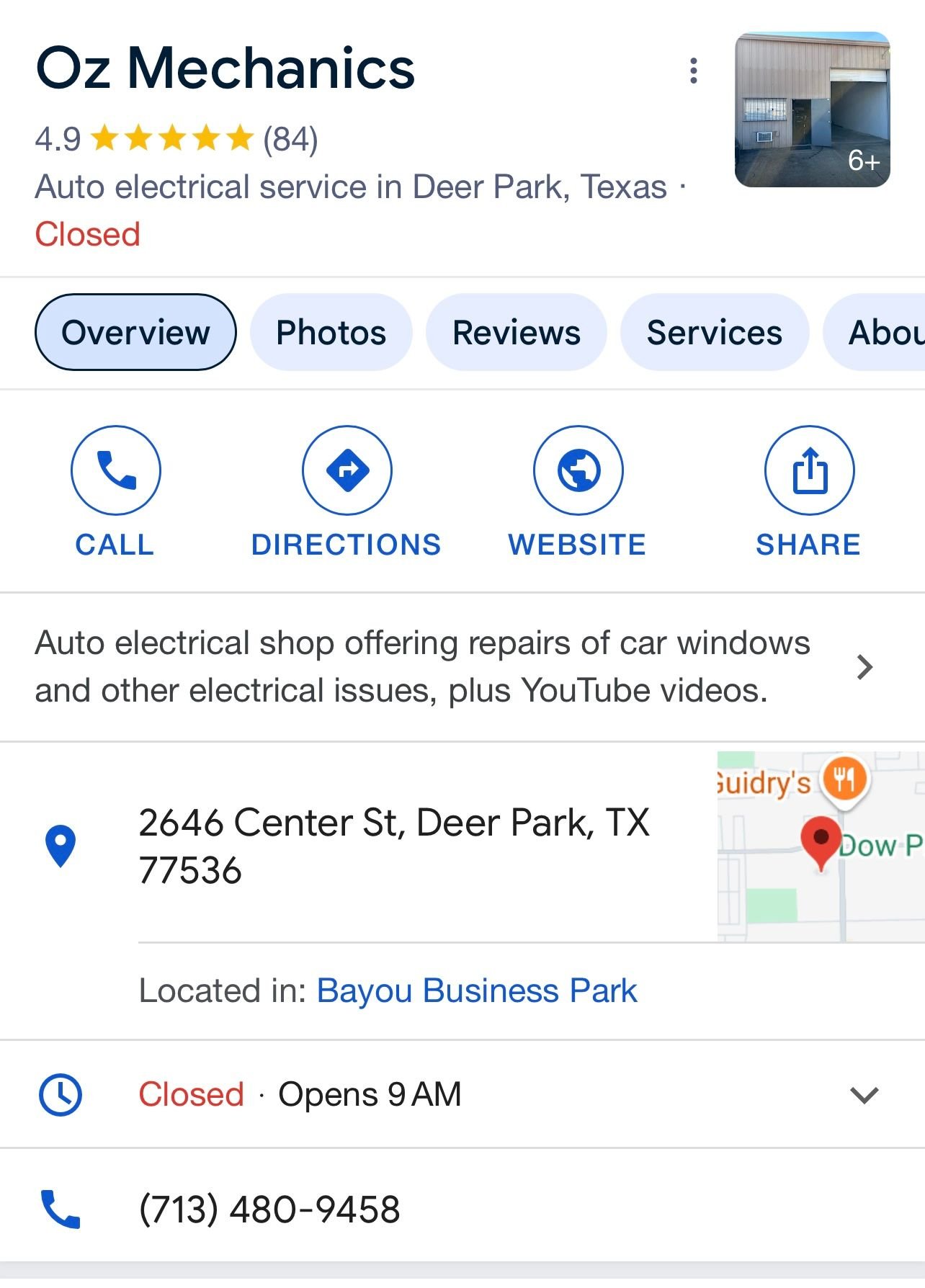

If you are located in Houston look up Oz Mechanics…I believe Oz is still in Pasadena or he is in Deer Park now…sharp Tech !!…video below…I use the inclylinder testing method which is “advanced”.
