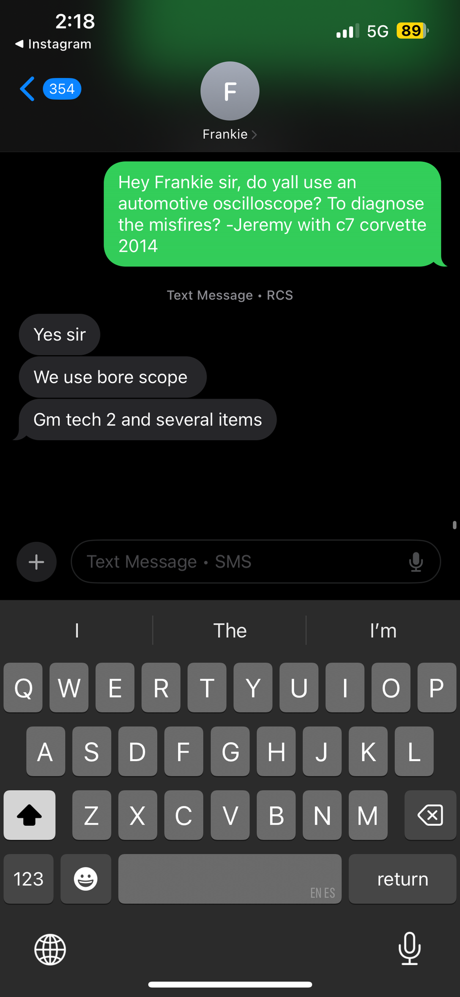

Old Jun 9, 2025 | 03:26 PM
  #42
C5 Diag's Avatar
C5 Diag
Moderator, Tech Contributor
Posts: 15,498
Likes: 3,999
From: Cape Coral, Florida
Ask what tests have they done with the scope…have him send you the waveforms they’ve taken.
I asked him, side note: they definitely know now I have another tech that’s helping me with seeing if they’re bull crap or not lol.
Unless you can see proof that they’re using a scope I wouldn’t believe them.

A BORESCOPE is not an oscilloscope !!

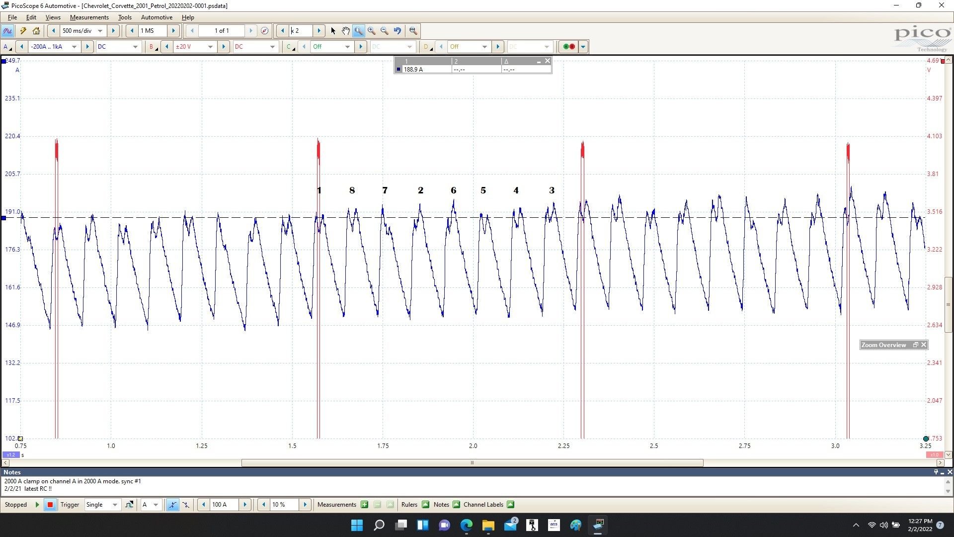

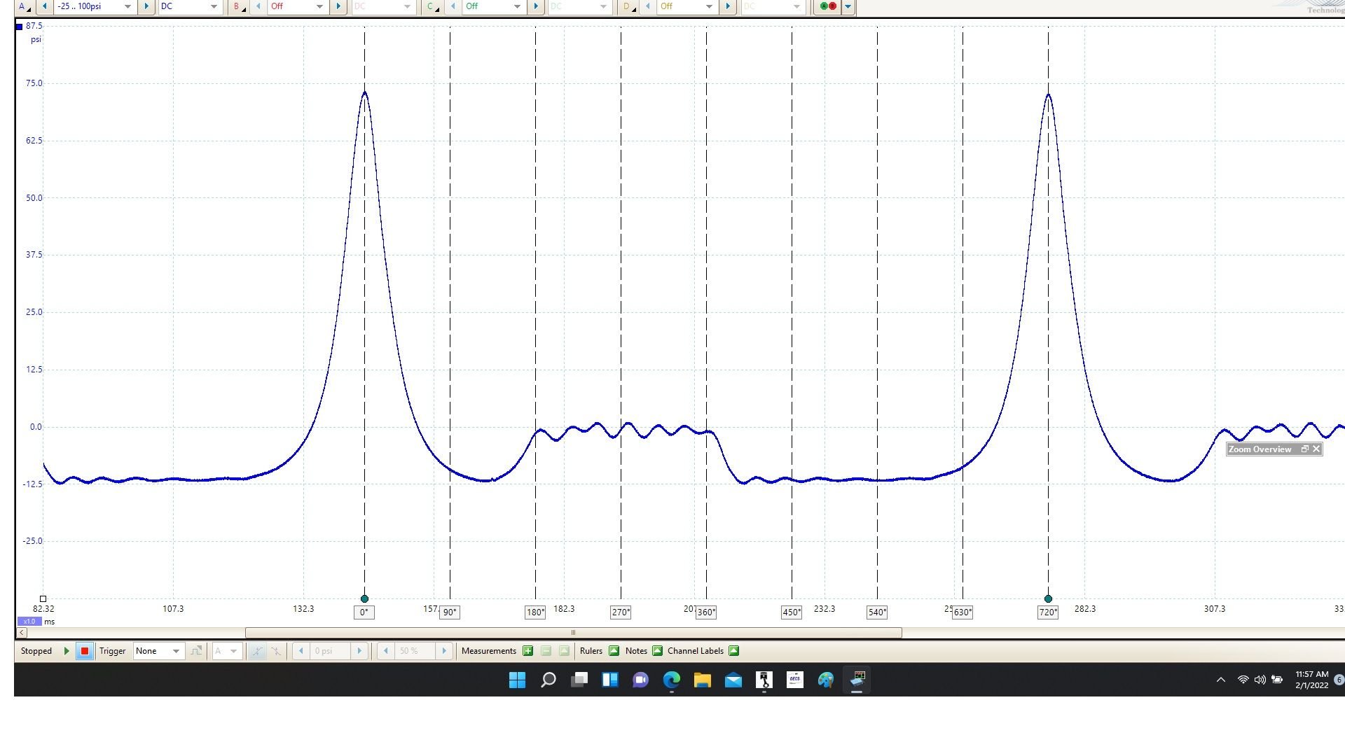

Originally Posted by Gearhead Jim
Dealers don't have the equipment to diagnose a misfire? What do they need that a dealership won't have?
Dealers do NOT use the advanced diagnostic equipment needed to quickly and accurately diagnose a misfire ...they need a DSO...Digital Storage Oscilloscope which we call a labscope...dealerships only replace parts and if it is something that may be internal to the engine like say a worn cam lobe they will only guess since the engine must be torn down and that will be expensive...in a few minutes I can put my pressure transducer into that spark plug hole and run the car and interpret the waveform below...I can tell if a timing chain has skipped a tooth, a clogged cat, a worn cam lobe, a valve that is either stuck open or closed or leaking, and if I put connect this transducer into the oil dipstick I can tell if the rings are bad...yes, you can do a leak down test but this is faster...I don't have to turn the engine over to find TDC...with a labscope I can do a "relative compression" test in 2 minutes vs. 2 hours that it will take to remove all the plugs and use a gauge...that is the other waveform below....video below of how the best diagnostic tech and instructor in the country finds a misfire.

Originally Posted by Zjoe6
^^^ C5 Diag, wow, that's a level of automotive diagnostics I have never seen before. Really eye opening. Thanks for posting that video. Fricken straight up scientific.
This level has been around for 20 years…unfortunately 99.999% of mechanics don’t have this level of expertise or the equipment necessary to perform it….the gentleman in the video named Bernie Thompson is the father of incylinder pressure analysis…his company ATS Solutions in Albuquerque NM designs and manufactures the type of equipment seen in the video…that 8 channel scope and scan tool is around $12,000.
