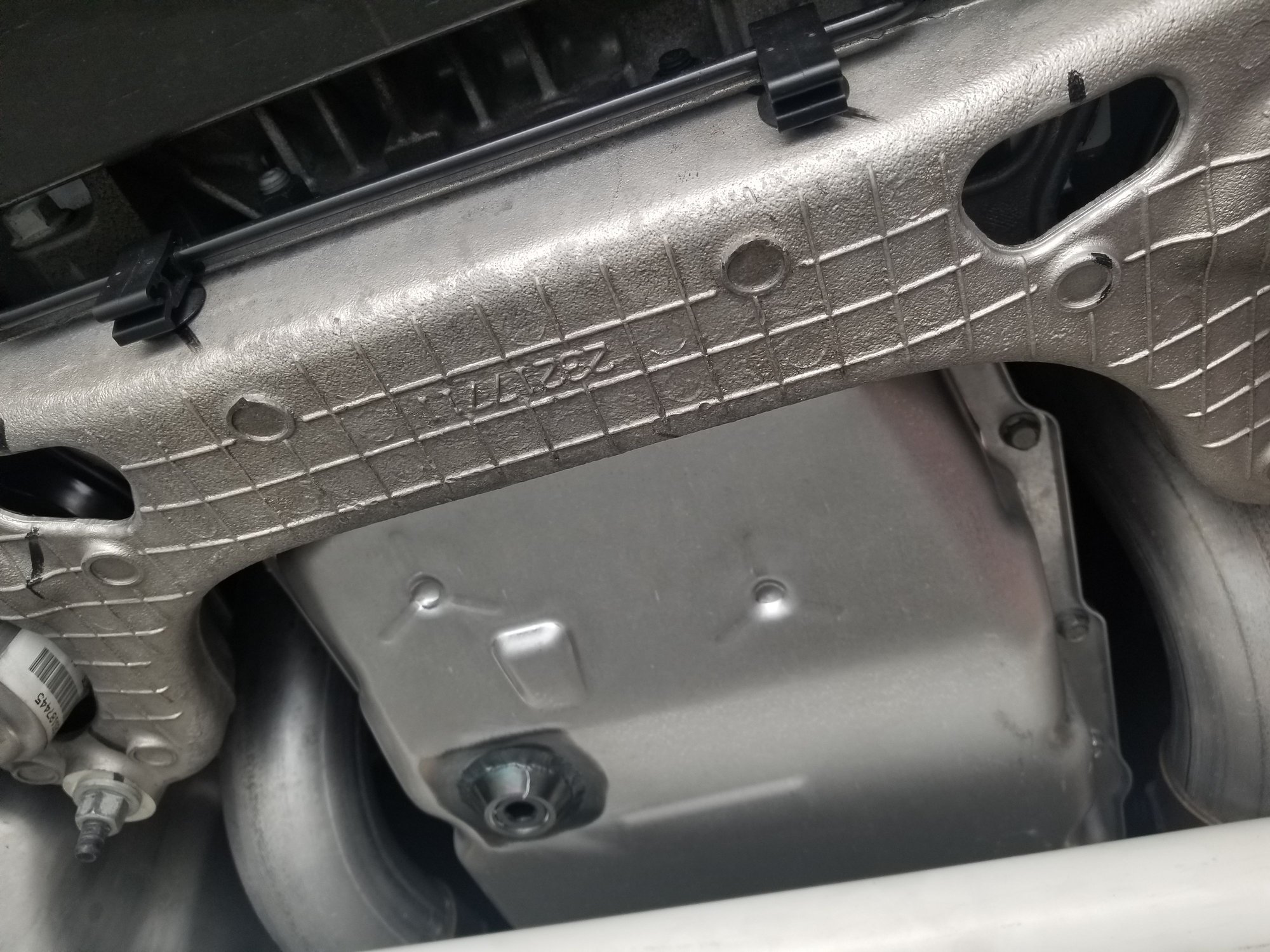

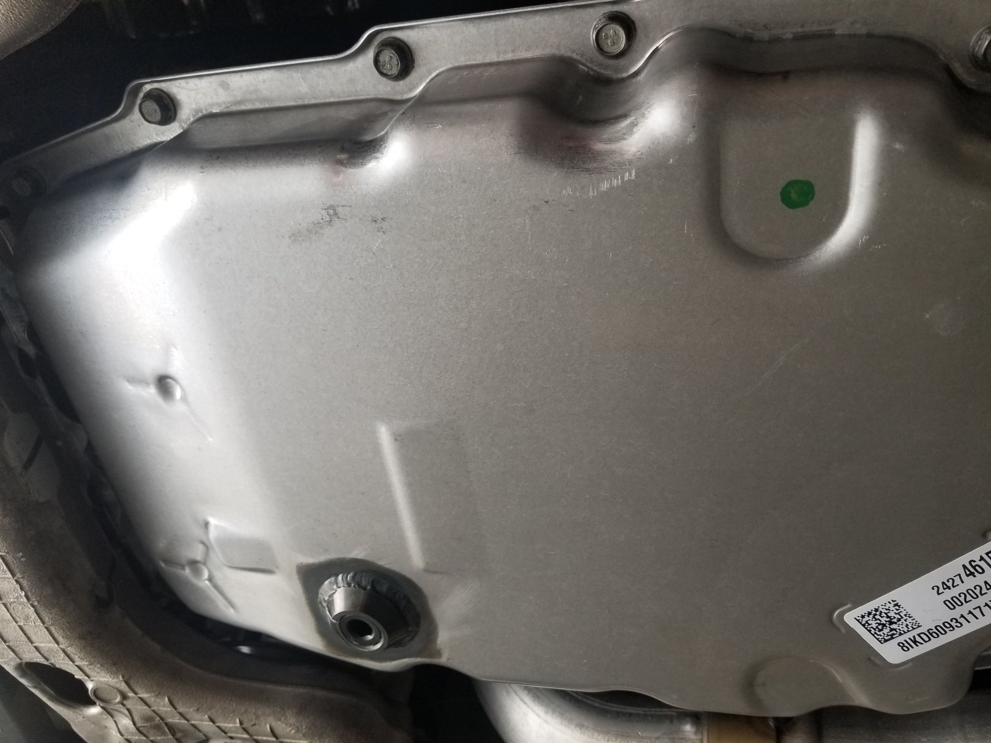

I did my triple flush myself. Before I did the first flush I bought a new trans pan and welded a low-profile bung onto it. Dropped the pan, replaced the filter, installed new pan with drain, refilled. Did it two more times just using the drain plug.
Question. Considering the triple flush is a "1 off" and we do transmission service every 50k, isn't this a large expense for that kind of service? Or am I mistaken?
It was still way cheaper than letting the dealership do it. If you have ever dropped your pan to drain the ATF and change the filter the small cost for a pan and bung is waaay worth it. IMHO

Jimbob, The bung you purchased. From whom?? Did a great job on the welding, Tig??
Not for me. I don't have any welding tools 9r remember the skills I had 30 years ago so I will have to hire a welder. From what I see, it's the same as any other pan drop I have done except this is 3 pan drops, right? We used to loosen all the pan bolts, put the drain pan under the pan and loosen the bolts more to empty the pan as much as possible before removing the bolts altogether.
