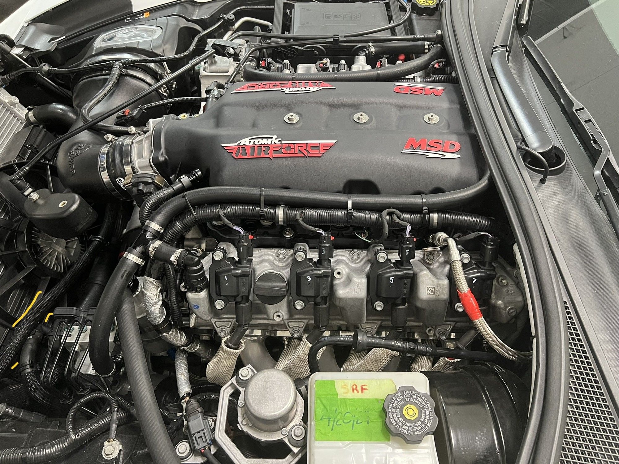

Other than make more intake noise on a stock LT1, they work fine. Won't add power. That's why all the ads say something along the lines of "up to xx hp". That means 0 hp up to xx hp
I've had my AFE CAI for years. It was on the stock engine and now it's on the current 416. If you look close you can see it in there...
