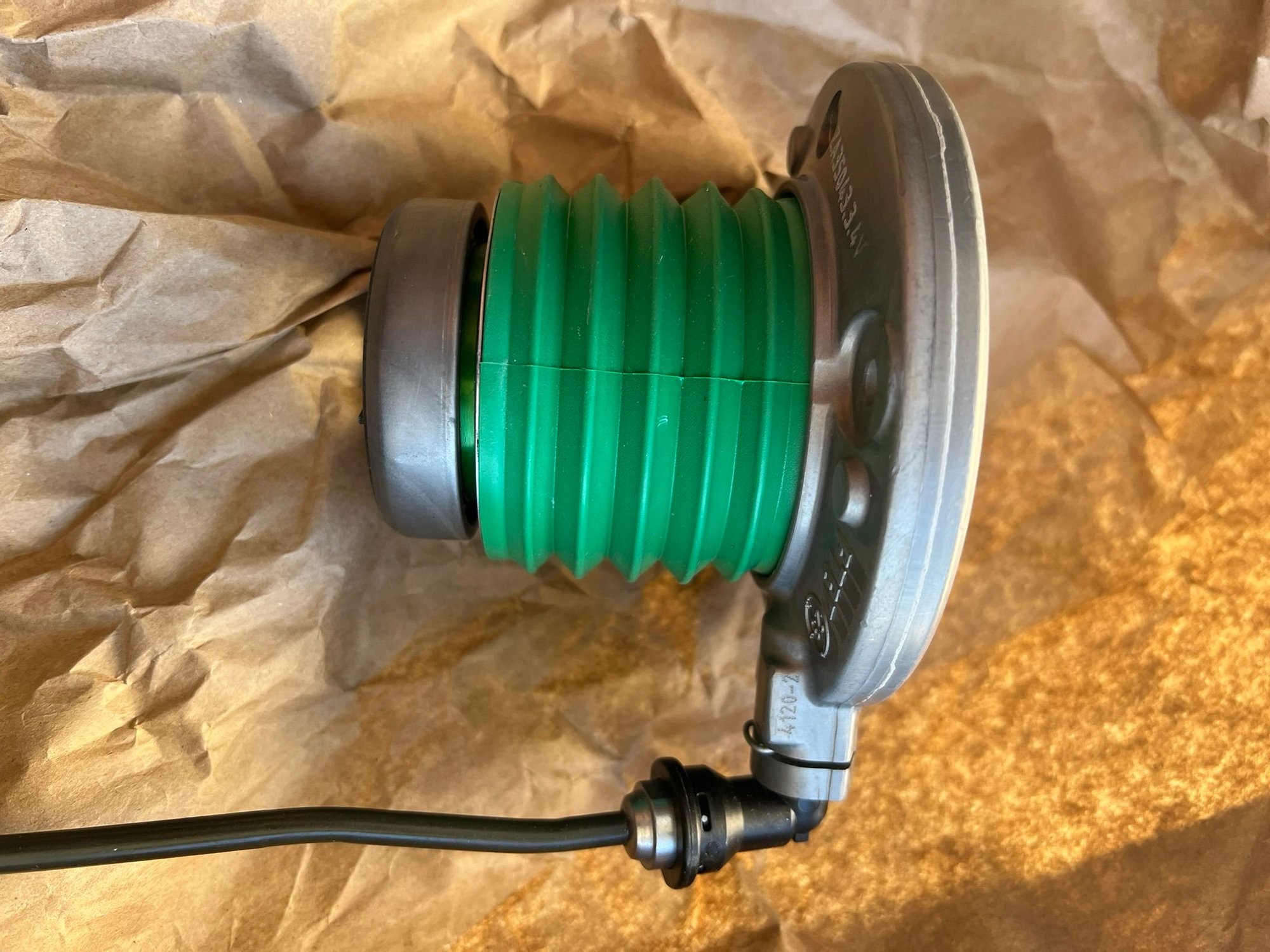

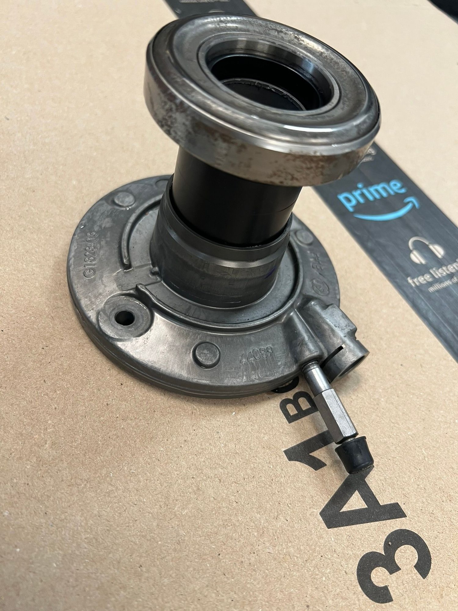

Below are what the hydraulic release bearing looks like for those that are curious. The top one is what I used with my RPS lightweight street twin. It has an adapter on it. The other is my "Monsterized" OEM unit.
But hey....you do you. If putting it in neutral makes you feel better so be it but it does zip regarding wear. Peace out
