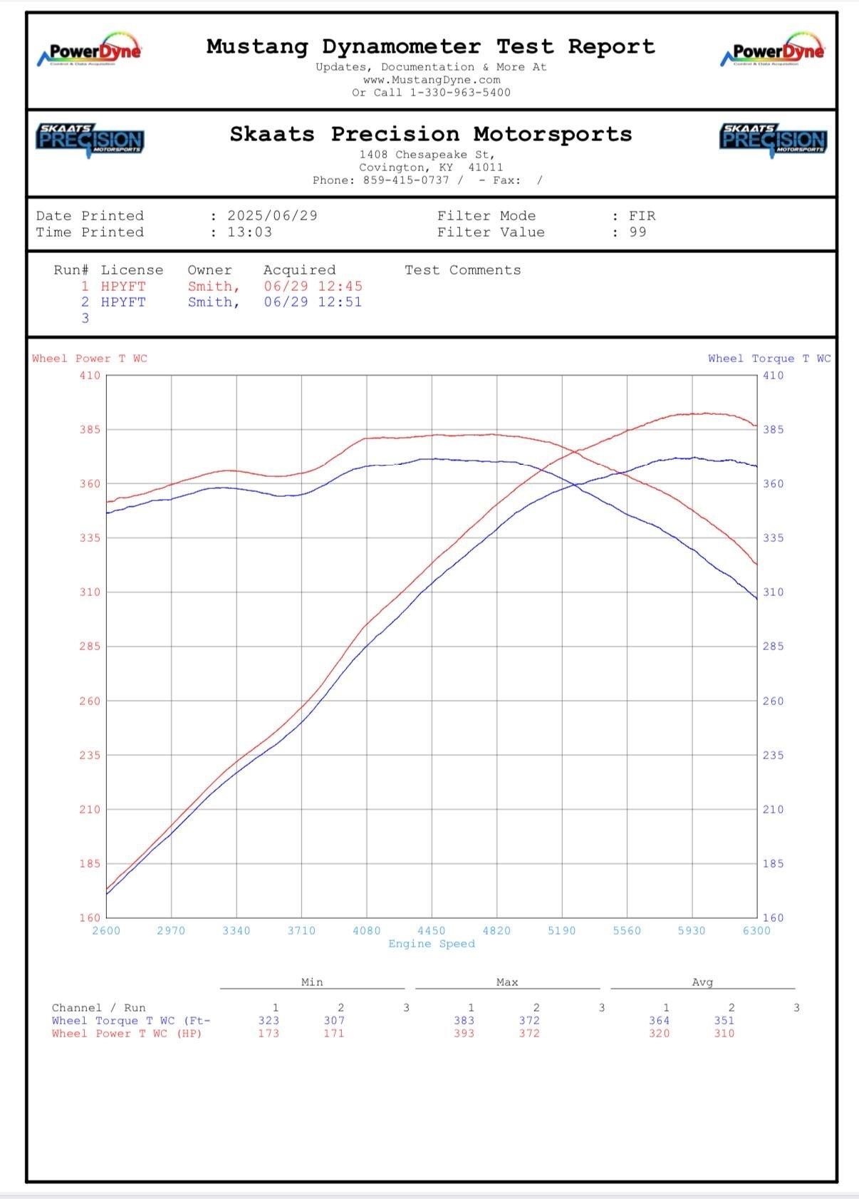

First graph is exhaust valves open vs closed. That is ~20hp/~10tq less leaving the valves closed. Both runs started around the same engine coolant temps
393/383 open
372/372 closed

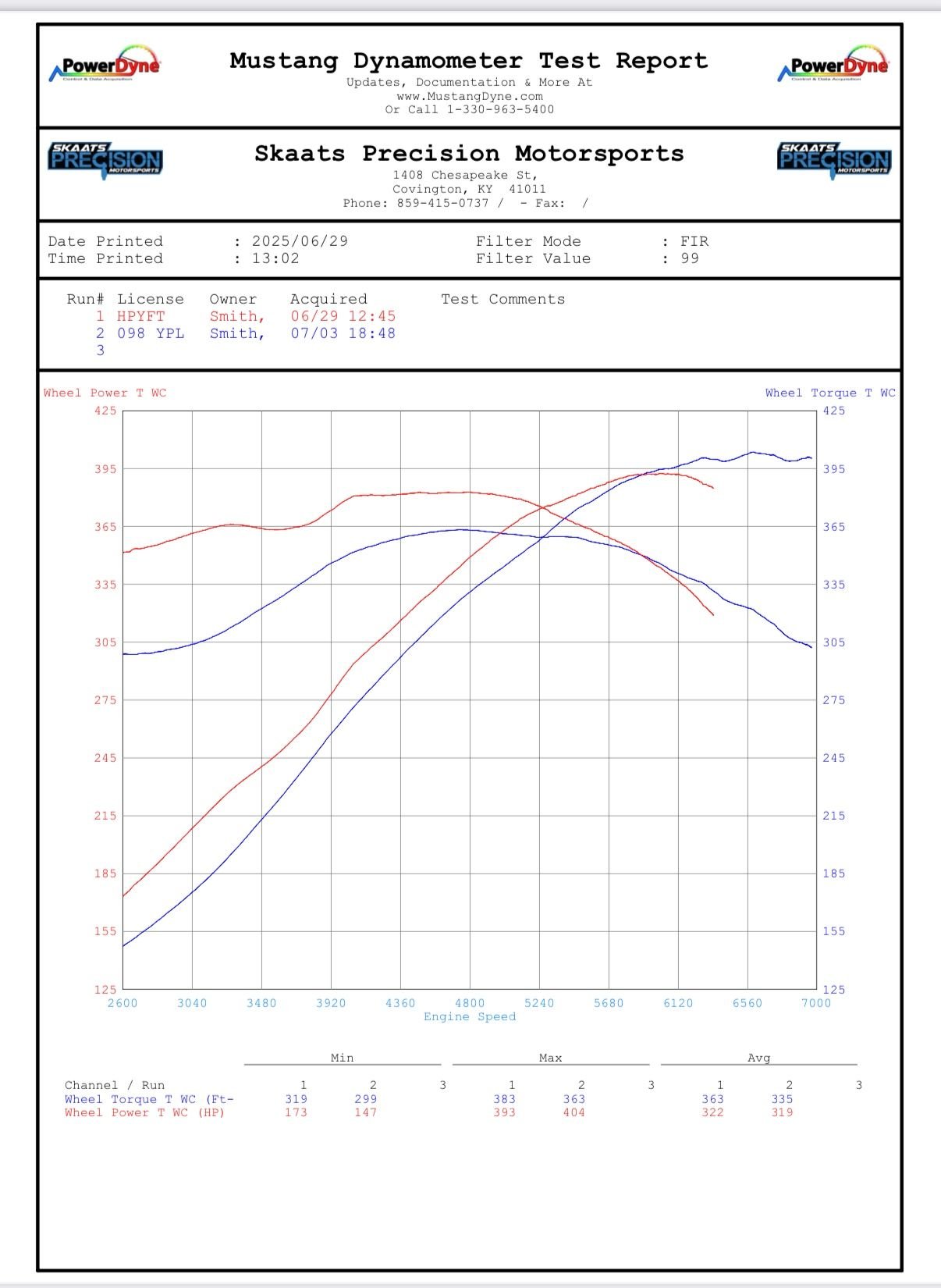

Second graph is compared to my previous C5Z on this same dyno with full exhaust/BTR stage 2 cam/ported LS2 TB/ported Dorman LS2 intake/LS7 air bridge/LS7 card MAF on speed density/E85
Just shows the peak numbers do not tell the full story. The C5 was built to pull more RPM and around autocross/midrange power. But the HP/TQ at the low end of the LT1 6.2 is what gets you going!

I don't think I've seen a dyno difference performed with the exhaust valves, pretty cool. Thanks for that.

How did you keep the valves closed during the pull?

Mild to Wild switch

Wow, 20HP just by opening the exhaust valves. I would not have expected that.
