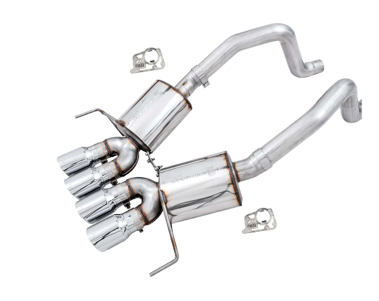

Hi , Hope everyone is doing well! I have a issue with a code coming up and not sure why - I have a 2016 c7 2 lt - automatic z51 -
I just added a AWE car back touring exhaust , very happy with it ! But the company explains I purchase the brackets to hold the npp actuators open -

Is this what you bought? The "brackets to hold the npp actuators open" are the AFM simulators. They need to be installed to prevent AFM-related codes. Nothing to do with NPP.

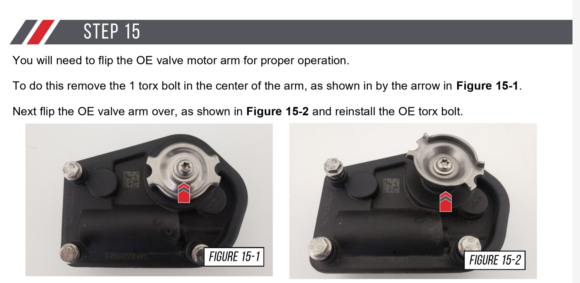

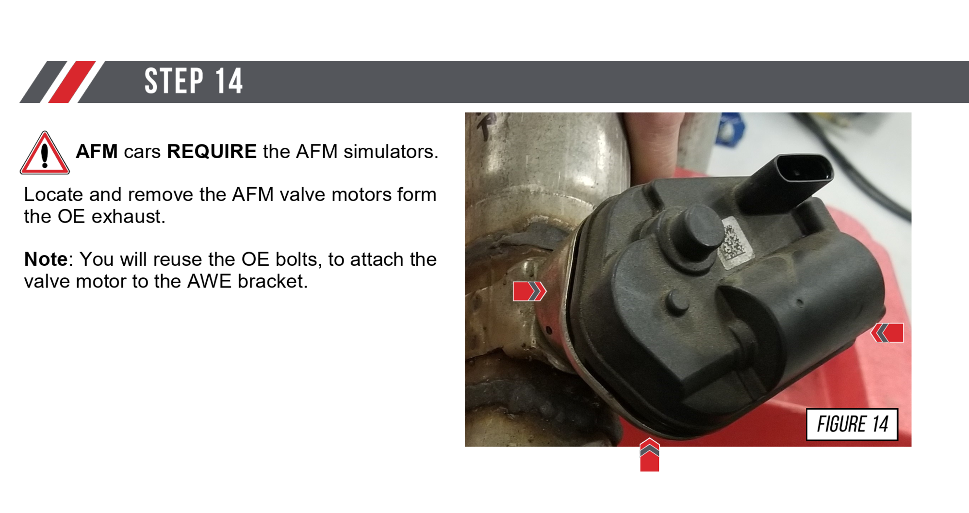

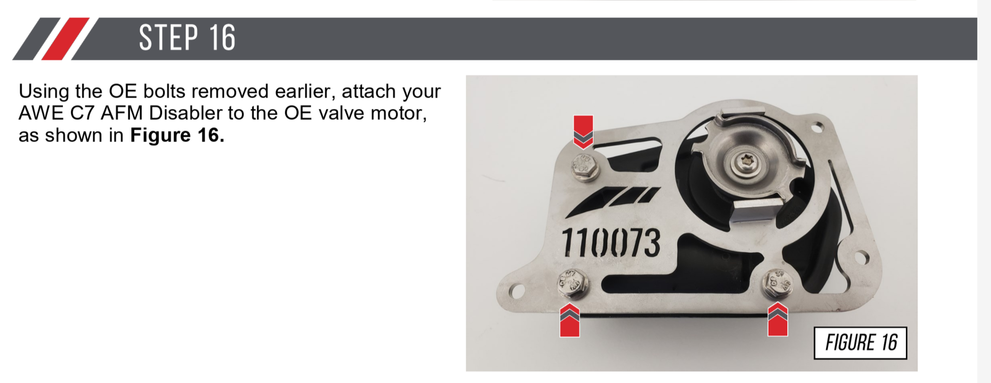

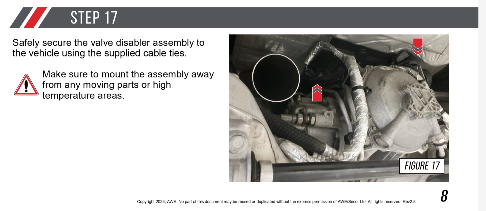

As mentioned before that code is a message from the CCM telling the ECM to light the CEL. It doesn't mean there is a direct problem in the CCM, there could be something external to the CCM. Since you just had the exhaust installed, that is the first thing to suspect as a cause. Make sure the AFM valve brackets are installed and that the valves are set properly according to AWE's instructions.
The CCM controls the AFM valves. The non-NPP C7 Stingray models are the only ones that have just AFM valves. The NPP Stingray models have AFM valves ahead of the muffler and exhaust flow control valves in the muffler outlets. The purpose of the AFM valves is to reduce unpleasant noise when the engine is running in 4-cylinder mode. Here is the schematic for the AFM/NPP controls:
Modules Q15A and B are the AFM control valves (the blue markup line goes from the CCM to Q15A. The wiring from the CCM to Q15L and Q15R shown in the schematic doesn't exist on your car.
Could you clarify what was done with the AFM valves and their simulator brackets? Did the shop install the brackets and valves? Did they modify the valves per AWE's installation instructions before installing the valves in the brackets? Did the shop plug the connectors of the wiring harness from the CCM into the valves?
AWE's Valve and Bracket Installation Instructions
Bill
thank you very much for all the info , so my car does have 4 actuators , as you mentioned 2 on each side before and after the muffler -
they did all of what you mentioned as far as I know ? But I’m going to ask them and send them the info you provide !! I really appreciate all the help ! Thanks

The awe axleback "includes" the afm actuator bracket. Was it missing from the box or did the shop forget to install it? Your afm valve actuators (before the muffler) need to be mounted to the brackets to avoid the cel. Your npp valve actuators (after the mufflers) just have to be taped and tucked up into the chassis with zip ties.
