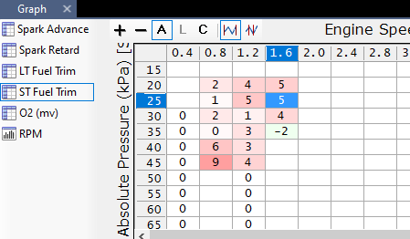

C5 Diag, unfortunately I did not log S2 channels when I pulled the old B1S1.
Here is after changing upstream O2 on both banks. I think they're fine and can be removed from the problem equation?
STFT
STFT
LTFT
LTFT

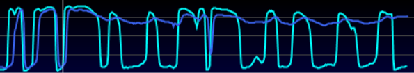

Forgot to mention but as you did I also suspected the MAF and it's brand new, installed on the same day before this scan.
You can see O2 upstream sensors switching from lean to rich every second on the graph. While O2 downstream sensors stay around 600-700 mV. That's not expected?

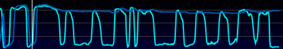

upstreams normally switch 200-800 mv’s and downstream remain fairly steady at 600-800mv’s
that's exactly what they do:
Bank 1:
cyan is B1S1
dark blue is B1S2
graph range is 0 to 1000 mV
Bank2:

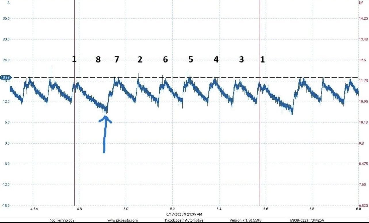

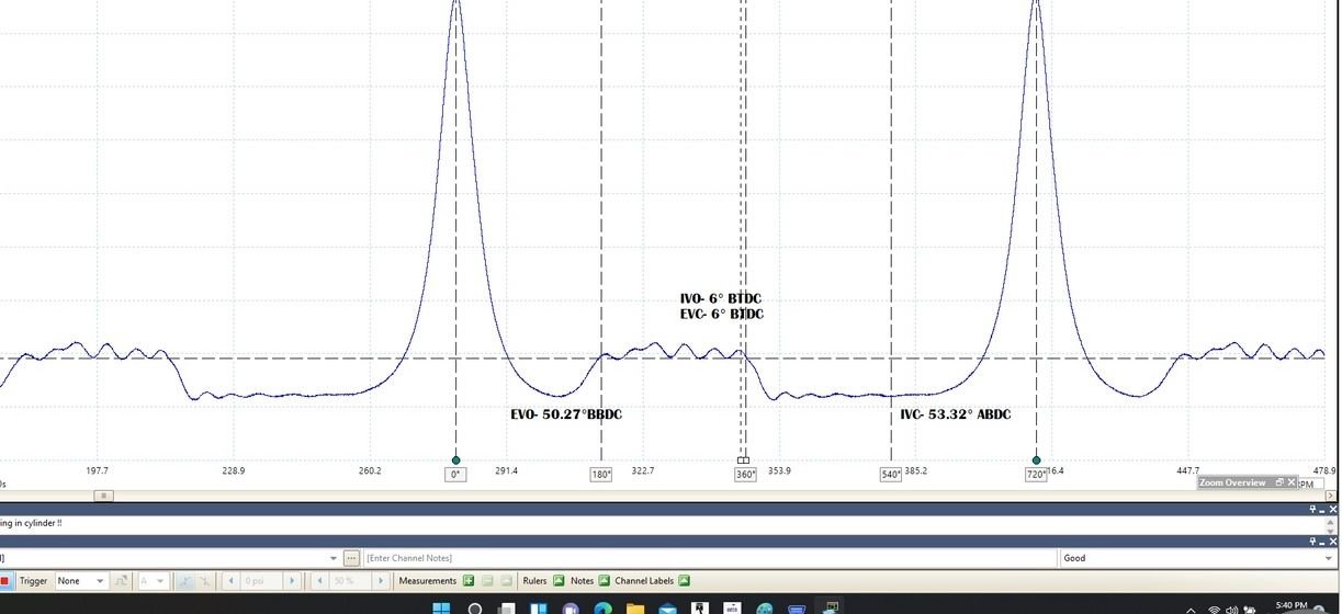

As far as compression you look OK…now as far as a compression test that lets you know the cylinders ability to seal…doesn’t tell you the cylinders ability to breathe…you can have an issue like say an intake valve that doesn’t open or a wiped cam lobe that can cause a misfire…I do advanced diagnostics with a pressure transducer in the misfiring cylinder where I can know in a few minutes if you have an internal engine issue without engine disassembly…unfortunately maybe 1 in a 1000 shops do this…and dealerships don’t do this testing either.
