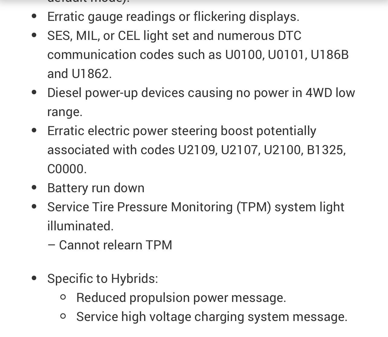

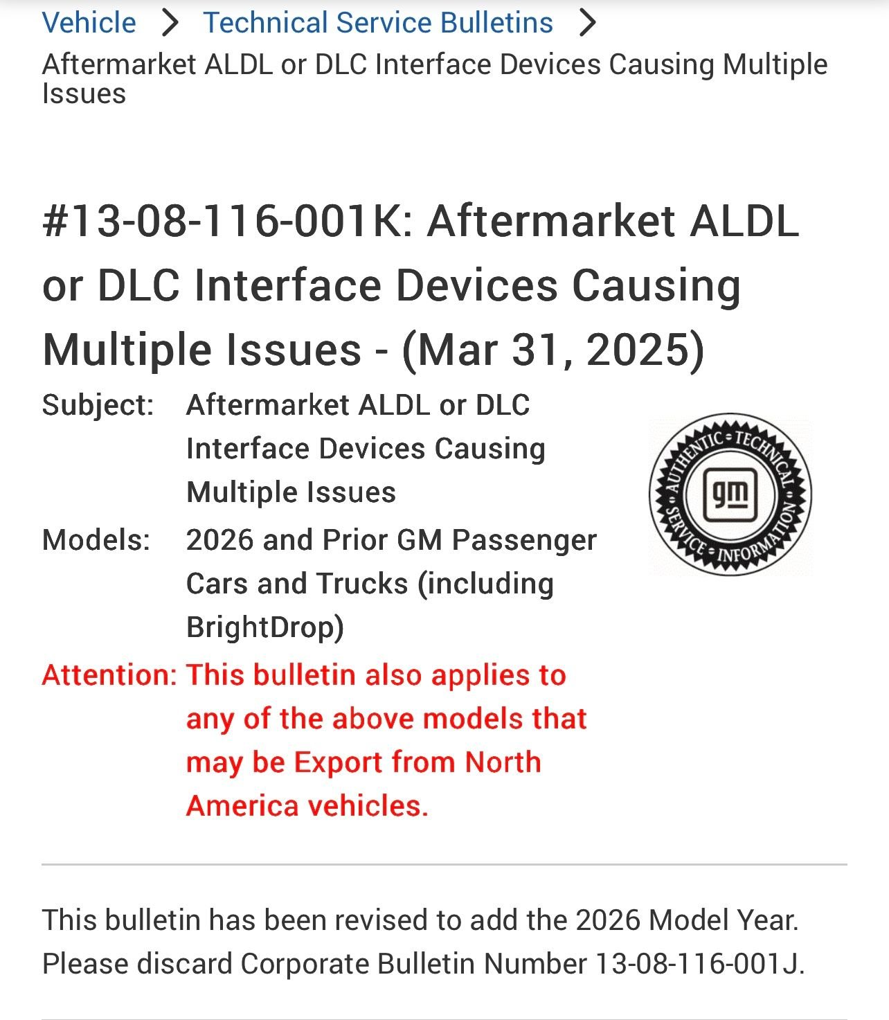

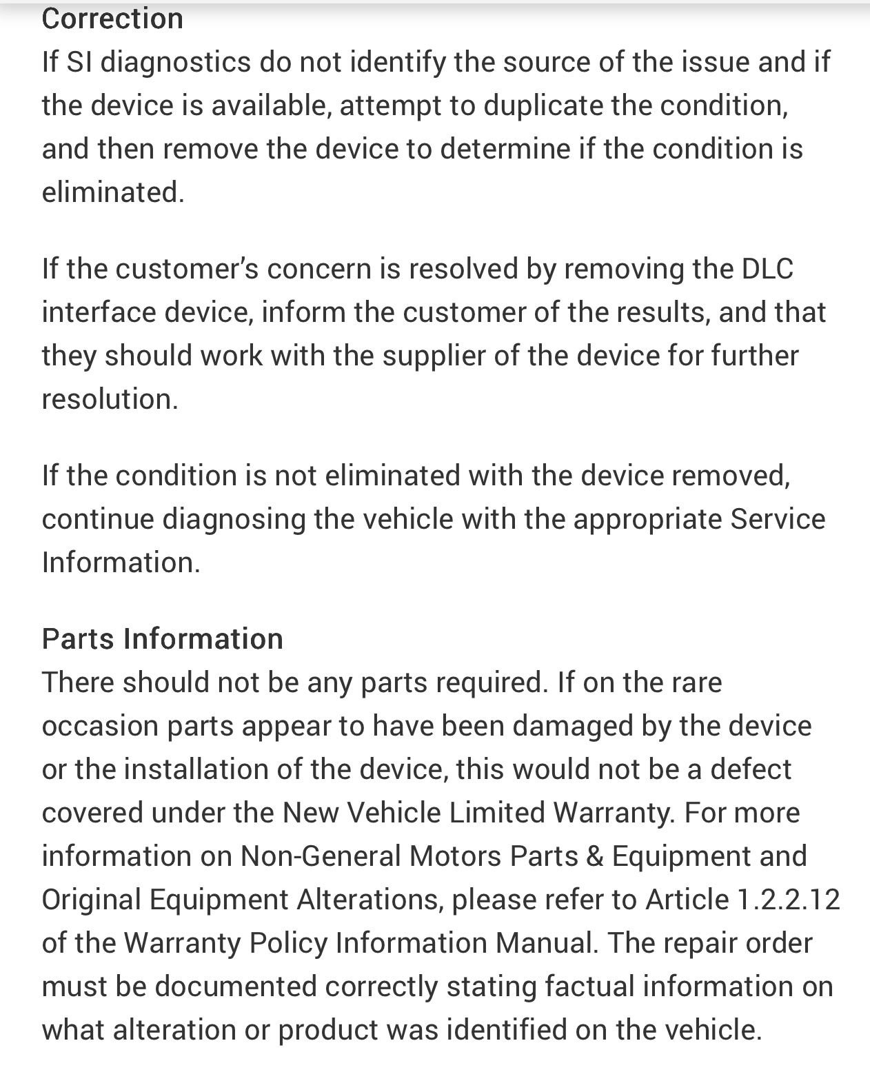

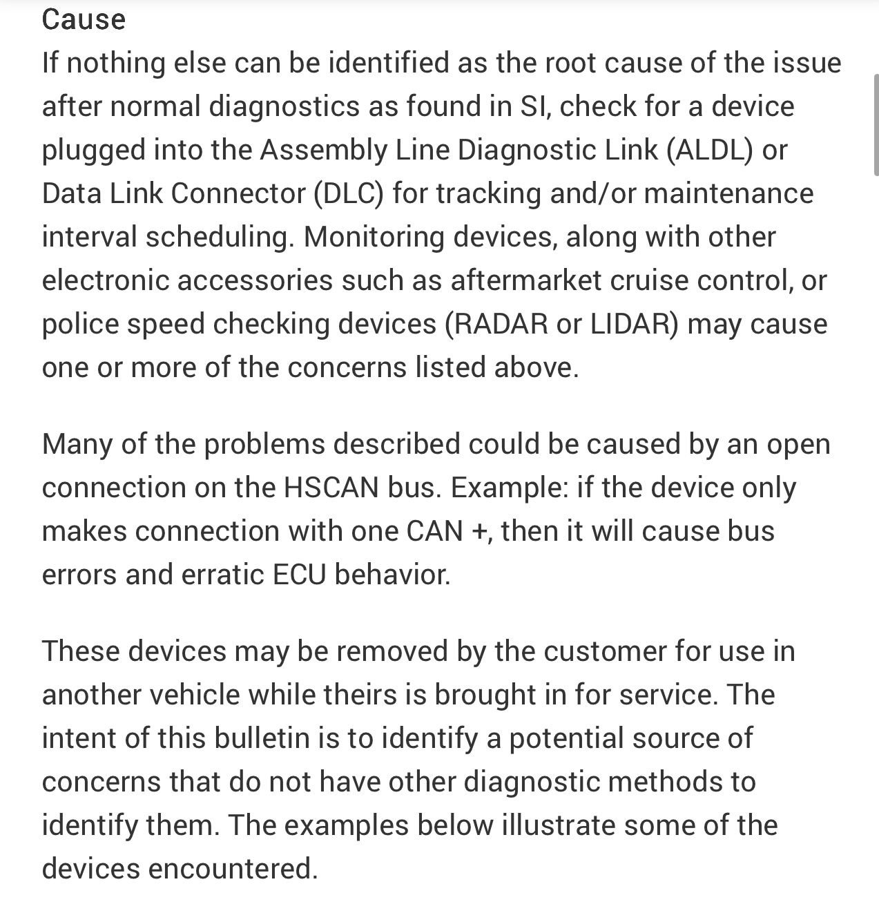

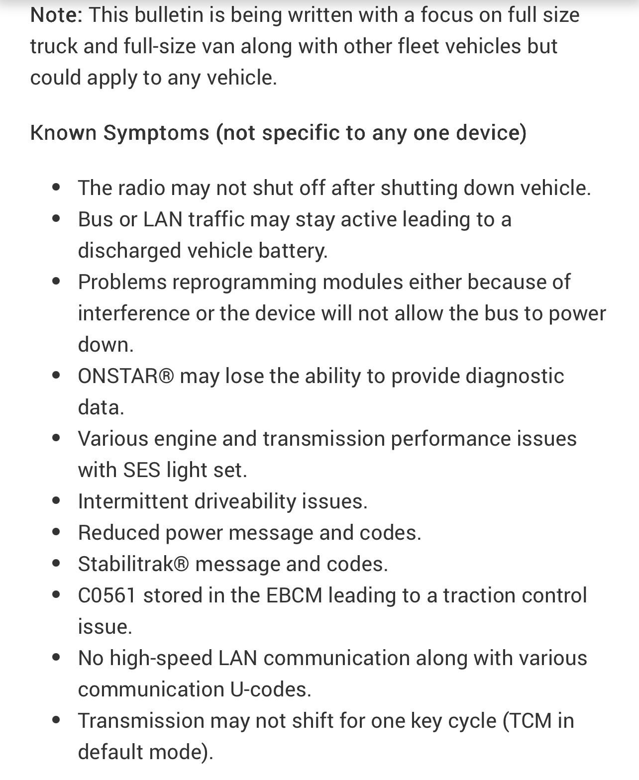

You really shouldn’t have this kind of “gizmo” plugged into the DLC permanently…there is a TSB below related to this !!

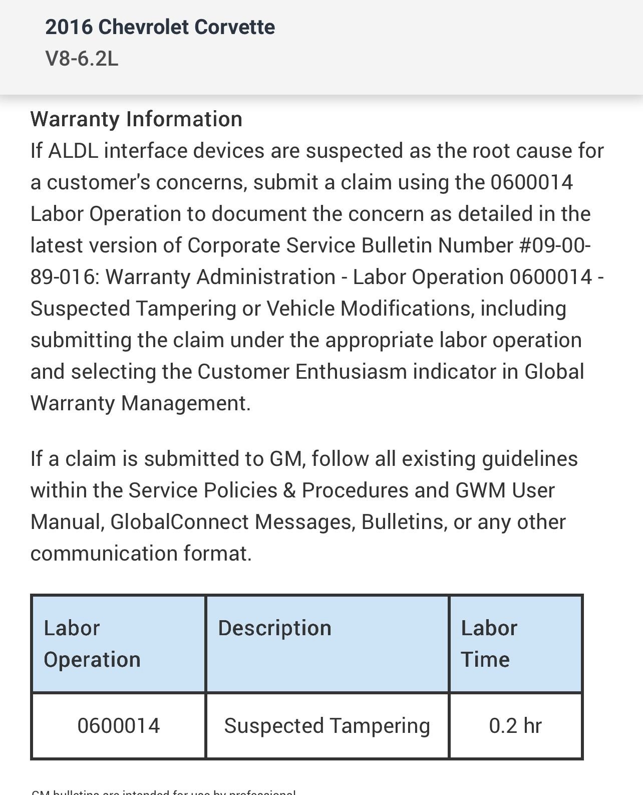

Dealerships usually don’t read their own TSB’s !!

My guess is that a "suspected tampering" note on my service record might be hard on my GM warranty.
