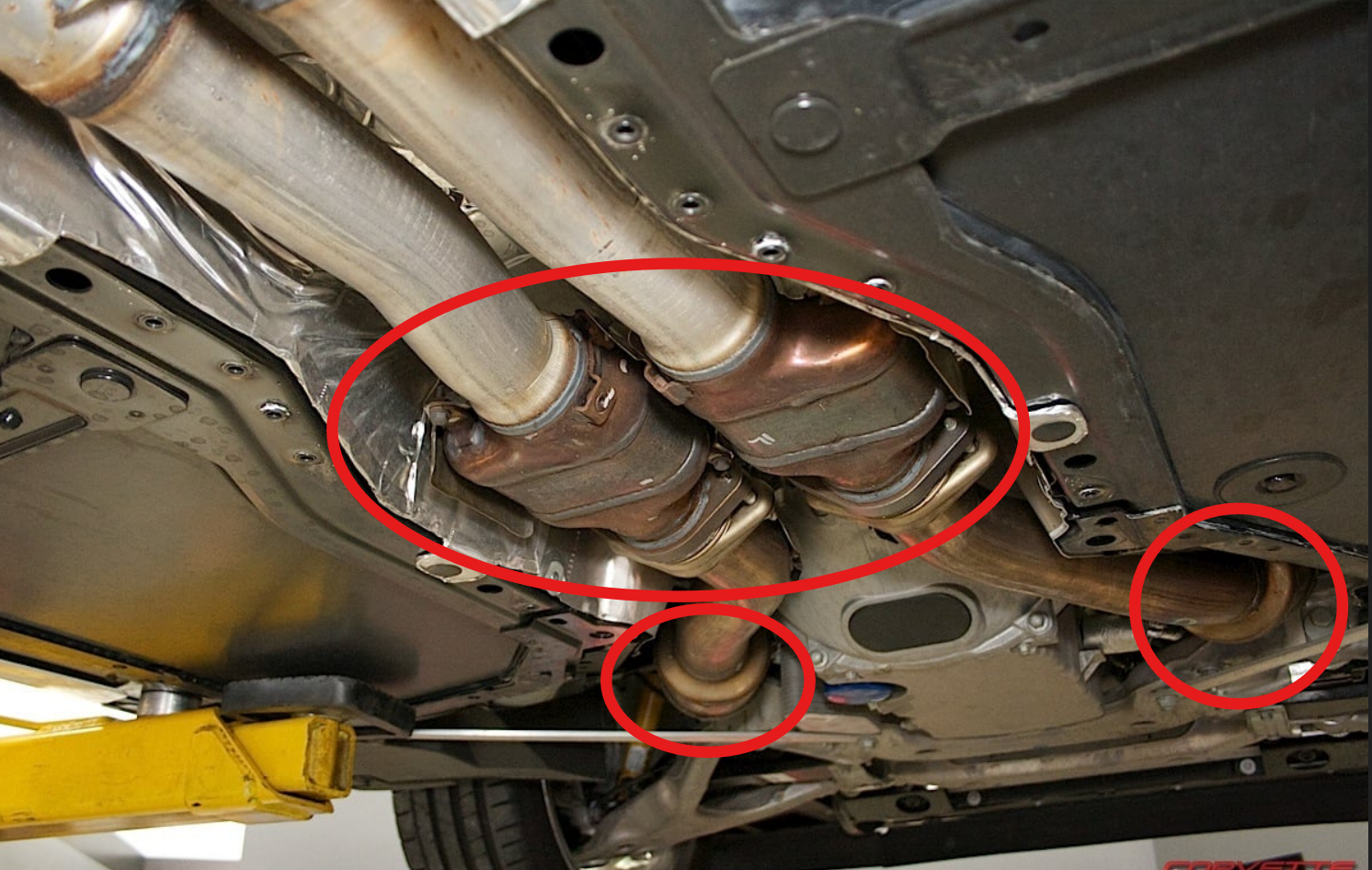

One set of cats are on the X-pipe. They are not hooked up to anything. You can replace the X-pipe with a catless x-pipe, recommended, just a bit more noise. The two cats up stream are a bigger issue.

Circled all four of them in the first pic below.
Unless you're doing headers it's asinine to remove the main cats if you're keeping the OEM manifolds. Those exact same factory cats support 650hp with the Z06.

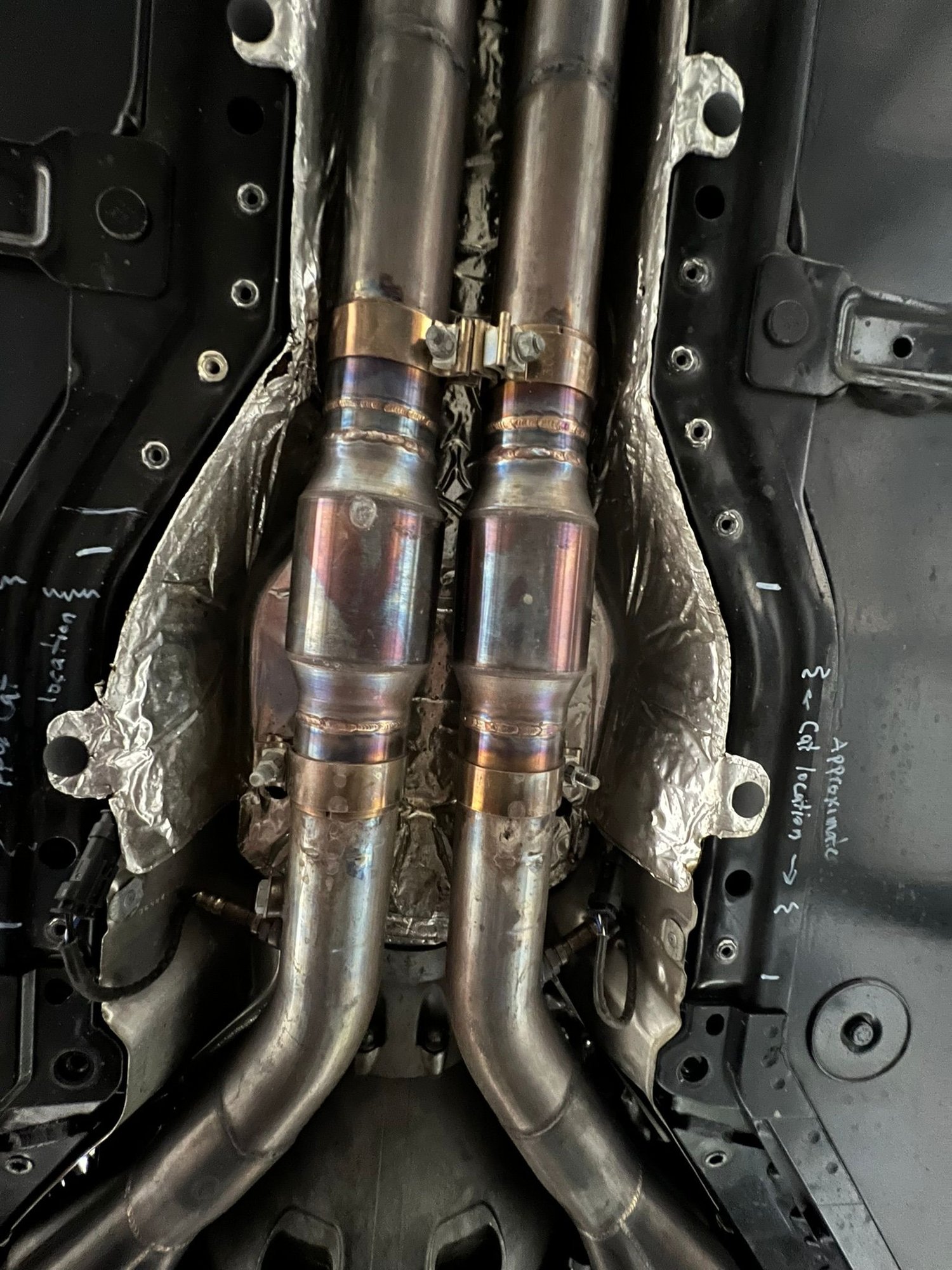

Even with headers, unless you want to smell like gasoline fumes when you get out of the car, you need to add bullet cats (second pic are mine). The BTR 220 is just large enough that the duration at idle will result in the smell.
I can tell you that with headers and bullet cats, when I fire the car.....even with the NPP exhaust set to "Tour" so the valves are closed....the neighborhood hears me. Once the engine settles down, it's much better but certainly louder than stock. When I have the NPP valves open, it's race car loud. Passing a sound station on track I was flagged for exceeding the sound limit of 103dB.
