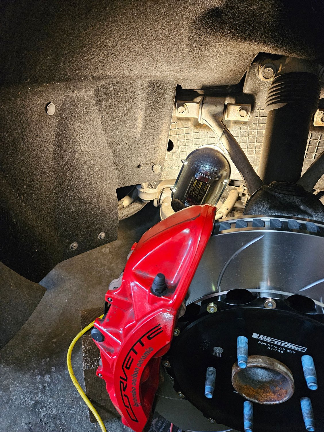

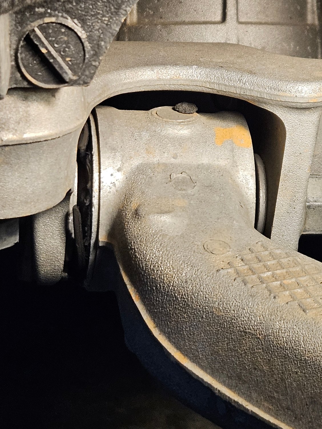

I was swapping my CCBs for Gyrodisc rotors and noticed some bushing damage. Curious how bad this looks? It's hard tell what the inside looks like obviously, the car is 9ish years old.
Nothing feels loose when driving.
2016 Z06 + Z07 package.

If it's not making noise and there is no play, I wouldn't worry about it.
New lower control arms are pretty much unobtanium. There are a few sites and some dealers where you can "order" one and then a week or so later you'll get an email saying they are unavailable. There is a less than equivalent aftermarket control arm, but I wouldn't use it. That leaves finding a used OEM a-arm or replacing all the bushings with aftermarket which are not rubber and will increase ride harshness if that bothers you. I have monoballs in mine and you feel them. Not horrible but certainly not plush and they weren't cheap.

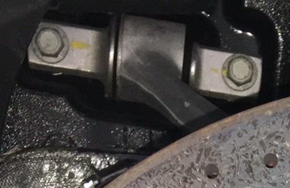

The real question is do they need to be replaced? Are you having handling problems? Does the alignment change? As far as I can tell from your pictures, the bushings appear to be in good condition. My experience with C5-C7 suspension control arms is they tend to slide forward or backward on the bushings, depending on how the load is applied. On my C5 the LCA bushings slid far enough to the rear that they rubbed on the cradle. GM changed the bushings somewhat to prevent that from happening on later cars (like my C6).
Here is what the front dog bone bushings looked like on a fairly new car back in June 2016. I happened to capture the front dog bones in some pictures I took of the brake rotors on a 2015 Z06/Z07 after several track events. The car would have had about 5K miles on it by then. The lighting isn't very good but maybe you can use a photo editor to zoom in and lighten the picture to see the condition of the bushings.
An indicator the LCA bushings may have slid to the rear is not being able to achieve the stock or greater caster settings. That is what tipped off the mechanic doing an alignment on my 97. He couldn't get more than 3 degrees of positive caster.

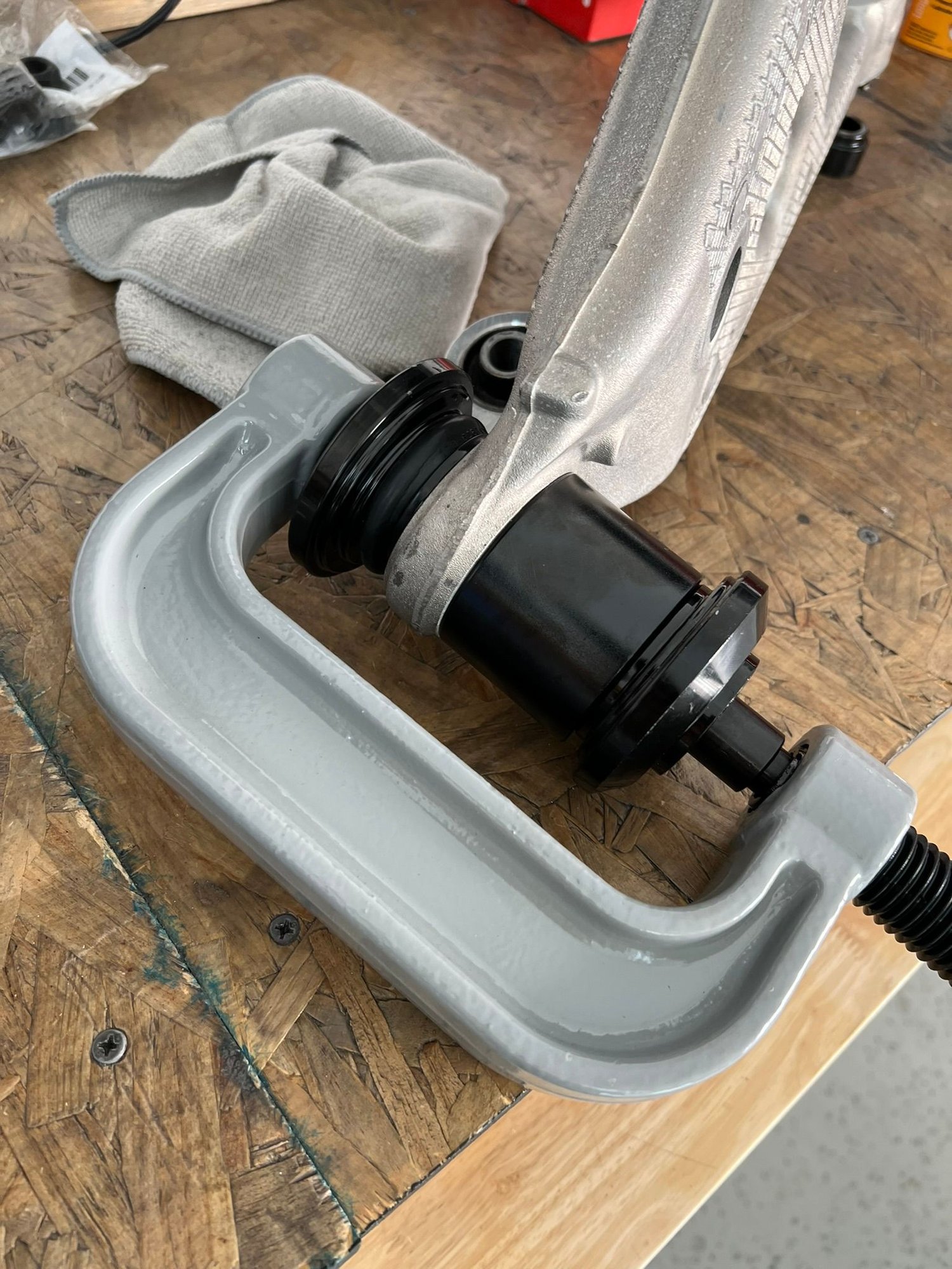

The main bushing damaged is the lower one, you can pretty easily see a tear in it, just not sure if it's "superficial" or not. I haven't experienced any ill effects driving yet. (the 2nd image shows it best)

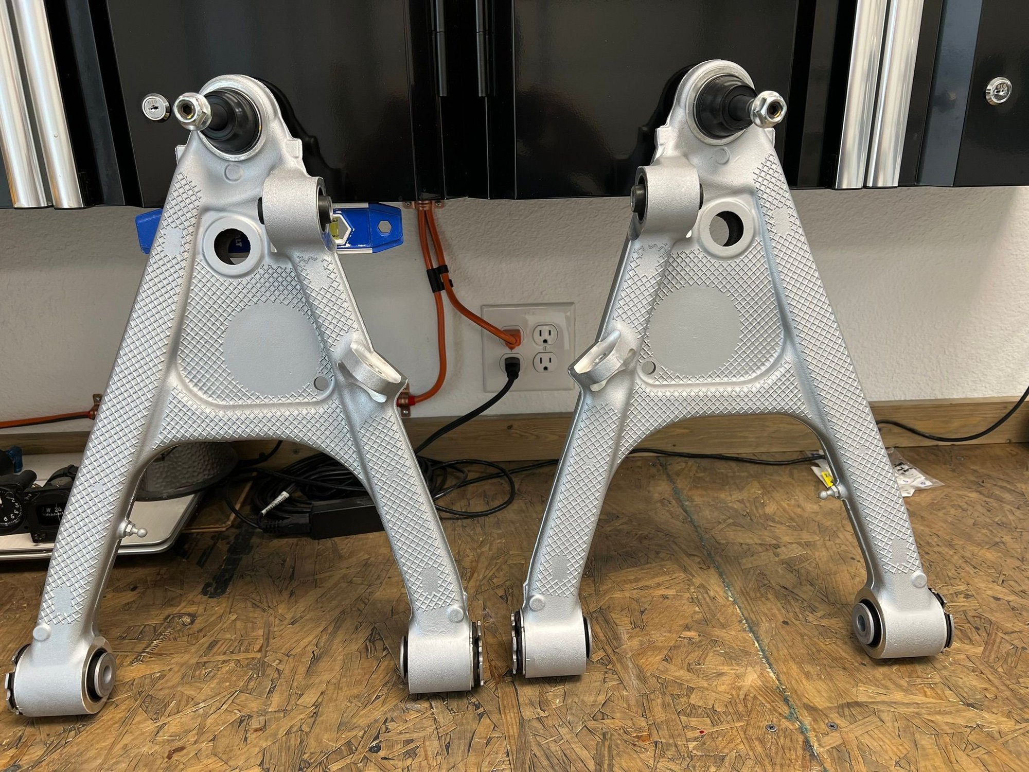

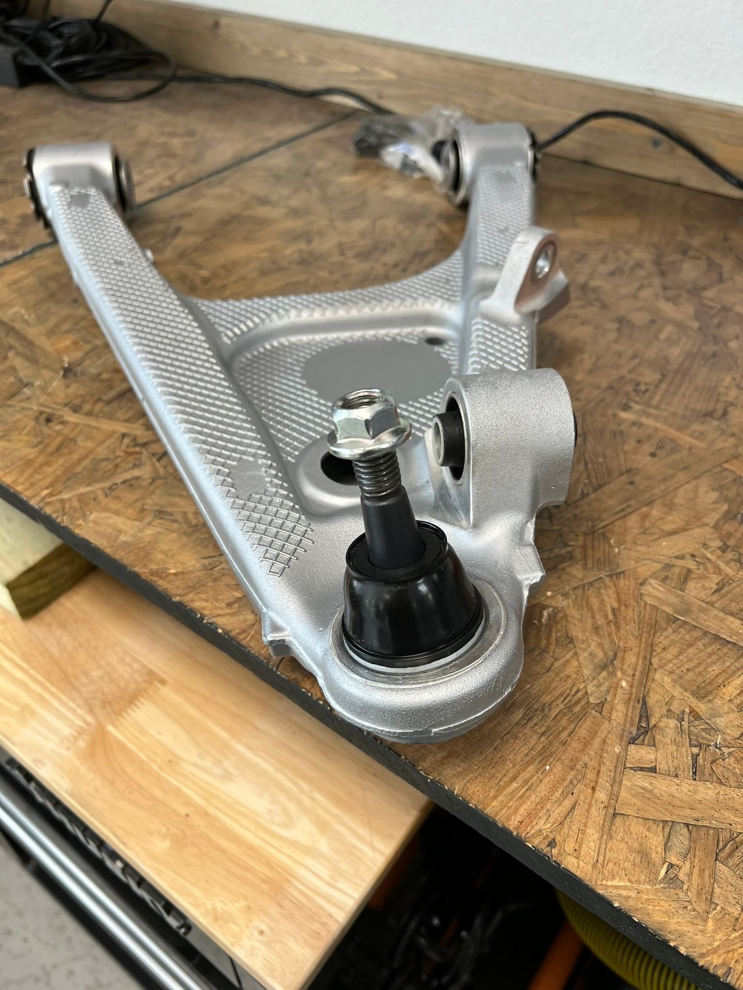

For when/if I ever go back to stock or close to it, I bought used arms, replaced the bushings and have them stored away. With a little bit of patience you can find them for $300-$500 although I think the sellers have caught on to them not being available. Most are low mile. Corvette drivers have an innate ability to go to a "Cars & Coffee", tell the Mustang drivers to hold their beer, and then proceed to crash their car. I bought a couple local via Facebook Marketplace, 1 via eBay, and another was probably the last new one I ever saw come up as available via RockAuto. I put new ball joints in the used ones.
Random pics...
