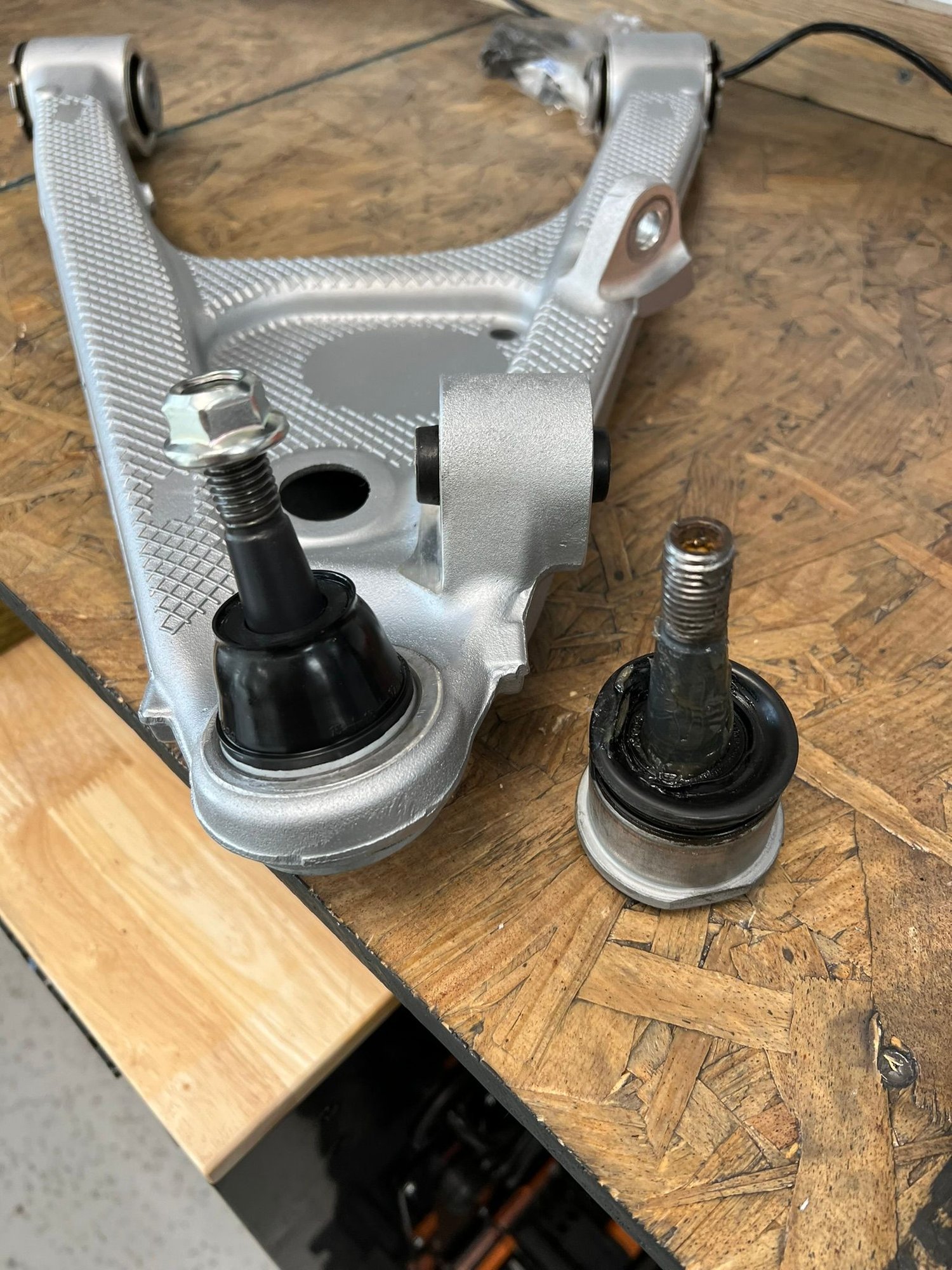

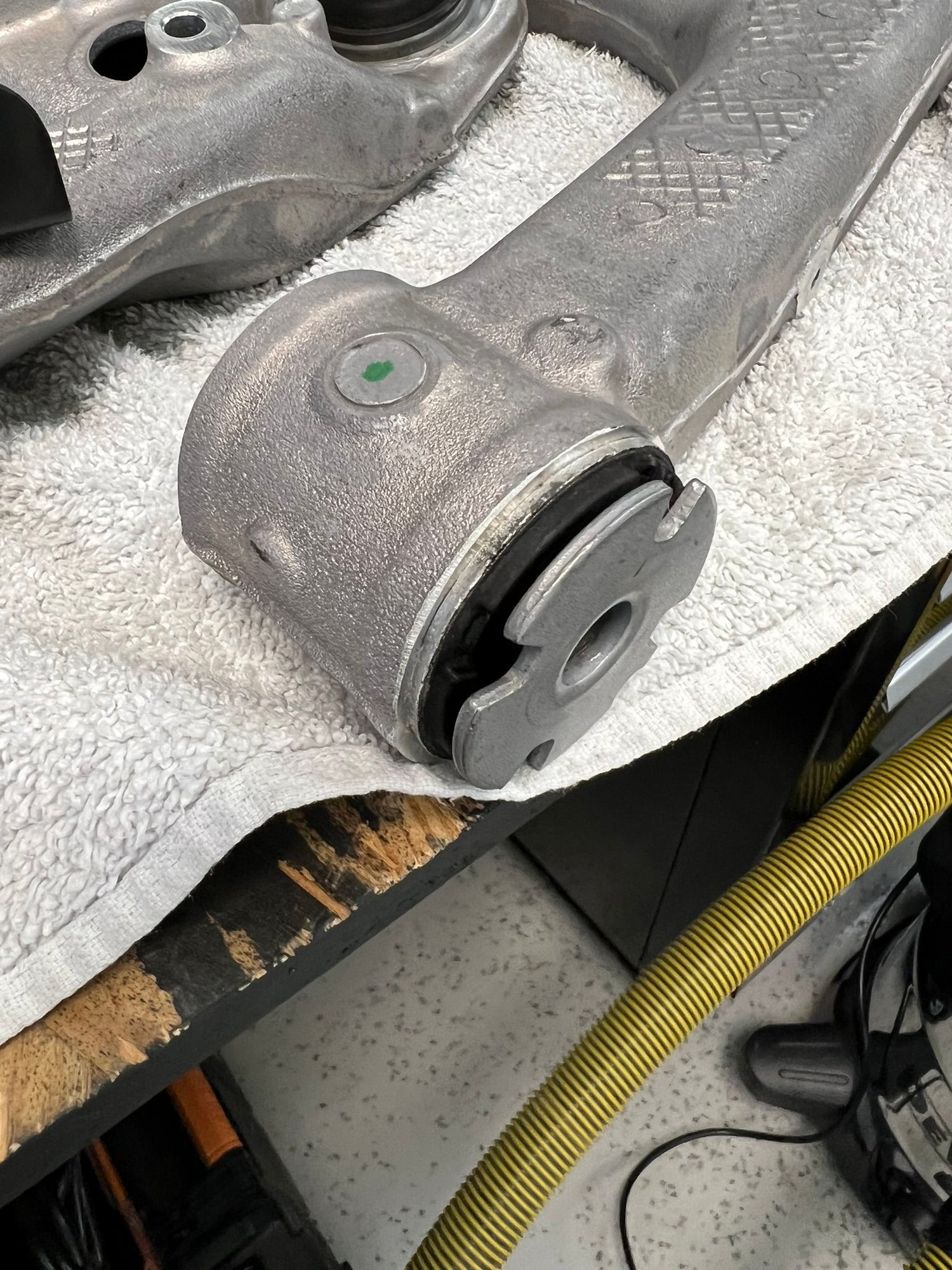

The below pic is one of my spare control arms and on a decent size screen you can see the outer shell. Lemme know if you need more pics to decide what you're getting into.
BTW....Mark at AMT was selling OEM ball joints so while it's apart, it may be worth changing those as well. Same ball joint front and rear.

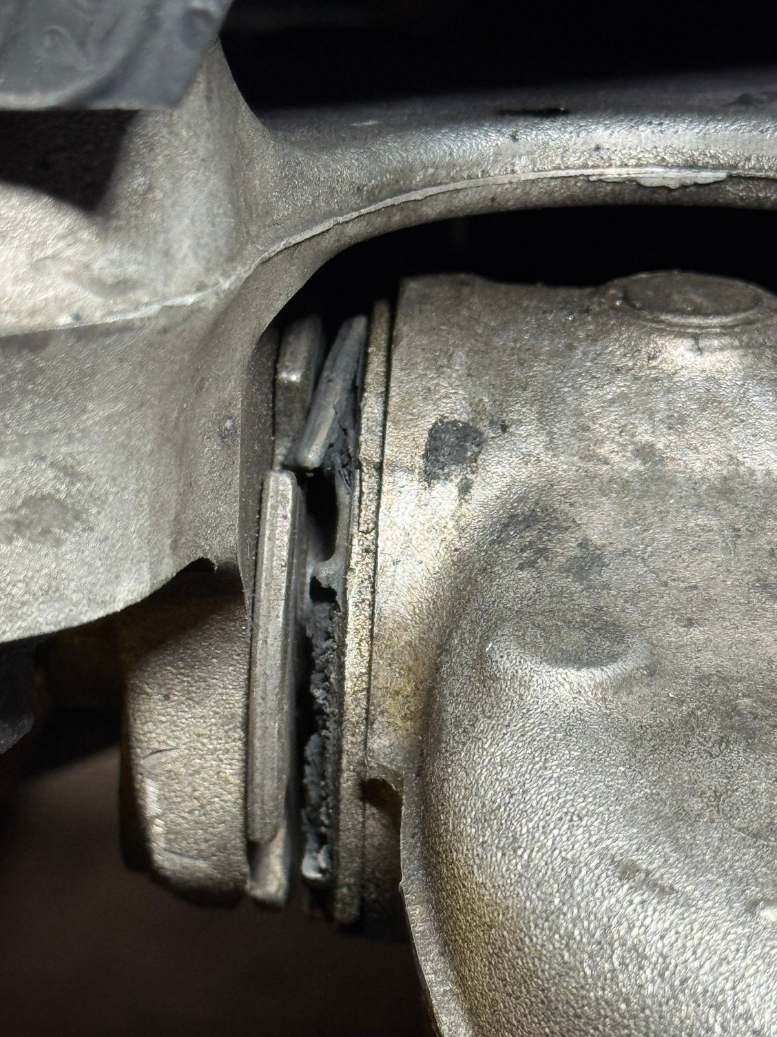

Here is a pic of one bushing needing replacement…

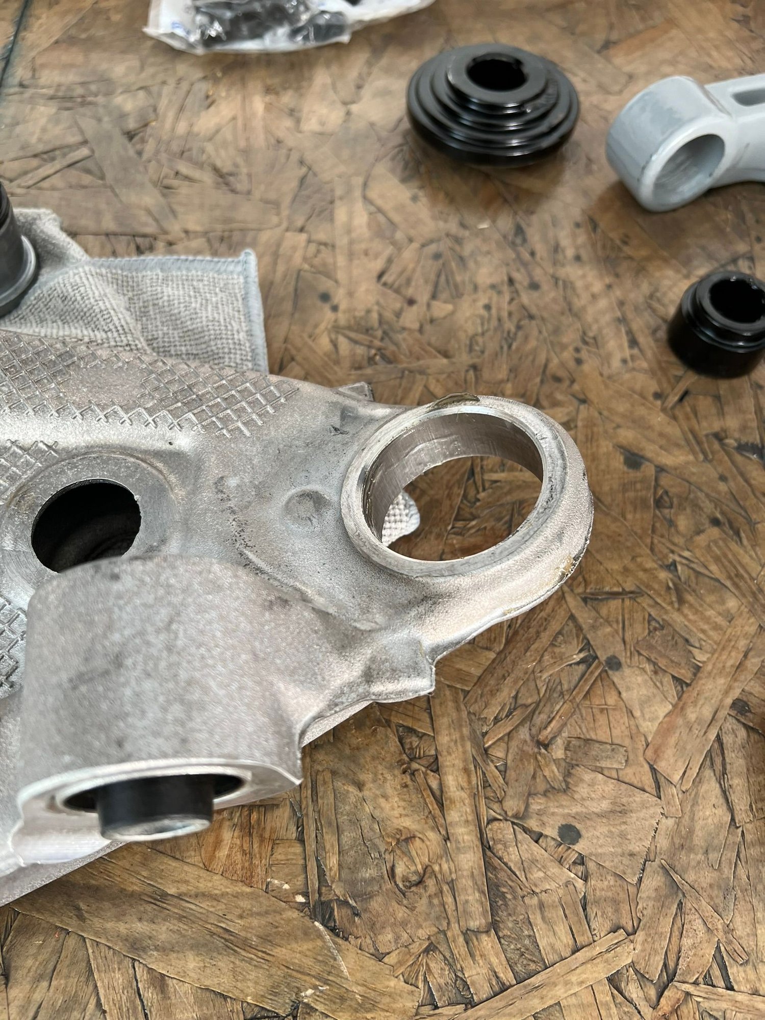

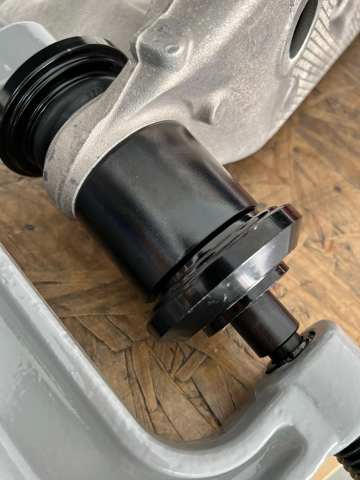

Quick update. I installed the AMT monoball CAs and I am pretty happy with the results. The install was easy and the additional control/feel gain on track is clearly noticeable. On the road, sure there is more NVH but it is not terrible, comfort was also not dramatically impacted (and I live in SoCal where we may have the worst highways in the country).
Also, shoutout to Mark @Mark@AMT Motorsport . Excellent customer service and very responsive!
