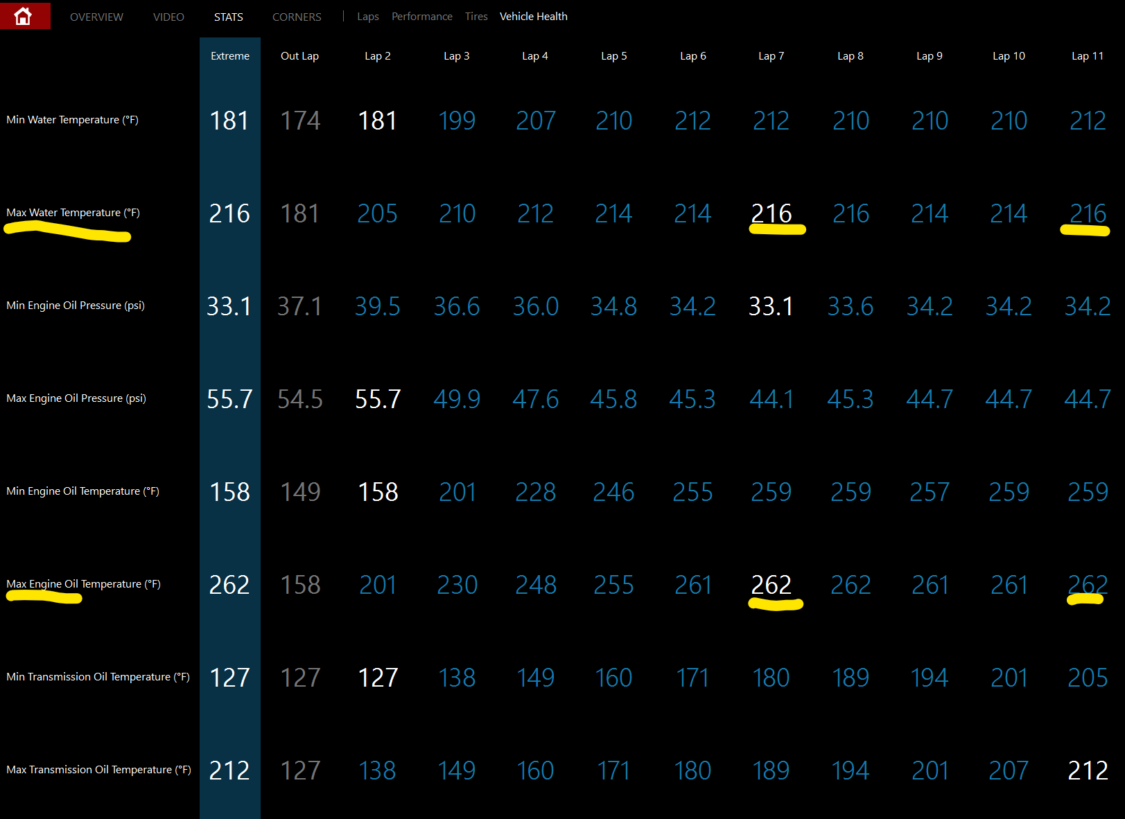

Your water temps are quite high. Airflow to the radiator is partially blocked by an intercooler?
Below are my temps this weekend. >100* outside air temp, ~20 minute session on track. OEM thermostat. I do have a larger radiator but 20 minutes on a race track in 100* heat is a lot more stressful than a highway drive in the upper 80s
