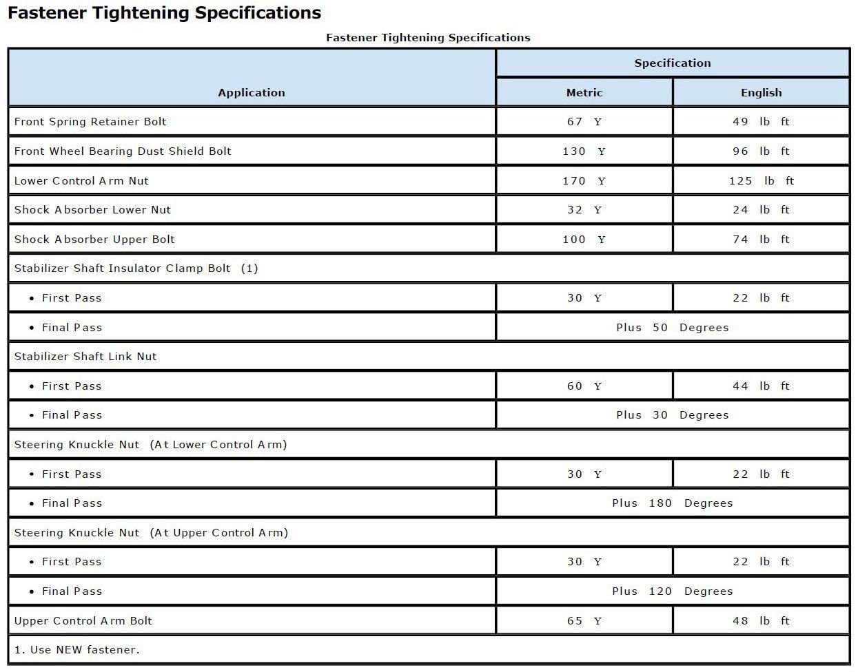

making a torque list for the engine im in the process of doing. if anyone has these specs and would be willing to share I would appreciate it
1. upper control arm bolts
2. upper shock mount bolts
3. sway bar bolts
4. power steering rack mount bolts
5. torque tube to flywheel bolts. and are these stretch to yield ?
6. bellhousing bolts
7. header bolts
any and all help is appreciated!!

I have saved this;

much appreciated!! looks like upper control arms require new bolts so I can order those.
