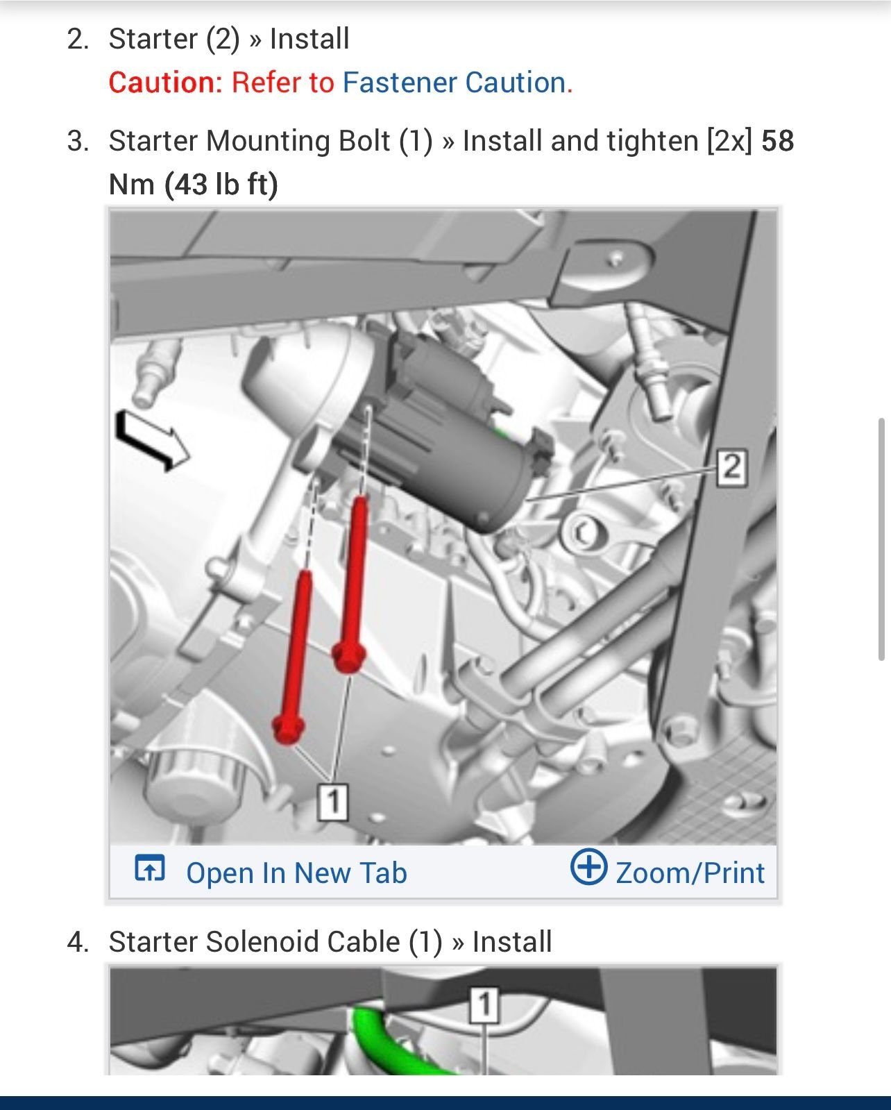

Nothing in Service Information mentions a shim…if needed it would mention it.

Yeah I didn’t see anything in all data about it either.

From: Cape Coral, Florida
This is from Alldata.
