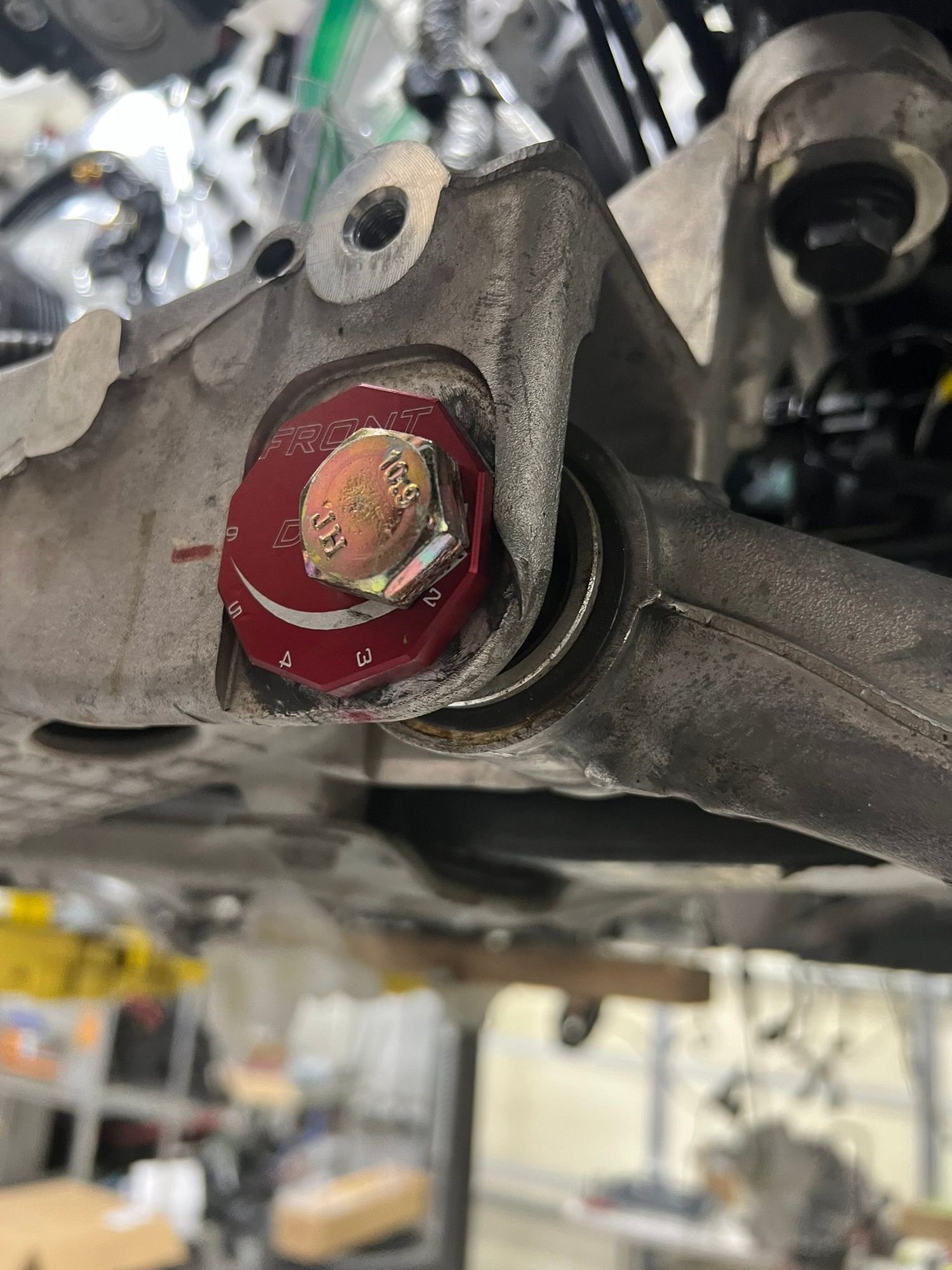

Went to align my car today and it appears that a prior tech absolutely mangled one of my front eccentrics, somehow threading the bolt right through the plate, and I am going to go ahead and replace them all with OEM in the off season. I just wanted to confirm - are all 8 eccentric bolts/plates the same and interchangeable? I found P/N 11611443 for the bolts and 11611444 for the plates, but half of the websites state that they are for rear. Before I order I want to make sure they are correct for the fronts as well.

Also the slot in the cradle is damaged, so I guess I'll be replacing the whole engine cradle, and, as long as I'm in there, might as well do the monoballs that I've always wanted and the Hinson motor mounts. Sigh.

There should be two slots in the cradle for each bolt. One is on the rear of the cradle control am mount and the other is on the front of the mount. The bolts have two eccentrics with one fitting in each slot. Depending on how badly damaged the slot you are looking at is, the eccentrics may still hold when torqued to the proper value.

This is a good time to upgrade to AMT's octagonal (?) eccentrics.
C7 Corvette Adjustable Camber Kit | AMT Motorsport - AMT Motorsport
You get close w/ the eccentrics and fine tune w/ the shims. A nice part of this is they have a chart that tells you how much the camber will change for each shim thickness.

....and the alignment will never move again. Good stuff. To the OP.....if you go this route, you get what you pay for. There are cheaper knock-offs but with much poorer quality.
