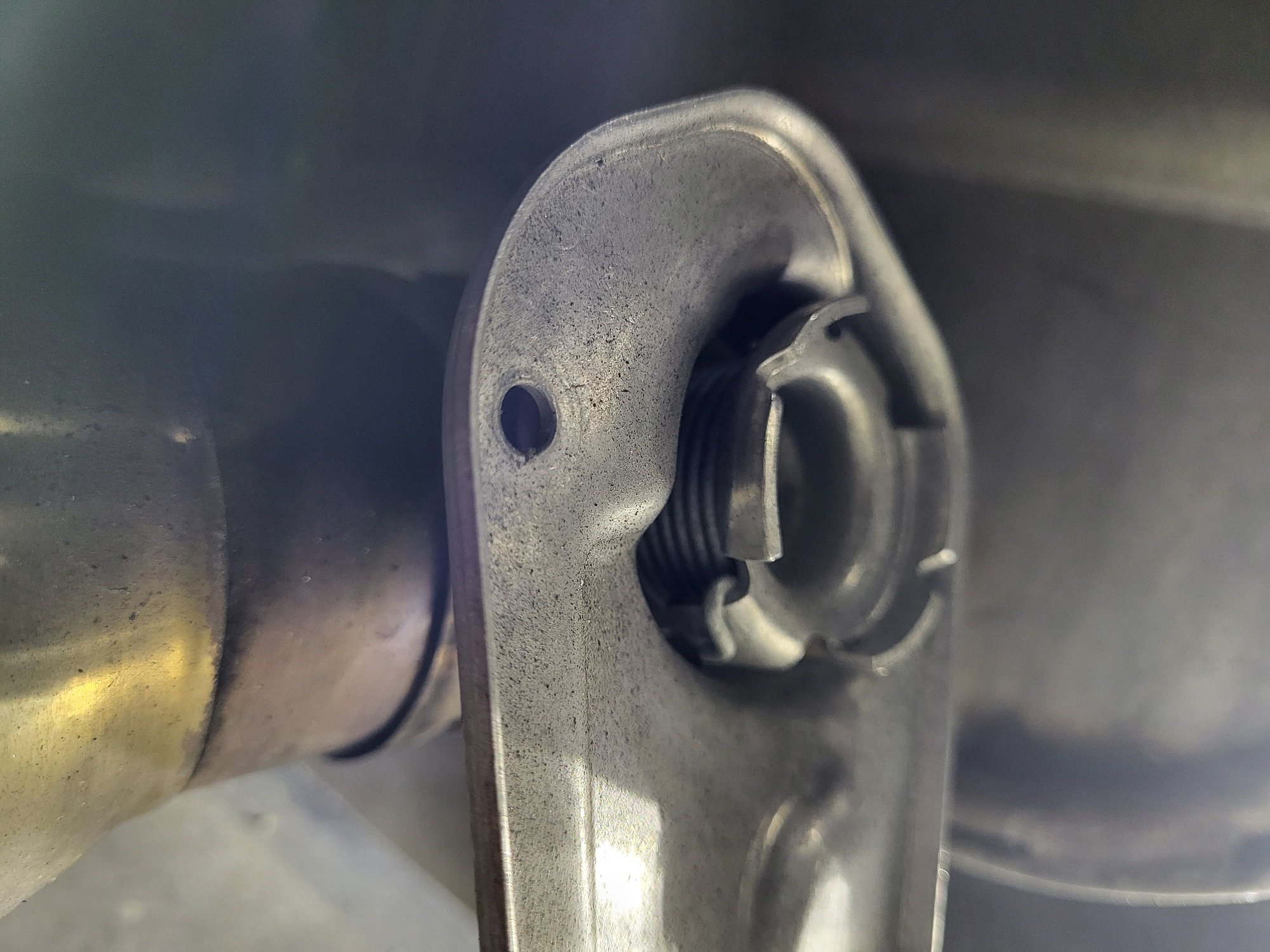

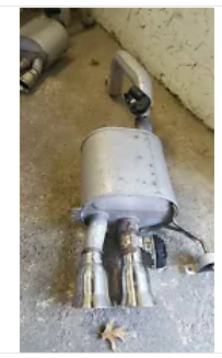

No you don't need actuators. I did exactly what you want to do. Here is a shot of mine w/ the actuators in place.
Here is a closeup of the pipe w/o the actuator. Sorry about the size. This forum doesn't allow me to resize like others do. I have been running w/0 the actuator for 4-5 years.
Okay great, that definitely simplifies things. Thanks!
