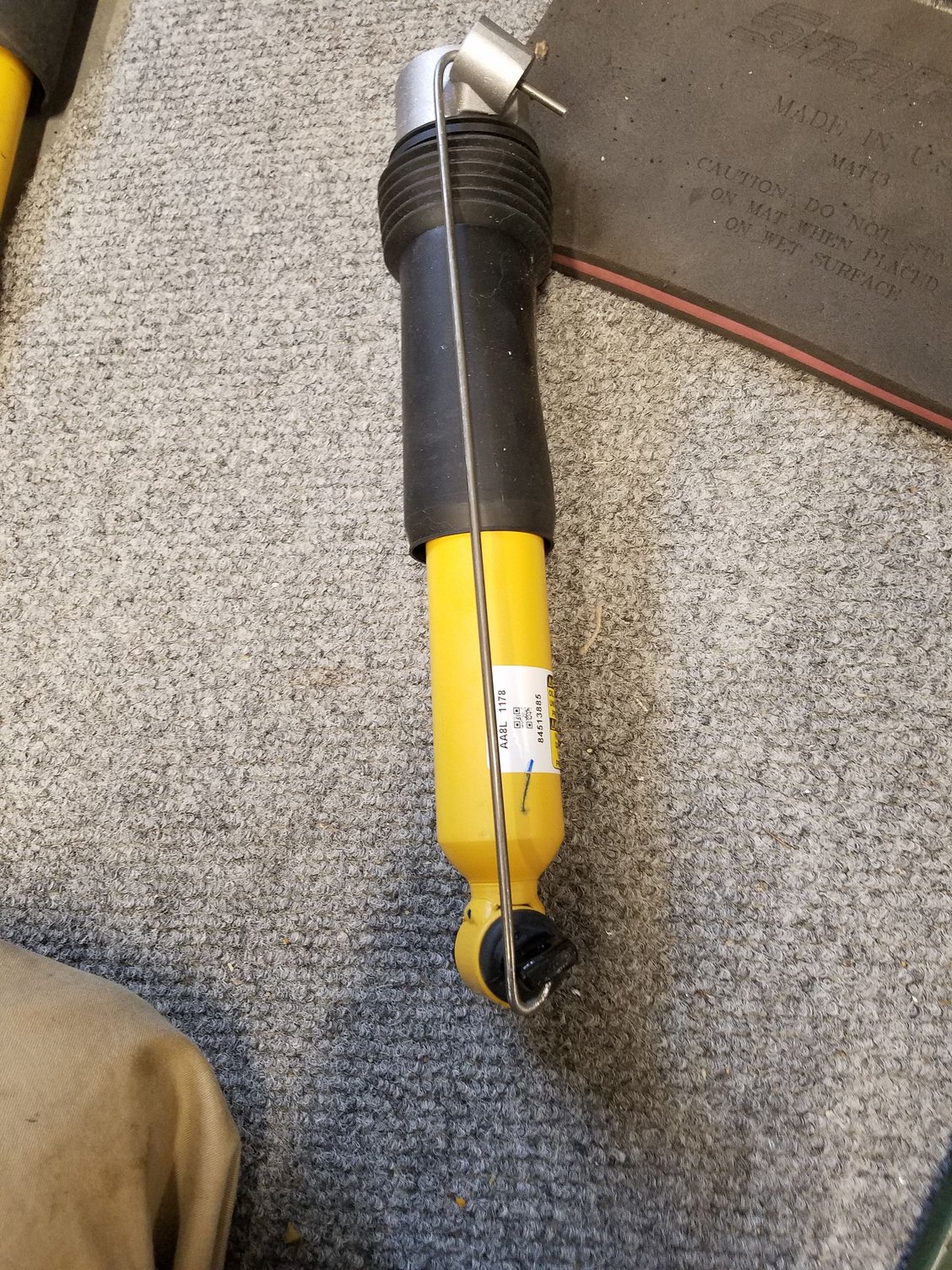

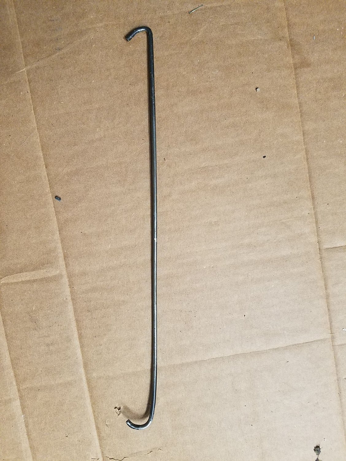

If you decide to swap shocks make a tool like this from 3/16" or 1/4" steel rod.
I get the shock bolts out top and bottom but then you can't get the shock to come out between the control arms because the gas pressure extend it to full length.
So I work it to a slightly different position, get one end of the tool hooked, compress it by hand to get the other end hooked. Looks like this and now it is short enough to get out of the car.
Note the top of the tool is it's original long configuration. Not long after I took this pic, that end was shortened as in the first pic. I put Z51 bars on first on my 19 Stingray which really reduced body roll. But the rear of the car still had a float I didn't like. It happened on an interstate type road at 65-70 when there was a bridge in the middle of a curve and they never get the road surface to perfectly match the bridge. The shocks took care of that.
Thanks Craig but I wasn't planning to swap the shocks as I like the softer ride the standard Stingray provides compared to the Z51 I have currently. What I don't like is the "sloppy" cornering which the sway bar upgrade you've suggested will hopefully overcome. It's just a case of choosing the best one for me?
