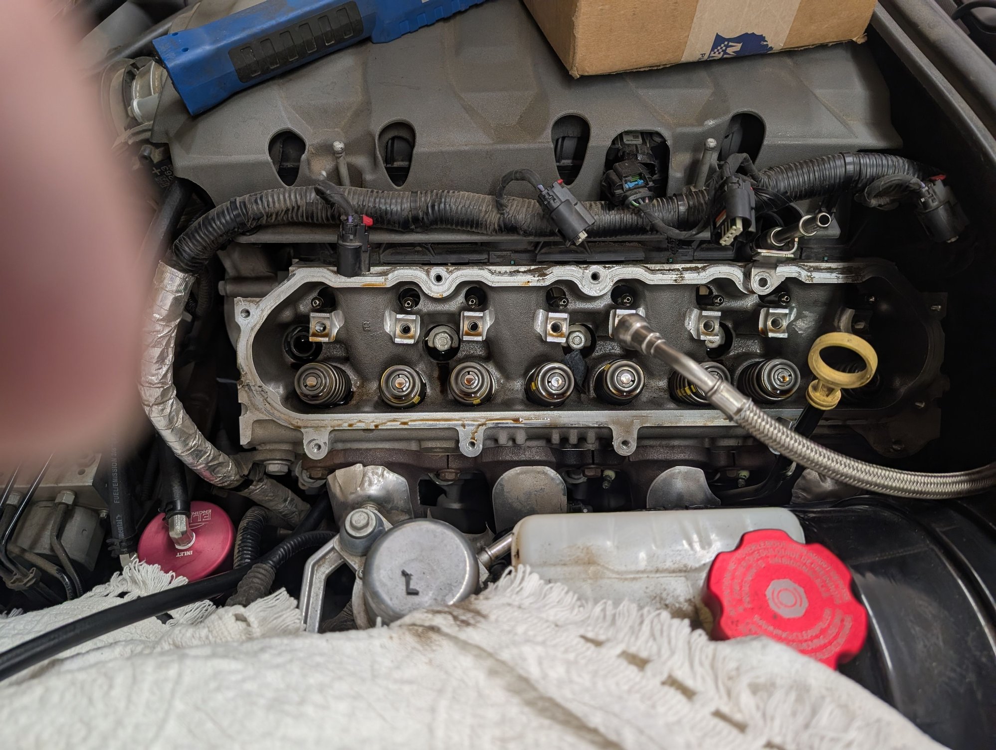

Driver side almost ready to pull the springs. I was surprised how clean it is. The rods look very clean.

From: Loveland
I tested the air hose hooked up to cylinder 1, all I got was air bypassing the valves. Obviously, the piston needs to be in a specific position. I get the correct wrench today to adjust the crank position. The piston needs to be on the power stroke with both valves closed. Looking at the pushrods, both would be full down.
Correction, DUH. With the rockers off, all of the valves are full up. But I did get the piston at TDC to keep the valves from falling into the engine.
That engine does look really clean inside.
Can you tell us how many years/miles, and what oil and change intervals you use?
Thanks.

Yes, obviously the Valves need to be closed when we insert air into the cylinders before changes springs!...
