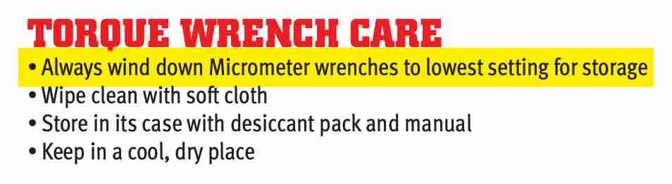

Originally Posted by Gearhead Jim
That's the common understanding with mechanics, and I do it.
But the common understanding is that pistol mags where the spring is under compression, can be stored for decades without any degradation. Lots of real world examples to verify. What would be different about the spring in a torque wrench?
The following is a copy-paste from the "Snap-on Torque Wrench 101" documentation:
Old May 17, 2026 | 03:50 PM
Gearhead Jim's Avatar
Gearhead Jim
Joined: Sep 2000
Posts: 25,029
Likes: 2,719
From: Far NW 'burbs of Chicago
St. Jude Donor '13
I agree that's the "official" way to do it, and that's the way I treat my two wrenches.
But there is a long history of of gun magazines being fully loaded for years or decades without problems, and spring engineers tell us that it's cycling (repeated loading and unloading) of springs that degrades them, not constant compression.
I'm trying to understand the difference.

This is a torque wrench and not a gun magazine. It requires an accurate spec.

likely nothing but people will be adamant that there is
The material property of a spring in compression is torsion, and obviously the wrench won't let you get anywhere near the yield point.
-So saying leaving it under slight torsion is a problem would be an identical position to saying that if you don't jack your car up on blocks if you park it long term means
that you will ruin your coil springs that it sits on. Because they are partially compressed right?
-Or saying that if you park on un-level ground and your passenger side wheel suspension is compressed up while your driver side is drooping down that means
you will ruin your sway bar because it will be left under slight torsion while parked.
-Now think about your valve springs when you shut down an engine. Numerous ones will end up fully compressed. Some guys park their cars for 6 months.
Obviously someone saying either of those things would be ridiculous. All three examples are leaving the spring rod in torsion under storage.
Am I saying that a measuring device like a torque wrench does NOT need calibration. . . . .absolutely not. Two totally different issues.
