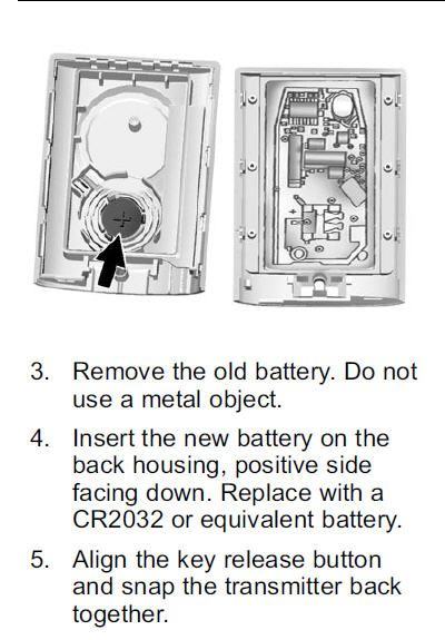

See pic for correct battery orientation. The POSITIVE side of the battery has the printed part number...
