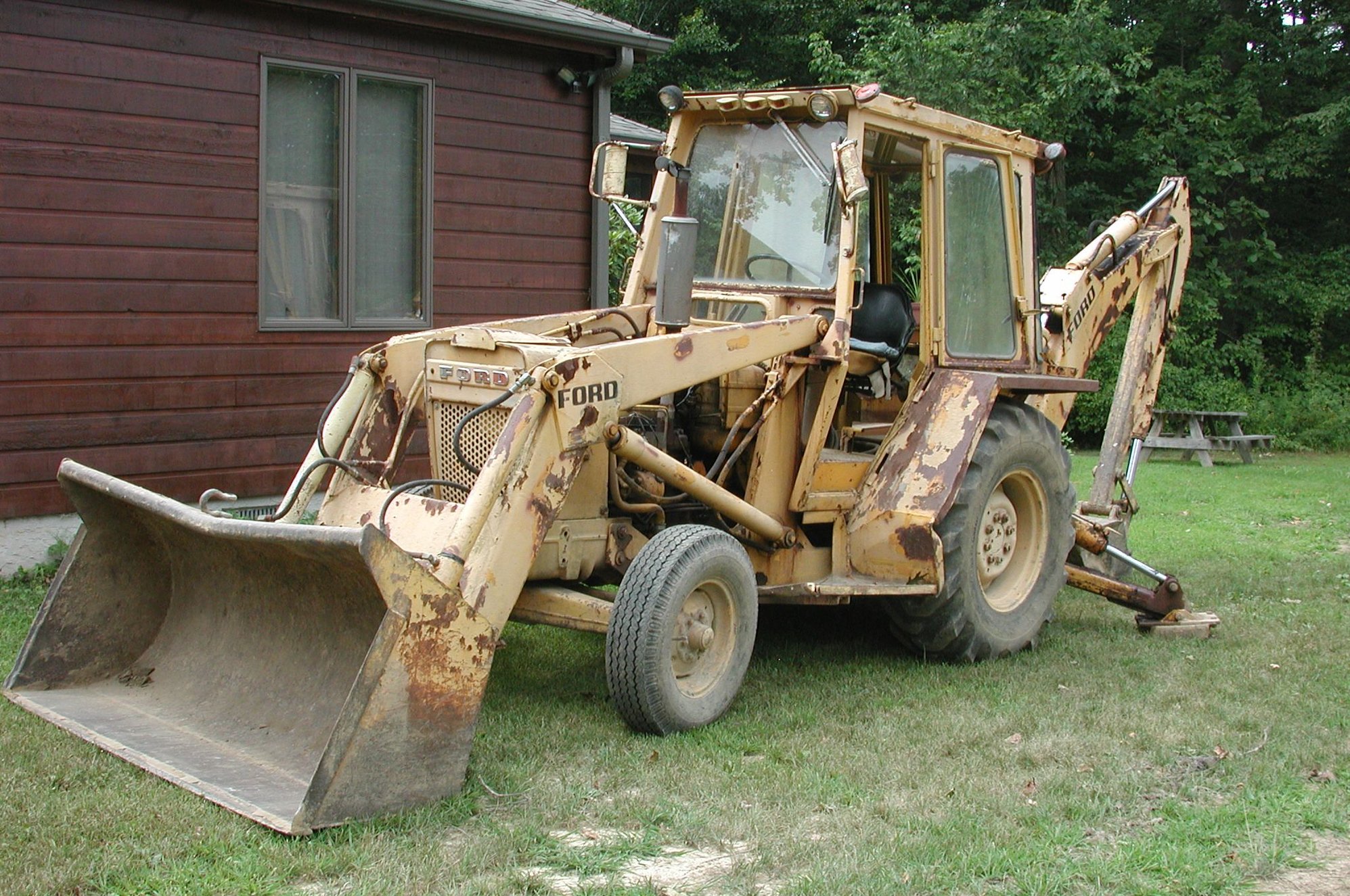

Seems too simple. But then it must be the heat at the cylinder. I've had a couple of old backhoes. Pistons and seals everywhere. Constantly working in dirt, out in all weather. First one I had was a 1973 Ford 4500. Looked like hell. Probably had 17,000 hours on it. Fluid was clear.
