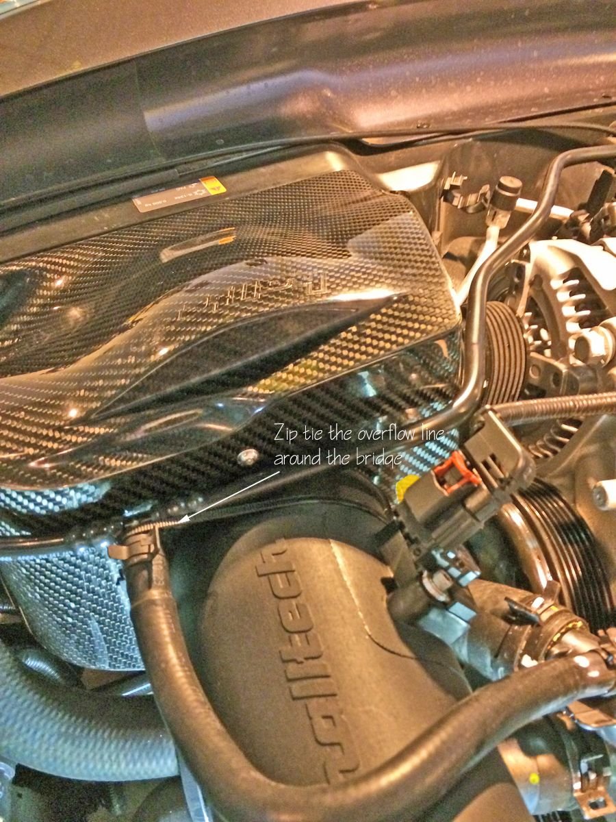

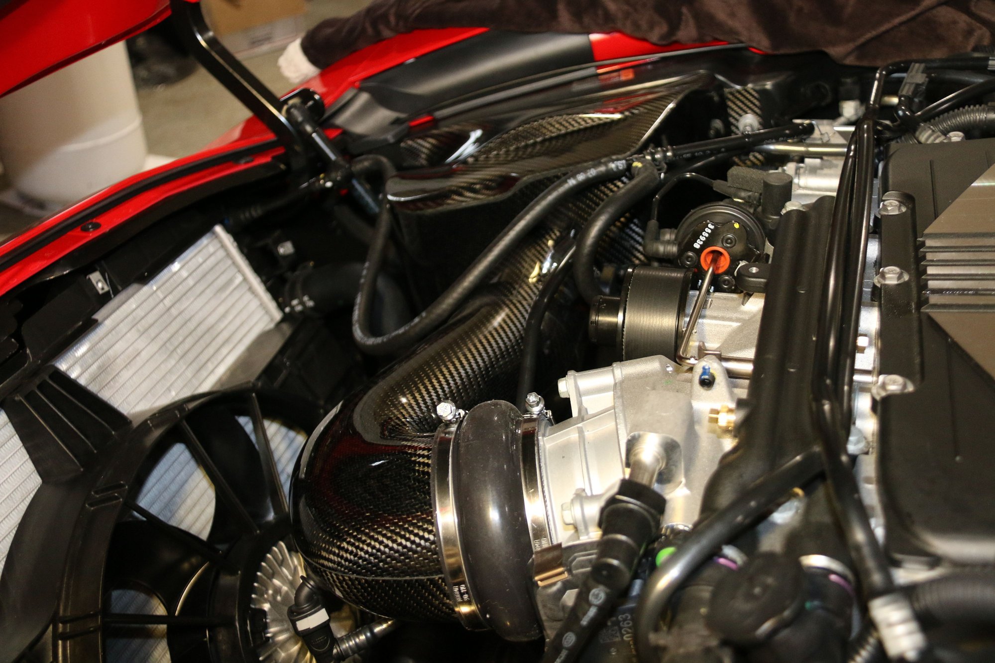

Originally Posted by sushisean
That coincides well with my latest theory, which is that by putting that T under the Halltech intake I installed I impacted how the cooling system works adversely. In hind sight installing the intake was a mistake. I took a perfectly working car that I had tracked many times flawlessly, and started experiencing problems immediately.
Sorry you have experienced what many other have experienced with overheating. I can see why you would think our intake is involved based on having no problems before it was installed.
The intake itself could not cause overheating, but you do need to check your coolant level. I had one customer with overheating directly after install, and he left his rad. Cap loose and lost 1 gallon of fluid. Blamed the intake. I told him to fill the tank after the car warmed up, and then shut it off and let it cool down. Finally after 1 day and 1 gallon, problem solved. You may have an air pocket as he did.
Having the line over or under makes no difference to the water. As it expands, it moves through the line to the expansion tank, then back to the radiator when it cools. You can run it over the intake if you like, it makes no difference:
The coolant line can be put over the intake. You could shorten the line by a few inches.
You can even use the stock setup as shown here. The reason for our longer line is to make the install easier and sano. I have personally installed a few who wanted the lines left stock.
Alternative coolant location
We have sold 350 C7 Stinger Hybrids,CKNs, Stinger-RZs and CKNZs since Feb 2014, and I am quite sure over the past 16 months other folks have raced their cars, and never any reports like this. GM purchased one in Feb 2014 and had us ship it to the Milford Proving Grounds for testing one would assume, and no negative reports. Chevrolet dealers all over the world have installed our Stingers, and only one other issue came up on the forum, where overheating was the result of a loose radiator cap. Without pressure in the radiator system, water boils at normal temps.
Jim

I have not seen this before. The T-fitting does not go under the intake, only the hose. As I mentioned above, the hose itself can be shortened and put over the intake bridge. Under is for sano freaks like me.
