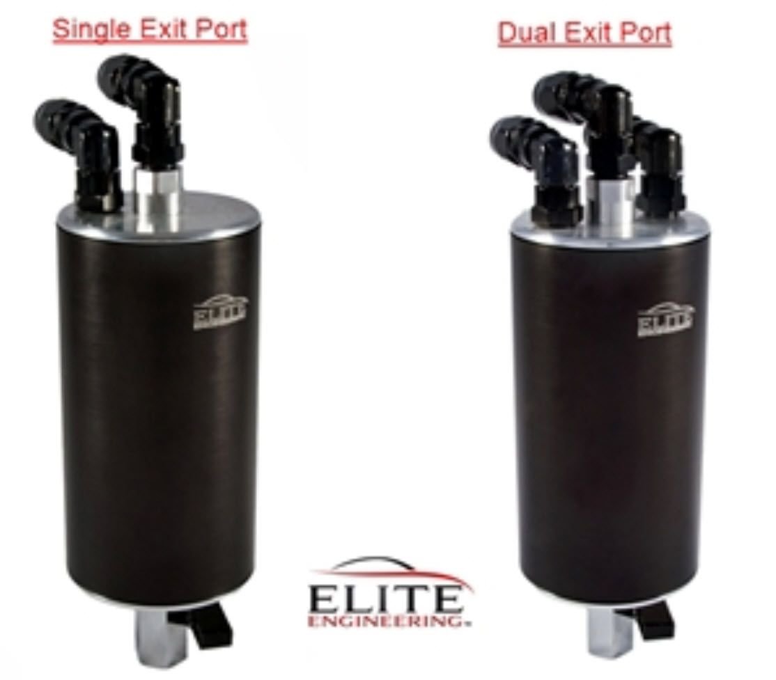

They just released a picture:
So should be any day I imagine!
Gee, could it look any more exactly like the Rx can? Not even a change in finish with the silver end caps....
