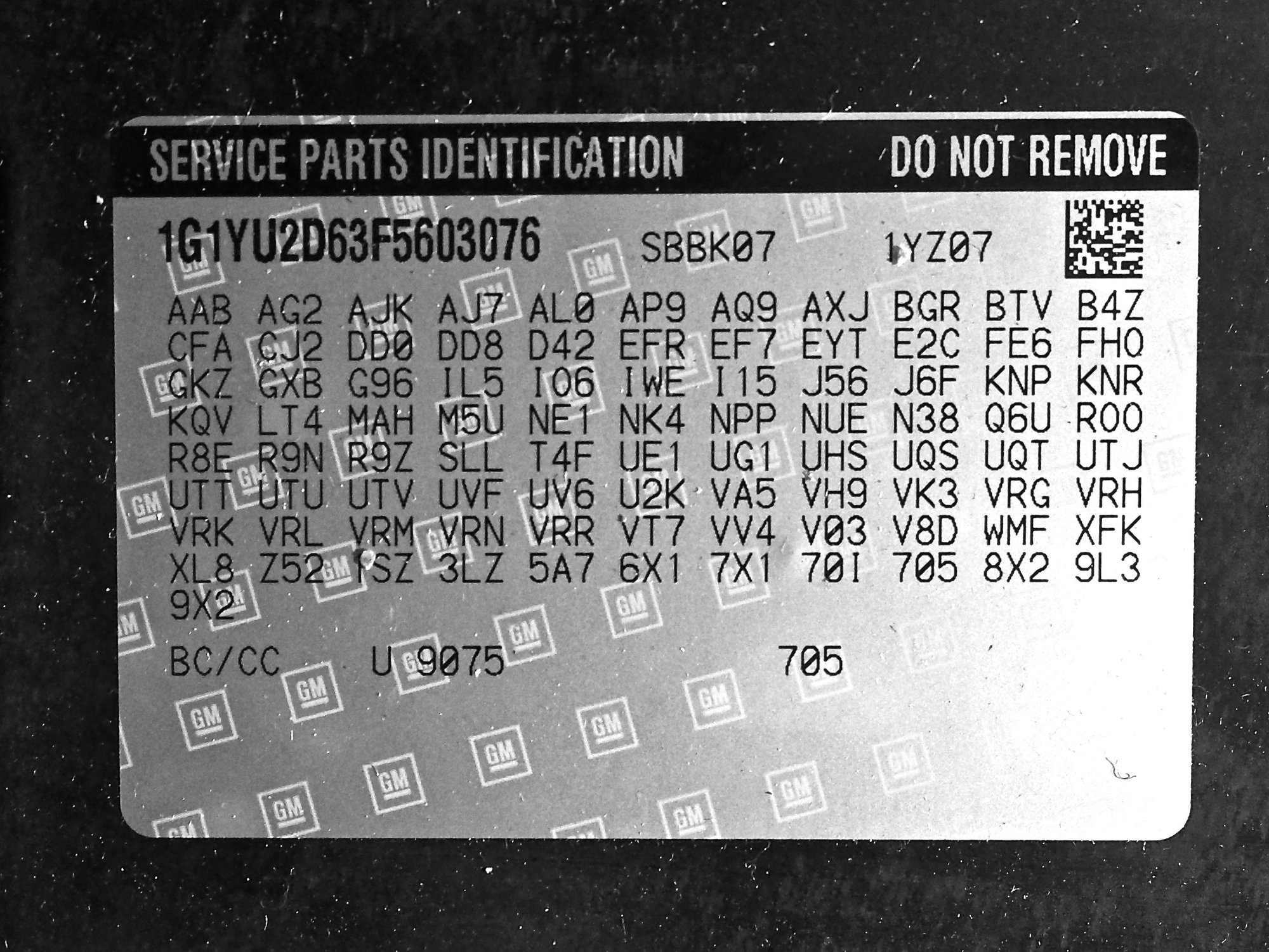

Would you check the list(that is on a sticker attached to your car, and not the window sticker) of RPO's that your car is equipped with and see if RPO Z52 is included?
I can't find that sticker. Where should it be?
Where? X2

Should be in your glove box. Either stuck to outside left edge or inside top! Can't remember
Rear compartment under the carpet, next to battery. (Was in glove box on the C6.)
On the C6 it was on the glovebox door, but I think they moved it on the C7.
I remember someone posting the location on the C7 but for the life of me, I can't remember where.
EDIT: Thanks CaryBob for the location of the RPO list.

In rear, under the carpet, next to battery. A complete list of all RPO codes is in the back pages of the Order Guide (downloadable from the sticky in the C7 forum.)
yes Z52
which is dry sump
Old Sep 15, 2015 | 11:41 PM
  #37
JoesC5's Avatar
JoesC5
Joined: Sep 1999
Posts: 41,732
Likes: 1,718
From: Springfield MO
yes Z52
which is dry sump
Now look at your PDI form, in the upper right hand corner and read the box labeled
"Special Inspection Items"
You will see where it says.....
" EXTERIOR-(RPO Z52) install the additional air deflector on the lower control arms. DO NOT install center lower air dam on vehicles with the Z52 option."
It's pretty clear that anyone with a C7 Z06(all of them are Z52's) that has the center air dam installed, shouldn't have, as the PDI was not performed correctly.
