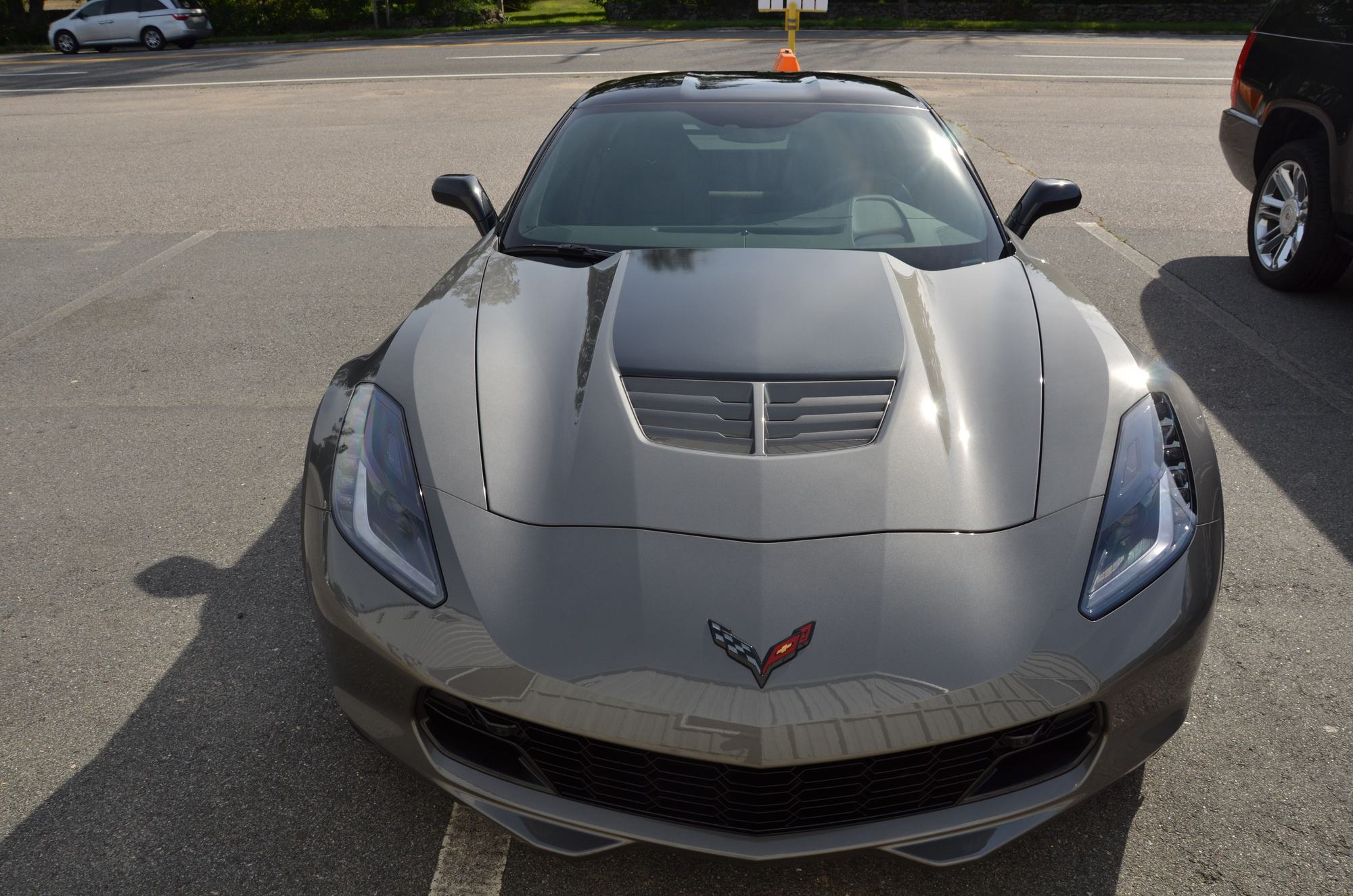

Mine says: Exterior - Rear spoiler, front splitter but I don't see a front splitter. Am I missing something? It does have the spoiler. Is the splitter and the lip 2 different parts?

I think all Z06s should come with at least the stage 1 splitter that is black plastic, not carbon fiber.
If it was there, you could not miss it... Dealer may have just failed to install it.
Yes, the black plastic splitter is a separate piece from the body color bumper..

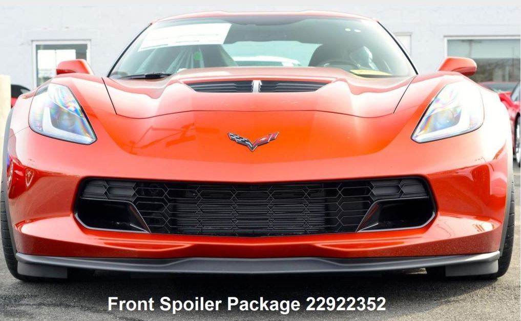

All Z06s come standard with the stage 1 front splitter, located under the front bumper fangs.

All Z06's come with a splitter, but only the base Z06 has the stage 1 splitter.
If the Z06 has the stage 2 aero option or the Z07 option, then it does not have a stage 1 splitter, as those two options have a completely different design splitter.

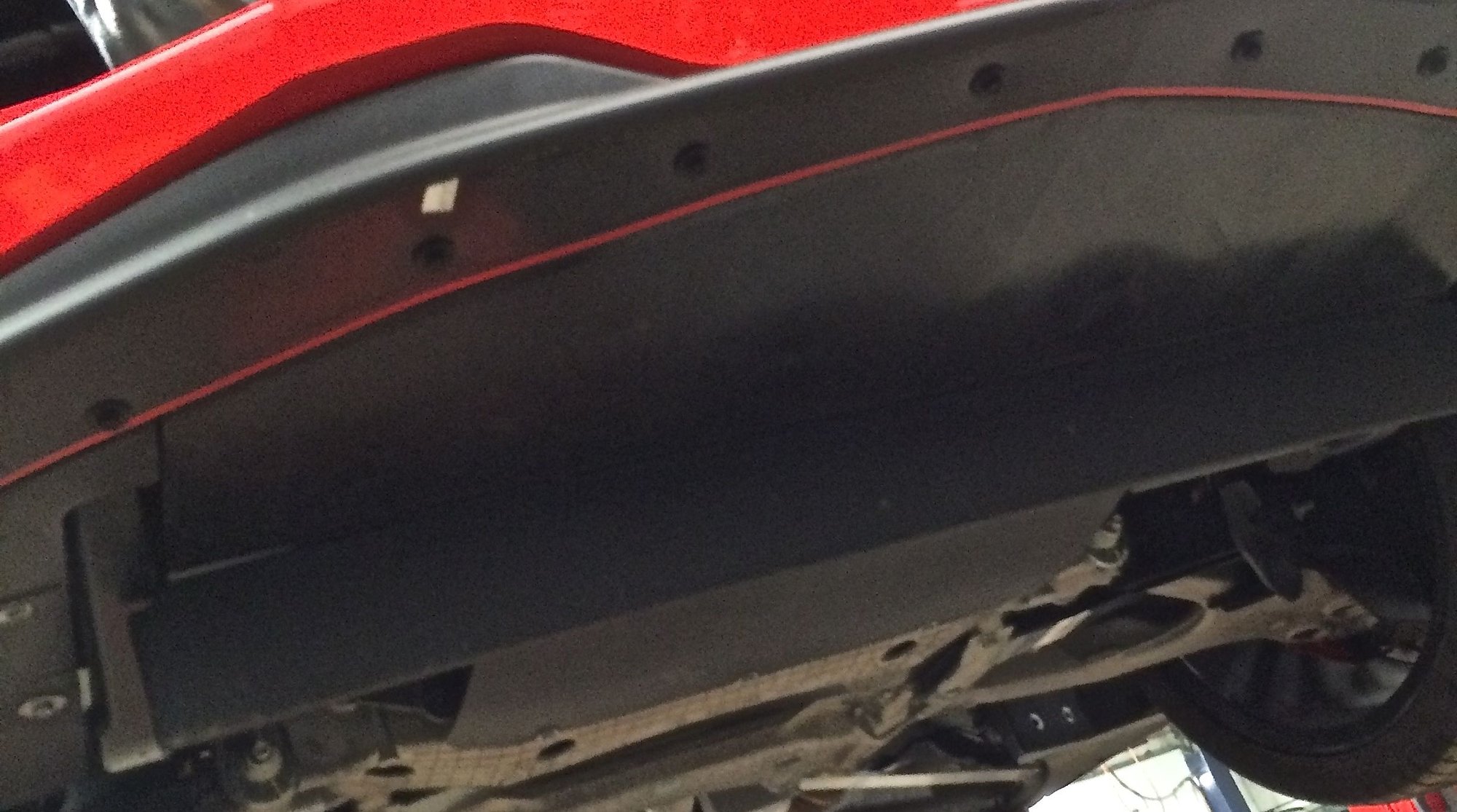

My stage 1 Z06 came with 3 air dams, 2 outer and 1 long center and yes those all mount to the frame. I see here on the forum that the stage 2 and3 aero packages don't get the center air dam, probably due to the aggressiveness of the front splitter .There were 2 other air deflectors that mount on the A frames too, seem to direct air to the rotors.
I know this because I helped with the installation of all these parts.
If you look closely to the right on the lower A frame you can see part of that air deflector, most of the deflector is on top of the lower A frame so you can't see it. Only pic I could find and its a bad pic....LOL...You can also see my center air dam

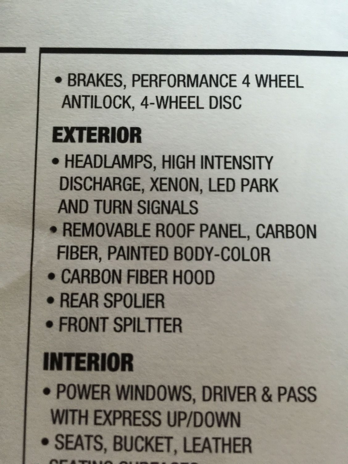

Thanks for the replies. I have contacted the dealer. This is what the window sticker had:
To Front Splitter

Now, if GM could just learn how to spell SPLITTER, and SPOILER

The reason I asked if you were sure is because Tuesday of last week, I watched a PDI being done on a stage 1 2016 Z06. I watched the tech that was doing the PDI open the rear hatch, unload the contents, spread them out in front of the car, and install them. I didn't see a center air dam.
Today, I had the opportunity to check 4 Z06's at my local dealer. 3 new 2016's that were delivered this week and a 2015 Z07 that belongs to a friend. The Z07 did not have the center air dam. Of the 3 2016's, 2 were stage 1 and the other was a stage 2. None of those 3 Z06's had a center air dam.
They all had the two small air dams that are located directly in front of the tires, and the two air deflectors that are mounted on the lower control arms.
On the Z51, the center air dam, that is found on the Stingray(without Z51) is not used as it would block the air that is needed to hit the face of the air deflectors that are mounted on the lower control arms. The Z06, no matter what stage, is the same.

This has come up in earlier threads, some stage 1 Z's came with center air dam and others didn't. Since it was in the hatch we put it on, I don't know what if any effect it has on my Z. My Z runs at 195 degrees on 90* days and in stop and go traffic in the same heat in NYC traffic my car rarely goes over 202*. That may be because I don't use a front plate.
Do you know why it's there?
My 2014 C7 Z51 didn't have the center air dam and the non Z51 did.
