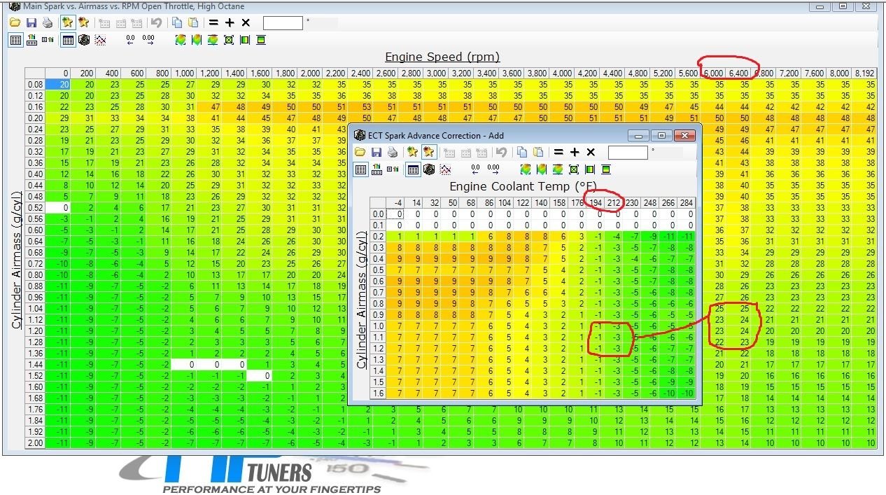

Hey guys, does anyone happen to know how much timing our cars are supposed to be running at WOT?
Ask and you shall receive! This is my car on the dyno which was running at 200 degrees and pulling timing at WOT:
Thanks.
Dumb question, but what does the cylinder air mass represent on the left? I notice that the timing number continues to go down. This is what I was watching during my run as well.
