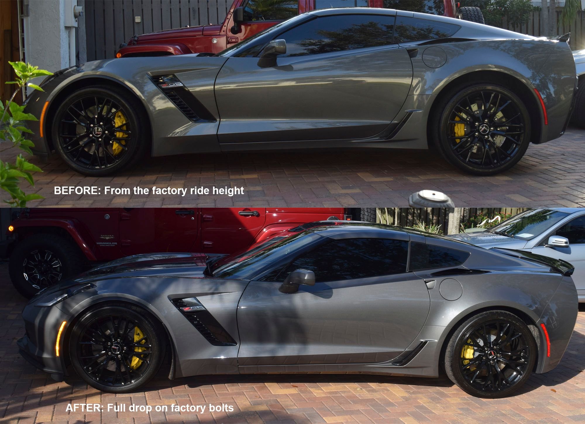

I thought I would share these before/after photos.
Ride height from the dealer was extremely high - you can see its a pretty dramatic change.
Took all of 45 minutes.

Looks great. 45 minutes. What's the secret?

Jack it up - take the pressure off the spring - turn the bolts counter clockwise all the way out.

Looks great. I also have SG. I did my drop in 35 min...lol.

I actually like it before the drop better.

non z07... thats why looks so dropped
what does it measure from ground to fenderlip all around?

You need after market rear bolts for the z07. They won't come down as much. Or you may be able to cut the grommet. I'll get some measurements later.

Not true. Ive lowered z07s locally including mine. Z07 will only go down to 28.25 rear ground to fenderlip Rear at most 1/2 inch stock bolts cut
My z07 with drop spindles 26.25 front and 27.25 rear ground to fenderlip

OK I was under the impression with aftermarket rear bolts for the Z07 package you were still getting 1" to 2" on the Z07 - I think I saw of yours with the drop spindles somewhere.
REAR from the ground to the top of the lip just about c hair under 28"
FRONT from the ground to the lower lip of the spat 26.75
